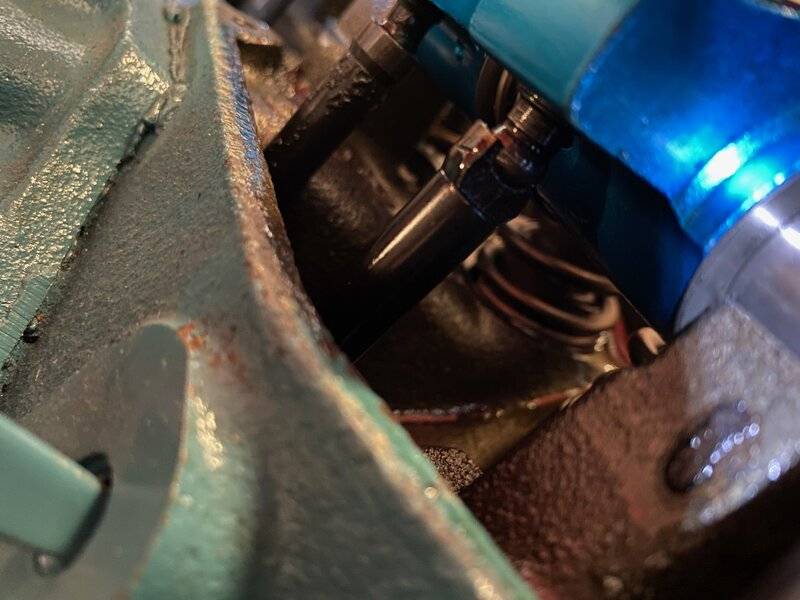

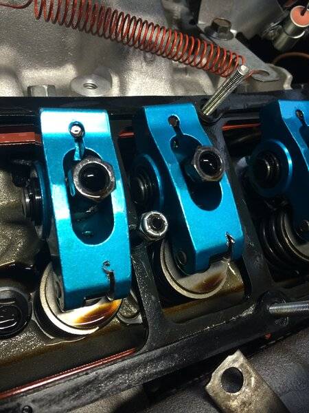

Did you retain the stock cam and original lifters? I ask because on my 66 361 the original lifters have a smaller cup in them. The stock pushrods are actually tapered at the bottom. If you use late model pushrods they may not fully seat.
From the wear, it looks like the ball is possibly bigger than the cup.
Good Questions. New Cam, New Lifters, New Rockers. All supposed to match. We will pull the rockers to be certain all is well with all of them and see what is next. Best, B.Did you retain the stock cam and original lifters? I ask because on my 66 361 the original lifters have a smaller cup in them. The stock pushrods are actually tapered at the bottom. If you use late model pushrods they may not fully seat.

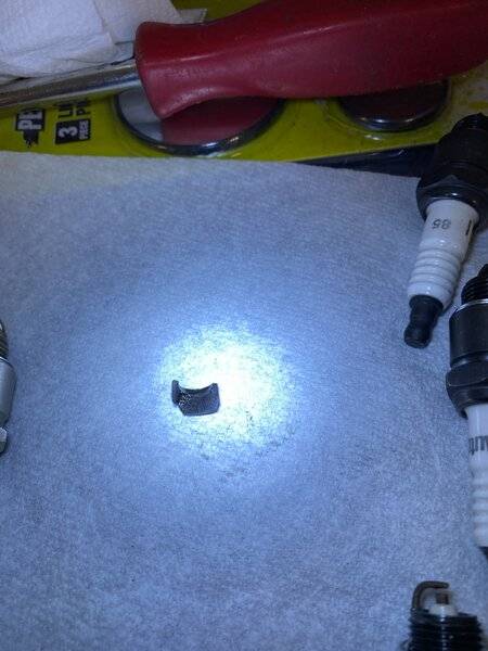

R, thanks for the Coaching. FORTUNATELY, it popped in two pieces both of which fit perfectly to complete the cup. To be certain, we will drop the oil and have a look at the Oil Plug that is magnetic. Best, B.Sorry to see this. Please remove the intake to make sure there are no more pieces in there. Unless you can put the puzzle together and. Are sure they are all out.

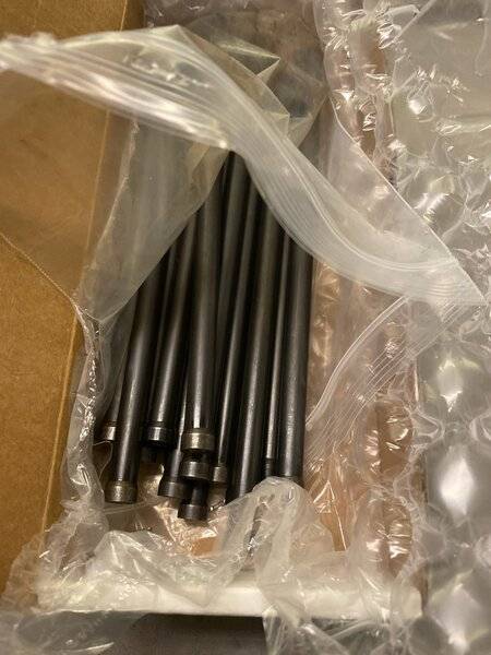

RGAZ, these are meant to be a "Matched Set". Checked that again with the Proform to be certain we have the correct push rods. They say, we do given the Rockers we have. So, unless one was incorrectly machined, they ought to fit. A new set of Push Rods are on the way, supplied by Proform, and we will pull all of the rockers and the old push rods to inspect under magnifying glass the balls AND the other push rods. We will know a lot more when we get the valve train out. Fingers Crossed. Guys, I really appreciate your coaching. I will keep you abreast of the progress. Important to note, Proform did/is sending new push rods on their dime. So, they are trying to make it right. Fingers crossed. Best, BrianOh yeah, look at that! I bet the ball is probably bigger than the cup. If so, and they are all the same as this one, this will not be the only one to frag. They will not last long.

440, Thanks for your note. We agree. When one looks at it very closely, it frankly looks like this one "was over headed" and rather crystalized. I have a buddy that is an Engineer for Cummins, engine build side of the business. His observation is that this one (or likely more) were overheated when they were "heat treated". That made it brittle. What others have suggested about the Ball being too big, we will see. When we did get the Rockers and the push rods, the engine builder "de burred" all of the parts before we assembled them on the engine. So, we have had a look at them once. We will bring out the Magnifying Glass now for each rocker and each push rod. In short, we will know a lot more when we get them all out. The engine builder has done some high dollar engines. His stable mate does the Long Distance racing, 6 or 12 hours. He is also a good buddy and knows me and our situation well. His first engine build just out of high school was a 383 in a 69 or 70 Road Runner. So, we will see what the parts tell us. best to you all, BrianThe pushrod cup insert failed (fractured). That type of failure can be attributed to material or machining process. 440'
Hemi, we have not yet installed the rockers. We did measure the push rods and all are correct length. We did measure the PR length before ordering. We will see how they fit when installed. Now we know more of what to look for. Thanks, B.Sum-ting-wong,,,,,did you check the geometry when you installed new pushrods? Did you measure the PR length before ordering them??

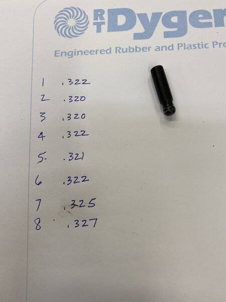

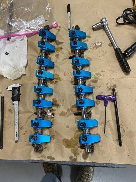

So dumb question from my end: Are the balls on the studs hardened? Can they safely be machined down and still work? (In some cases, only the surface of the material is hardened, like my stock rockers.)Dr. K, the engine builder machined them down to size (0.305) and they are ready to re install. So, what could have happened? The engine builder has a set of Ford FE Comp Cam Rockers at the shop. The balls on the studs for the Comp Cam FE are .... 0.328. Hmmmm. So, anyway, we now have 16 push rods that are 0.308 on the inside of the cups and we now have the balls on the Rocker Studs at 0.305. In short, they will seat down in the cup. What did I miss? Best, Brian
The only dumb question is one not asked....So dumb question from my end: Are the balls on the studs hardened? Can they safely be machined down and still work? (In some cases, only the surface of the material is hardened, like my stock rockers.)
