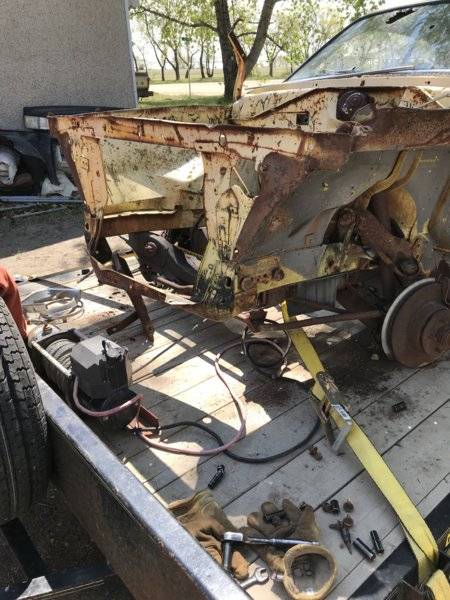

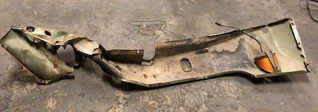

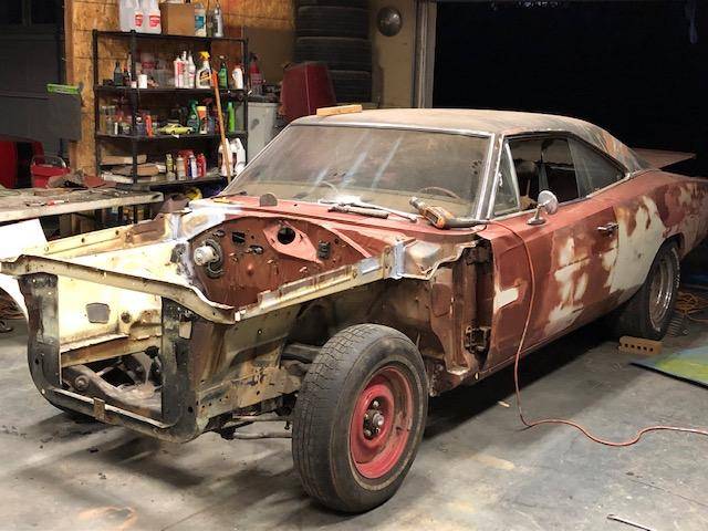

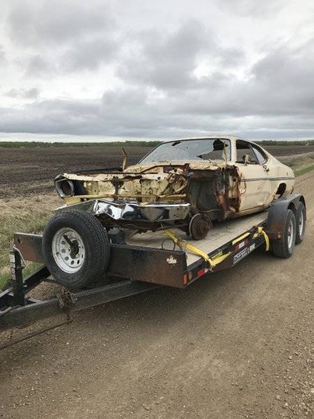

Lookie what $5000 buys you....

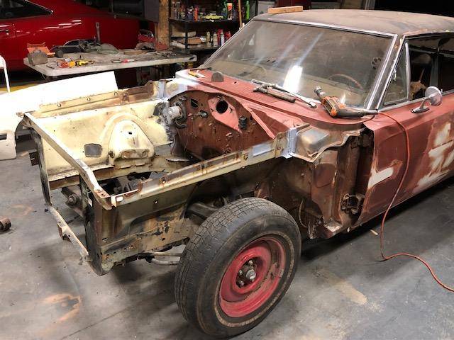

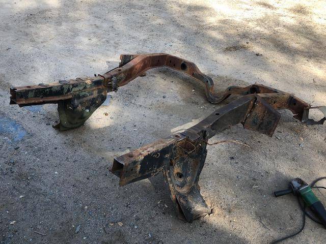

I dragged down the frame rails and torsion bar crossmember I saved from a '68 Satellite.
View attachment 866989 View attachment 866990

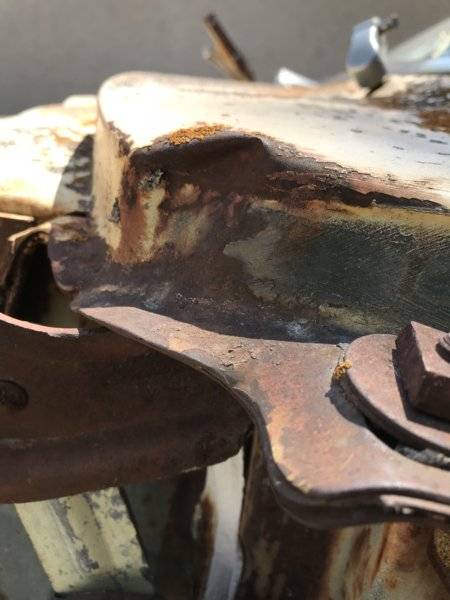

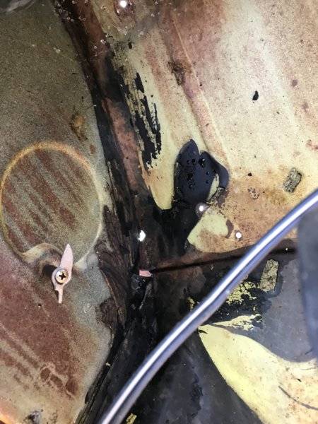

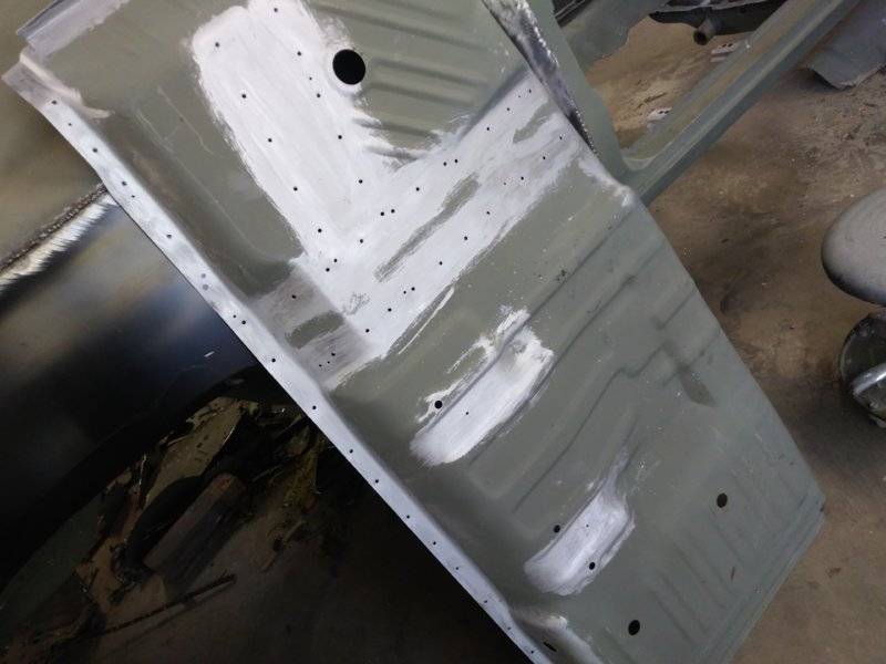

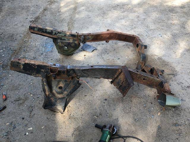

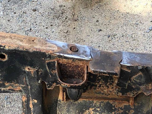

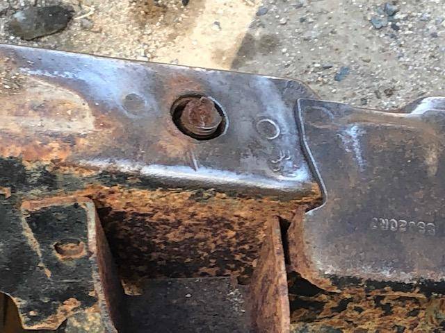

I then realized that the RH rail must have had a stubborn K member bolt....I don't remember cutting it off.
View attachment 866991 View attachment 866992
I soaked it in PB blaster:
But even after I drilled through it, I started thinking that it might come out easier if I welded another fat bolt on it and cranked it out.
Anyone else have an idea on how to extract this thing?
Weld a flat washer to the broken bolt first then weld a nut onto the washer
Nice job by the way!

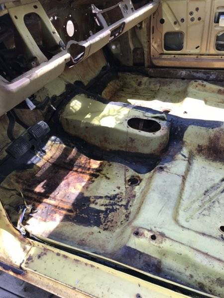

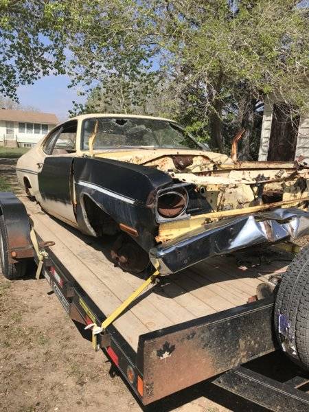

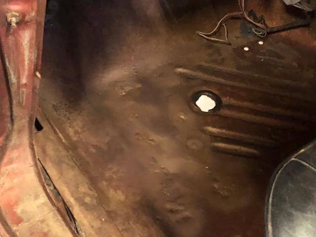

I picked up a 70 340 4 speed Duster that I’m planning to do the same fix on.
It was a hard enough hit that I need to replace the floor pan, possibly the torsion crossmember too as it pushed the floor up a bit. Door pillar may be tweaked a bit as well.

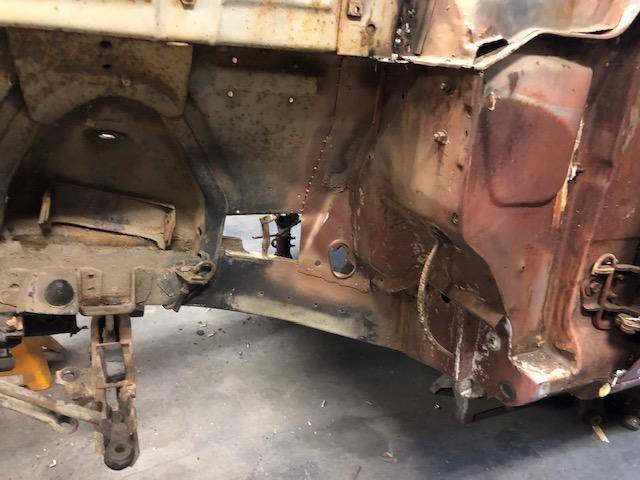

I will have to check that out. I'm going to replace the center of the trunk floor and may replicate the spotwelds with proper plug welds.

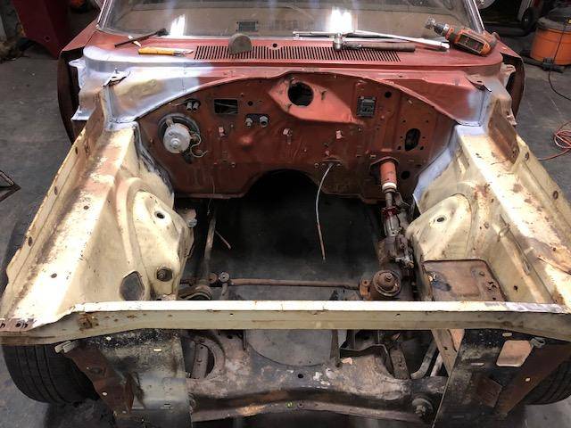

The fender aprons are welded up. I plug welded through the floor pan to the rails too.
I sprayed the welds with the weld through primer since I don't plan to use this stuff again. Might as well use it up here.
It is probably redundant but I added a few more tack welds along the edge along with plug welding.
Next up, I'll hang the fenders, hood and front bumper & grille assembly. I also hope to get the front suspension back together so I can put it back on it's tires. I want to put the car on the lift so I can weld the rails to the crossmember while standing, not laying on my side.

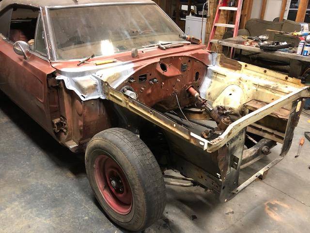

Ta-DA !!!

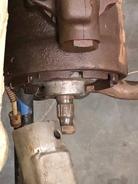

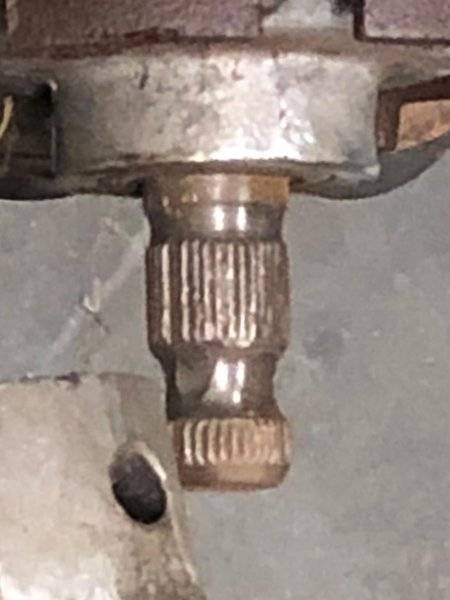

Almost all the welding is done. The suspension and steering are back in. Check out the conditions of the splines on this one:
The years of sitting uncovered ate away at the splines. I will have to use another steering box once the car is made roadworthy.
Torsion bars are in but with no boots. All of this stuff will get pulled apart later to be done right. For now I want to be able to roll and steer it.
I hoped to get the front body panels on today but I had to do other things here at home. Maybe this week?
Thanks for following along. I'm having some fun here!

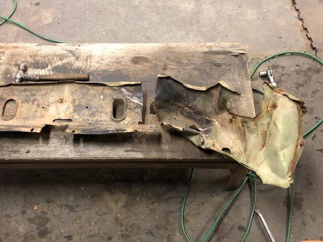

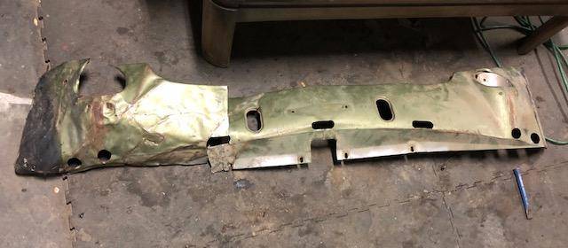

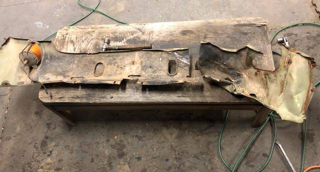

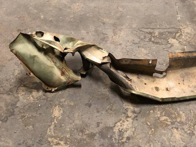

It may be a waste of time but I decided to see if I can repair this valance:
It was corkscrewed and trying to twist it back seemed to cause distortion to the good side....SO I cut it.
At that point is was easier to hammer away and start to rough it back into shape.
Still a long way to go but I think I might be able to actually save it.
