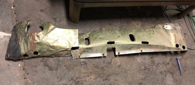

Back in post #294, I showed a picture of THIS valance:

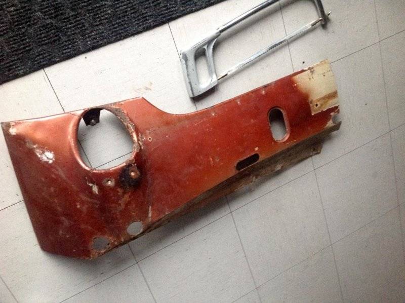

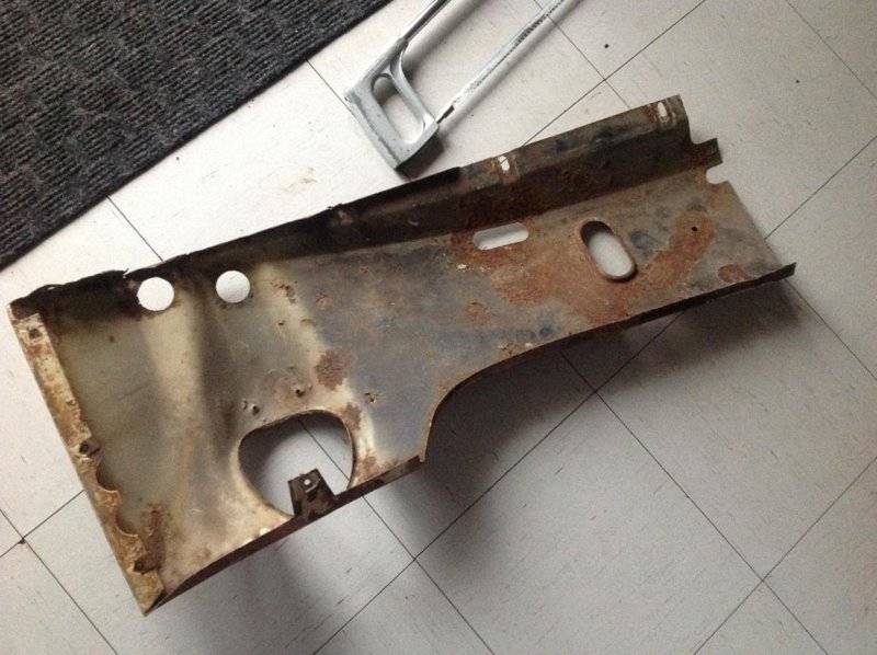

I had planned on banging away at the mangled corner to see if I could get it straight. I posted about this on a couple of other sites and on the 1970 Charger Registry site, a guy from Canada offered to ship me this:

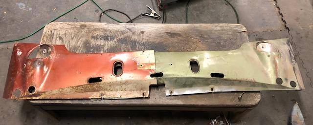

He had a couple that were only damaged on one side much like mine is. The plan now is to weld these two halves together right down the center. I am quite happy to have the chance to save this valance since it looked to be a lost cause.

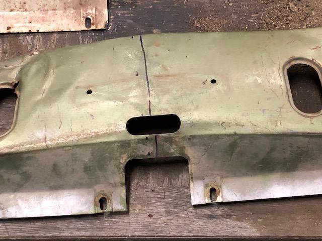

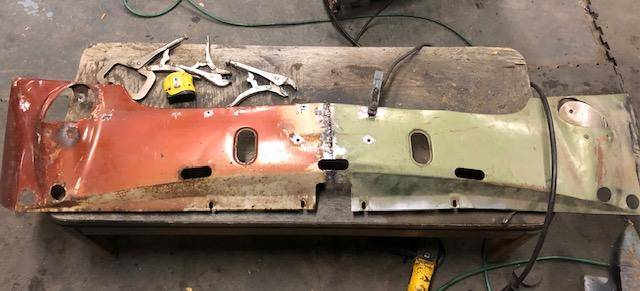

First, I laid the orange half onto the green half and scribed a line.

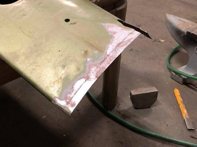

I then cut the green valance 1/2" past the solid black line to allow for a recess flange. I had first planned to just do a butt weld but I figured the overlapping flange would make this easier.

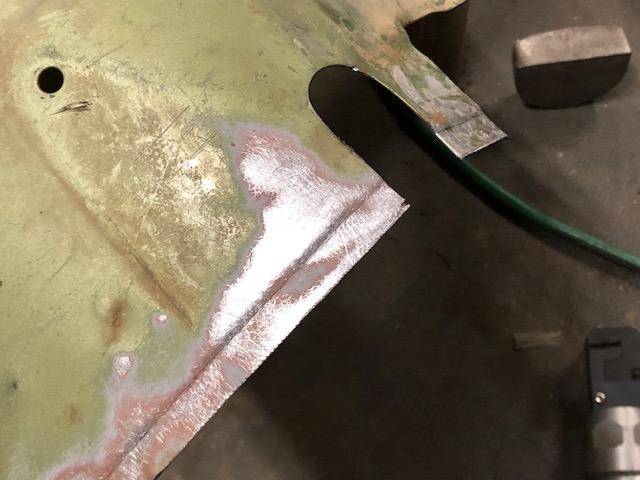

It is a good thing that I had the flange. I made a mistake in my measuring. The orange panel was supposed to rest on the full 1/2" of the recess but after checking against another valance, I needed to widen it all and ended up only overlapping by 3/16" to 1/4". If I had cut the green valance on the line, I'd be about 1/4" too narrow. I don't know if that would be noticeable since it would only pull in the bottoms of the fenders 1/8" each side. Regardless....I started tack welding the two halves together.
I am stitch welding even with the flange joint. A few more zaps and I'll grind and prime. There are a few other holes to weld up and a few other small repairs to do to it. I'm just happy that Fred from 1970ChargerRegistry.com was kind enough to GIVE me the orange half for just the cost of shipping.

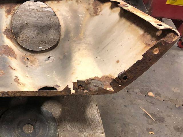

The orange side will need some additional repair:
I'm going to cut off the rusted sections and patch in some fresh metal.

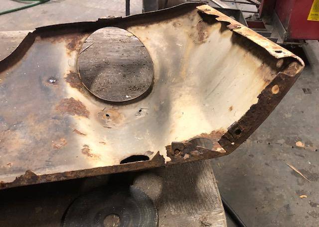

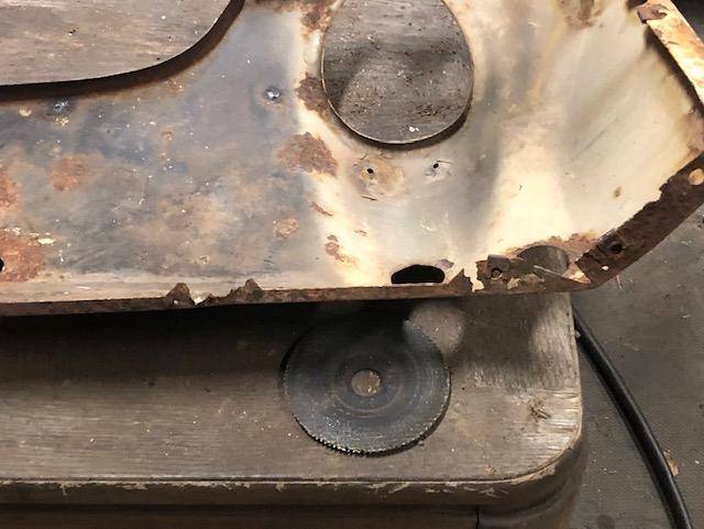

I did a quickie fix on the bottom edge flange where it is rusted here:
Sorry, no picture of the repair. In short, I laid a strip of 14ga metal behind the rusty section and welded it in.

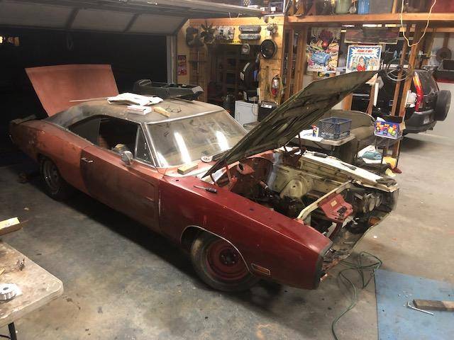

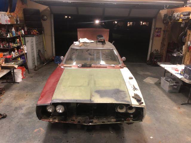

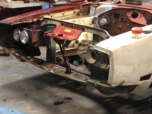

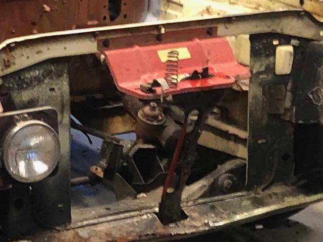

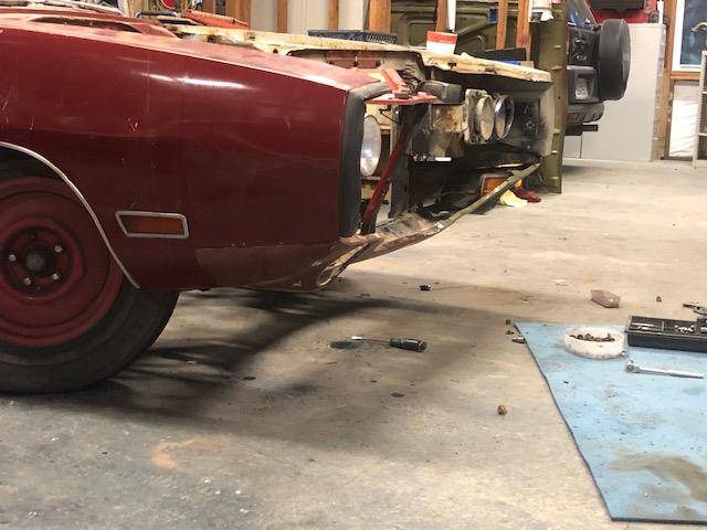

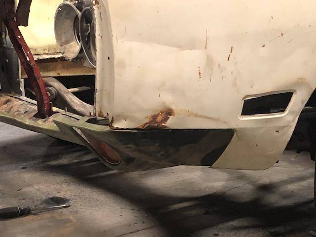

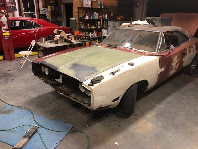

Valance is in place. It fits nice on the right side but the left side will need work. The left fender is in need of a fair amount of hammer and dolly work.
Remember, the front stub in the car now is from a 1970 Belvedere. I figured that I'd possibly run into some problems with the mounting of Charger specific panels but the valance bolted to the lower radiator guard just fine. The hood latch support bolted right in too.
