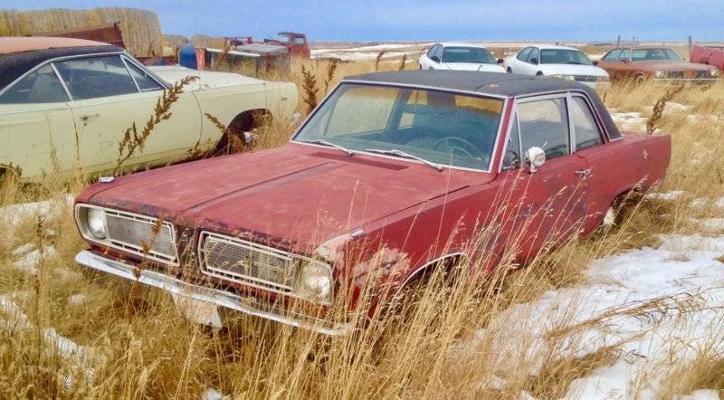

Lookie what $5000 buys you....

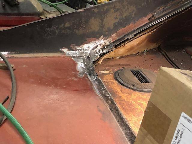

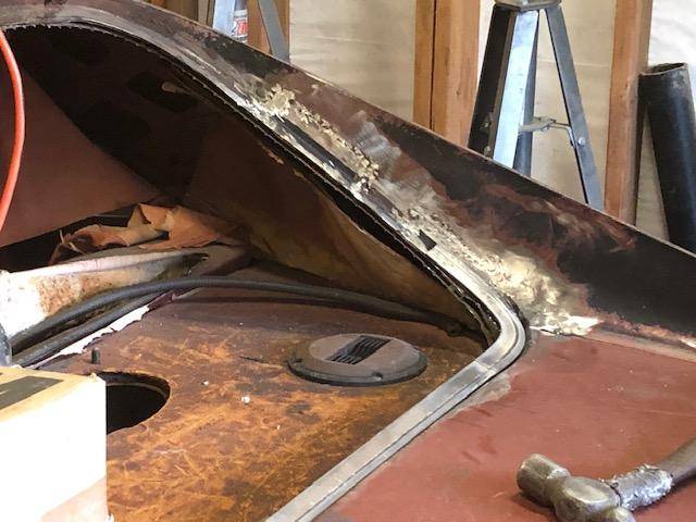

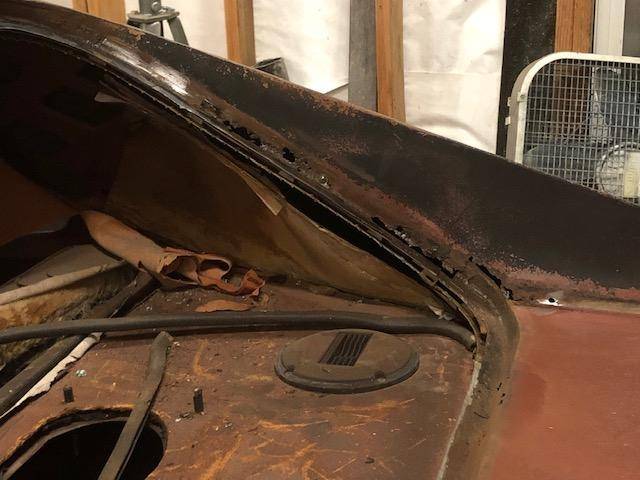

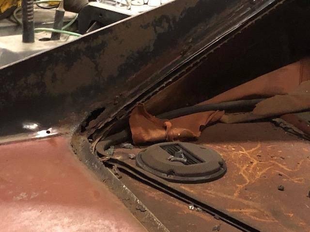

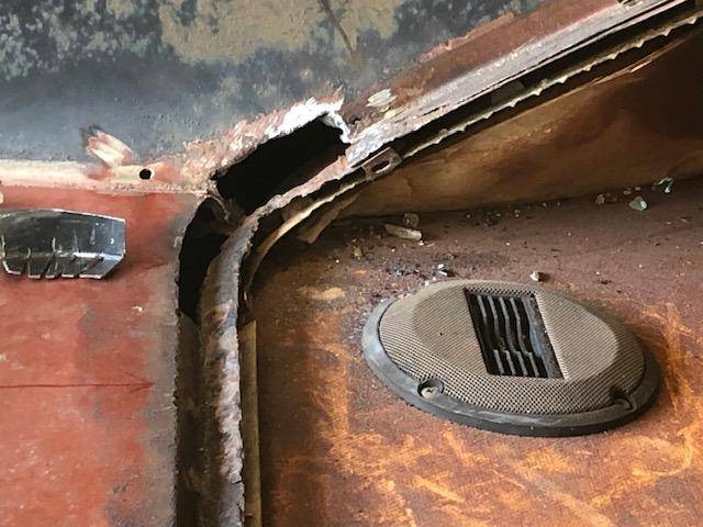

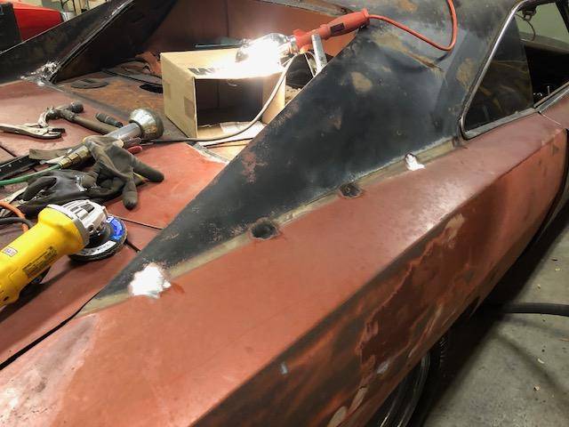

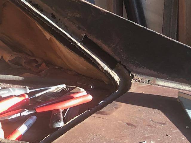

Its a tedious process to be sure, I had to repair the package tray and sail panels on my RR. looked like someone stored carpet in the trunk and rusted it all out. Still have to do the trunk gutters...

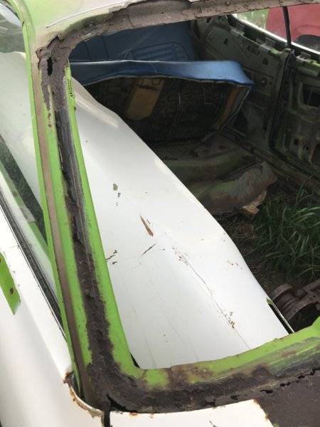

It is the vinyl top, man...I really hate what they do to these cars. They trap condensation, get rotten, crack, allow water to get in and then the rust begins. Once the rear window allows water through, the trunk rusts out.

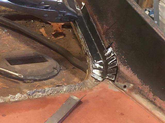

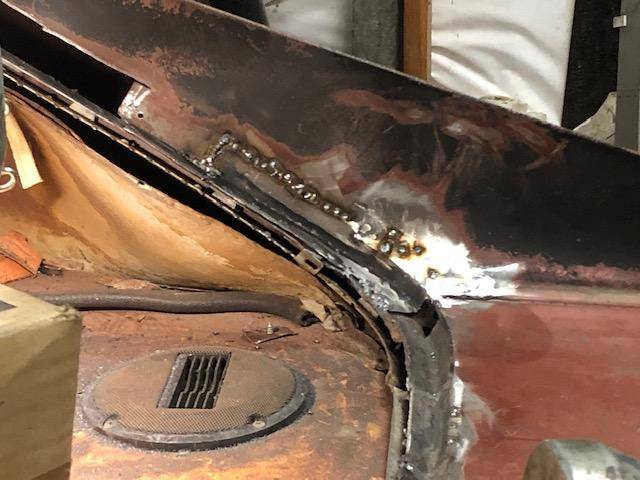

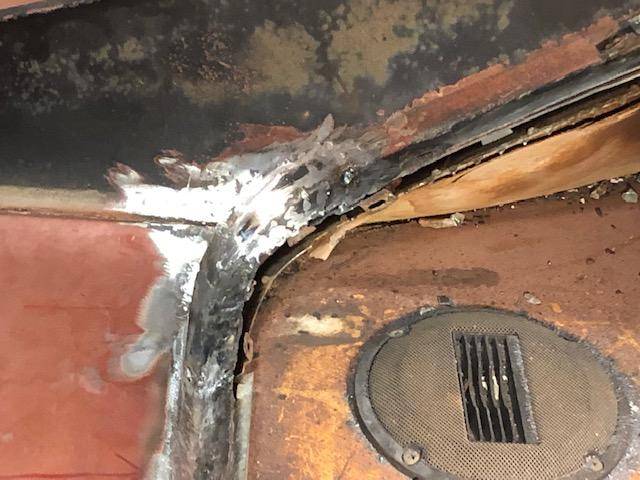

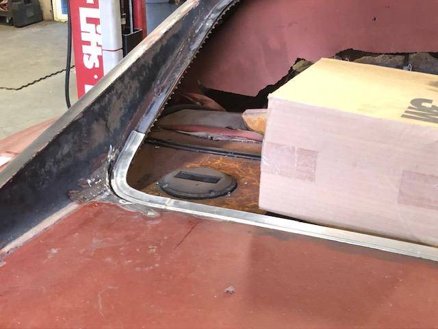

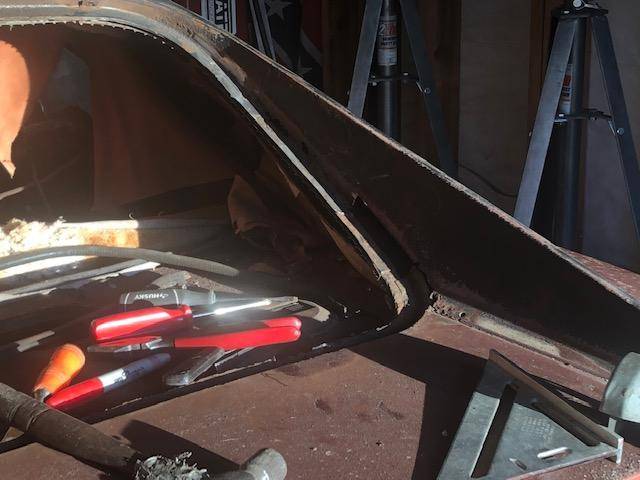

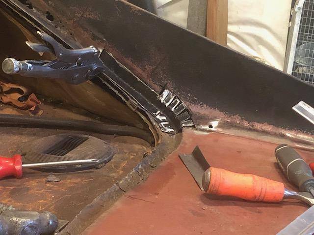

I started making patches for the right side.
View attachment 916148 View attachment 916149

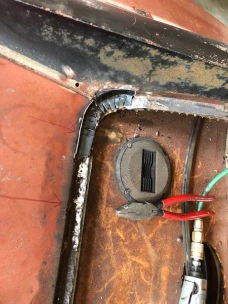

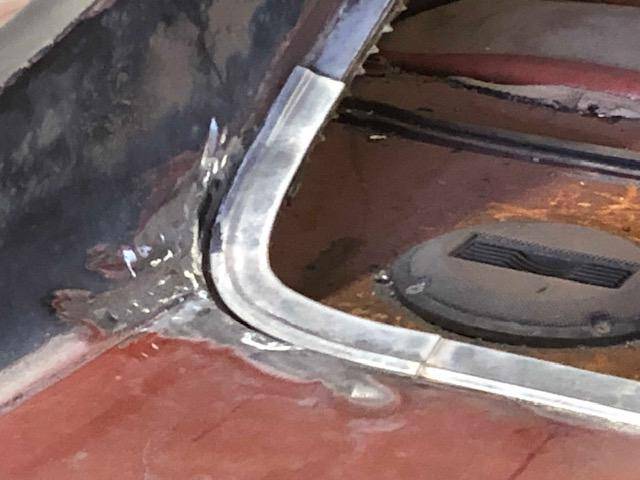

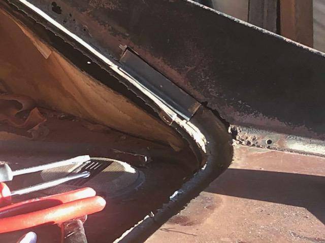

The bottom flange was too narrow for my liking so I made another patch.
This one extends down past the corner. It also wraps out of the channel and into the buttress/sail panel.
The metal in this patch is slightly thicker than the car's sheet metal or maybe it just feels that way because it is new.
The edges had to be sliced to allow me to bend and conform to the desired shape.
I don't claim to be an expert on this. I've patched lower quarters, floors, taillight panels and such but these compound curves are new to me.

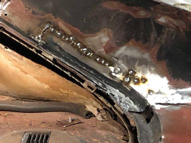

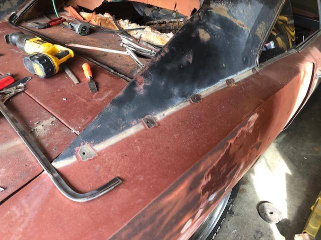

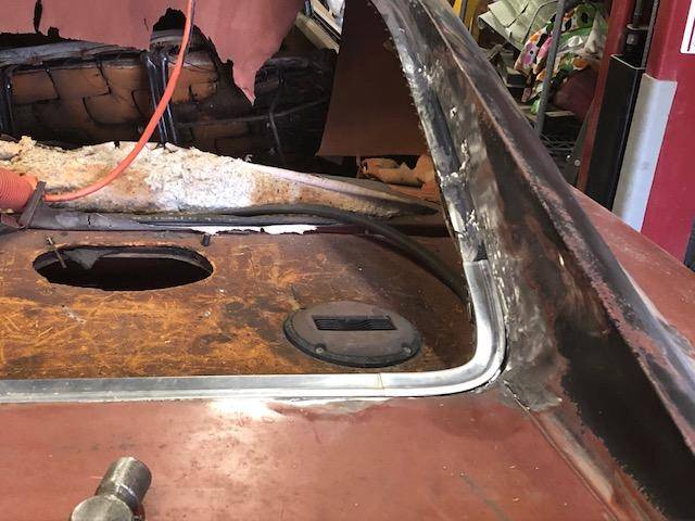

I've been using the glass trim to make sure that I'm close to the right shape with my patchwork.
Almost done. Just a couple more hours of welding and grinding. I'm going to need some new clips for the trim and of course, a window. I plan to epoxy prime the channel, level it out with some filler and high build primer and then seal it.

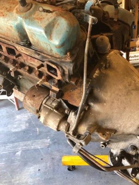

I think that I am done welding for awhile. The next welding project would be the trunk floor and I won't have that until April. Ahhh...What do I do next ?
I could take the heads off of the 383 and see what the pistons look like, maybe see if the engine needs a valve job or rings. If so, maybe I'd set the engine aside and use a '71 440 that I have from a Chrysler 300 that I parted out 8-10 years ago. Not sure yet. A re-ring and bearing job on the 383 could be done cheap. Add in a new cam & lifters for either engine. I'd need an aftermarket 4 barrel intake for either engine. The 383 is the original engine to this car, that is one factor to consider.

Looking underneath at the steel under the package tray on both of my cars, there are multiple openings that the factory put in. The package tray structure in this car has not been modified. Those small speakers are sitting in original holes in the steel.
