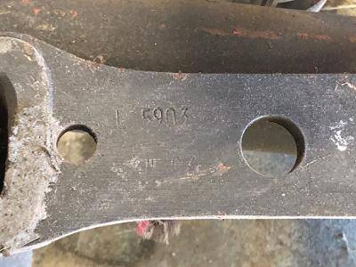

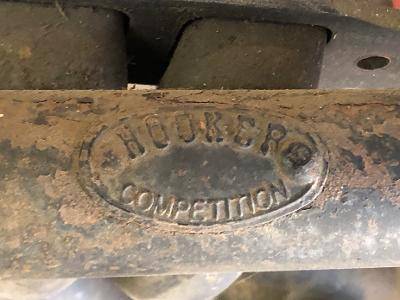

I could bolt up another 727 and slip the engine and trans in place. This would allow me the ability to get the exhaust system in place. The headers I have are Hooker #5903.
View attachment 1029838 View attachment 1029839
I put Fast Ratio Pitman and Idler arms in so there might be some interference issues. I intend to modify the headers for clearance if possible. I can then pull them back out to sand and paint them with High temp VHT paint. With the engine in place, I can run the wiring, the fuel system, put in the radiator and hoses, etc. Once I get the transmission out of the other car, I can just do a transmission swap in this one and put in all the remaining stuff. Stay tuned,

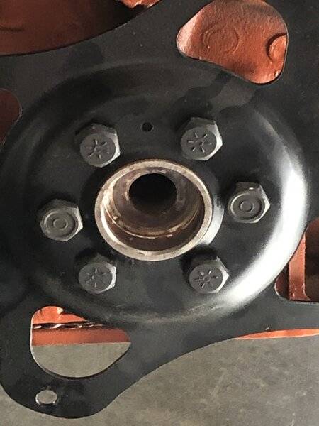

On the flex plate to torque converter alignment...I never thought to look at the manual for a tip. I just put the flex plate on the torque converter and spray each bolt area with a different color paint...making sure to hit the flex plate and the torque converter. That way when I join them together I just spin the converter until I get a color match. Could do the same with using a sharpie and numbering but the paint method doesn't take any searching for the number....as long as you aren't color blind.
A great idea!!! :thumbsup:
I loved it when they did the drain plugs on the converters. Made for a more complete service.

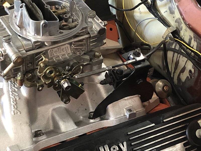

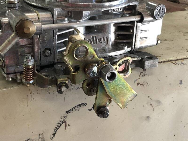

I had a few different carburetors that I could have used. The Performer RPM is a square bore pattern though so the freshly rebuilt Thermoquad won't fit. I have a fresh Holley 600 and a 383 spec Carter AVS too. I chose the Holley for now. I have a 750 VS in my 360 Dart so I may step up to that after I am up and running. I have a Holley 600 in the 75 Power Wagon with a 440. Some may think that the 600 is too small. The 440 Magnum came with a 580 cfm Carter so it isn't like I am choking it off.
Holleys come with a Chevy throttle arm so to get the right geometry for Mopars, part # 20-7 throttle bracket is needed.

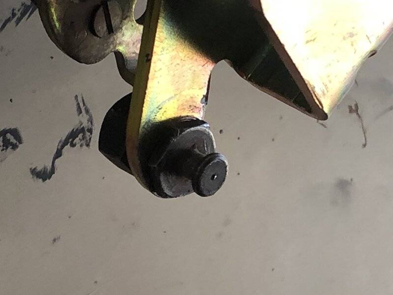

Since I am reusing the Bouchillon cable kickdown kit, I needed to attach the stub at the bottom to pull the cable.

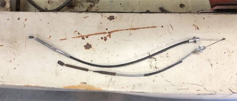

I found out several years ago that an A body V8 throttle cable is a great fit for the B body with a taller intake.
I didn't measure them but by eyeballin it, the A body cable is about 4 inches longer

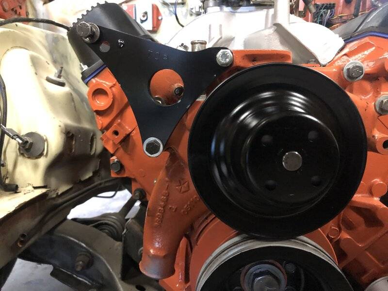

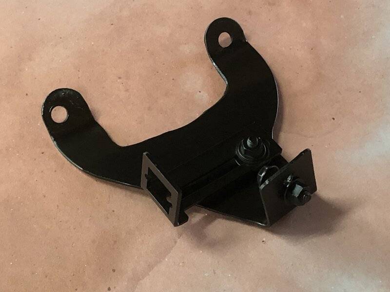

The red car, Ginger, has a throttle bracket that attaches to the intake near the carburetor base. I didn't feel like ordering one for this car. I went to the shed and looked around, then found a bracket from a van or motorhome.
I had to grind and shape it a bit to clear the intake runners.

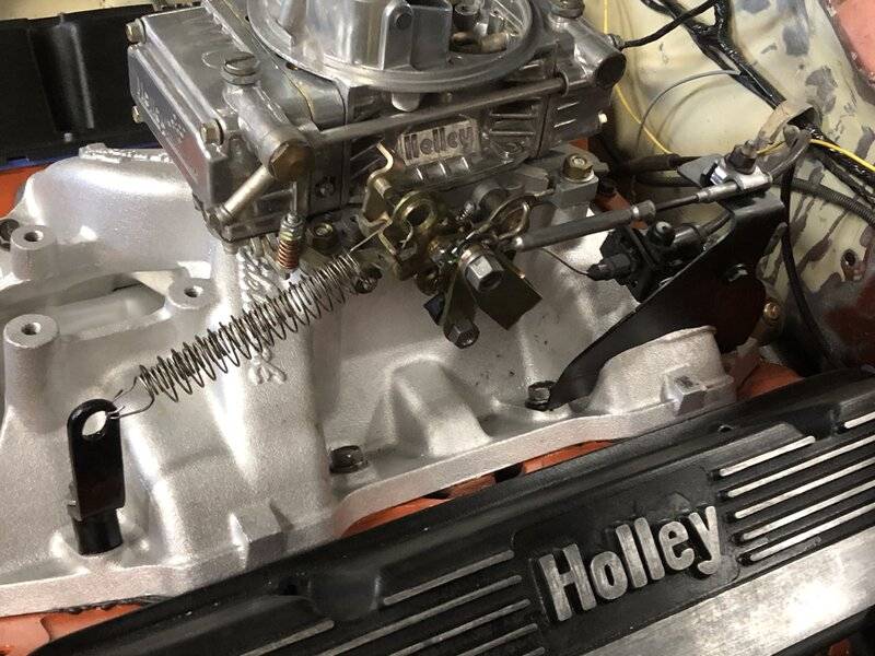

I found another bracket and modified it to use for the throttle return springs.

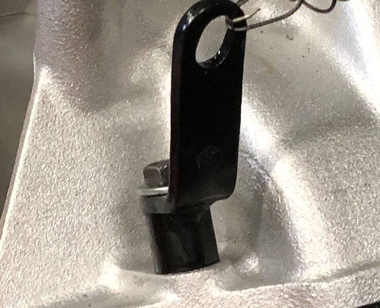

Throttle bracket has the transmission kickdown cable bracket attached to the backside.
Now with the return springs in place:

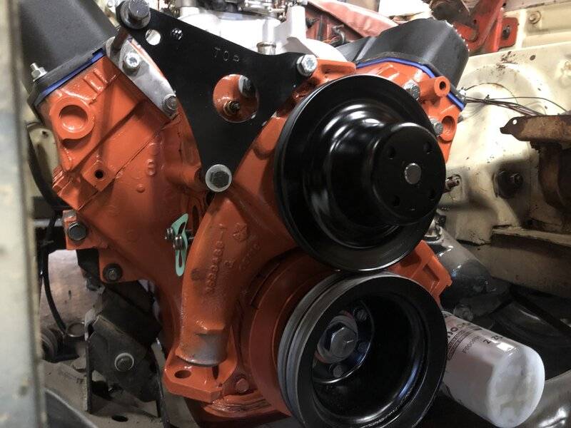

Water pump and housing are on, the pulleys are painted and ready.
I didn't paint inside the grooves, obviously.

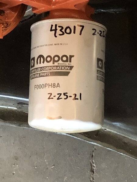

Awhile back, I got a bunch of these Mopar oil filters. Being white, I'm able to use a Sharpie pen to write the date and mileage on them.
Funny thing....The mileage is 43017. The speedometer/odometer is from the original instrument panel from THIS car...
I changed to Dakota Digital gauges in 2015 and even now, Ginger only reads 43511.
That is really sad...I haven't even driven that car 500 miles in 5 years!

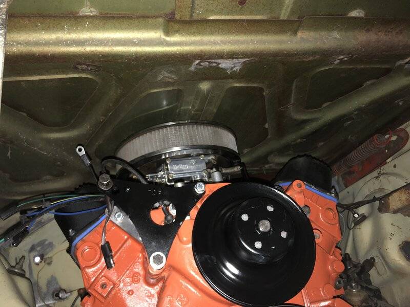

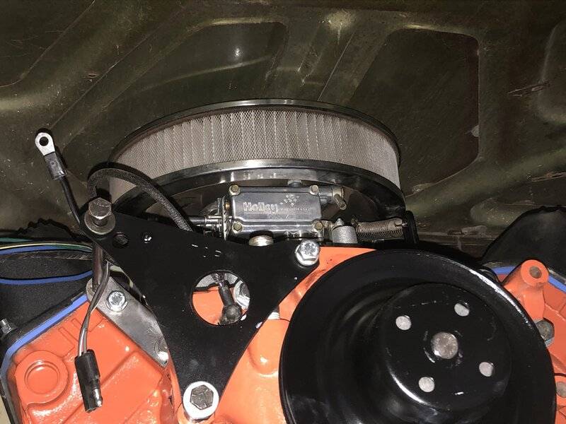

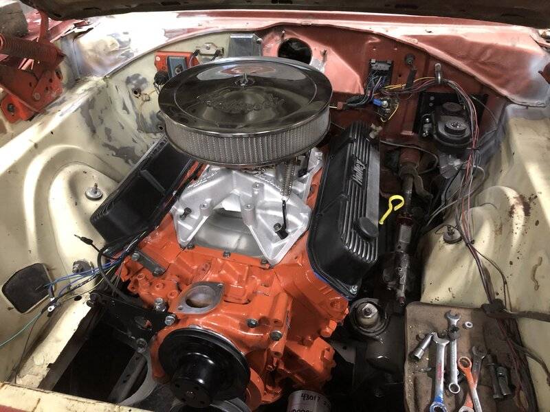

The air cleaner seems to fit.
That must be because of the LOW deck of the 383.
I am using the Performer RPM on both cars and on Ginger, I had to have a dropped base made for the air cleaner to clear.
