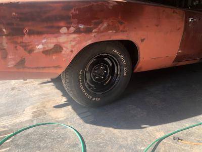

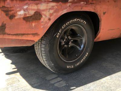

Thanks, Pete. That is exactly what I did!

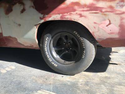

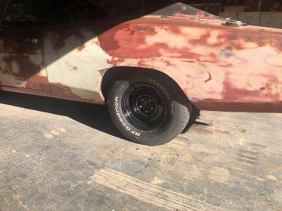

I'm going to brag a bit and say that the steel wheels look a whole lot better than those aluminum ones!
The car still looks like a turd but it is MY turd!

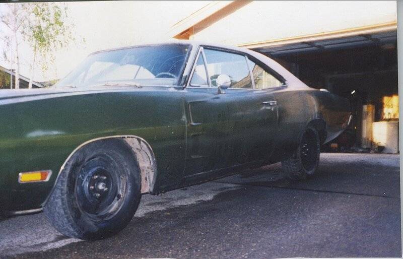

I know that many members here have beautiful cars and don't care to ride around in a car that looks as bad as this one does. For some reason, I sort of enjoy the freedom that a ratty, fast car gives you. When my red car was green and all crappy looking, I got all sorts of people waving, giving me the Thumbs Up and coming up to me to talk about it. Beater cars are a great conversation starter because they are far more affordable than a finished one.

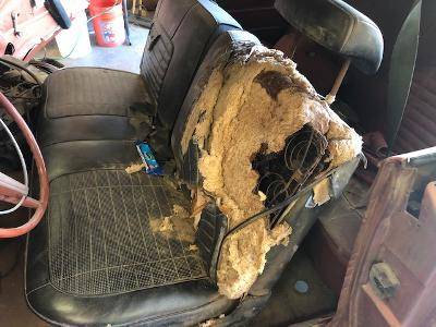

The front seat though....

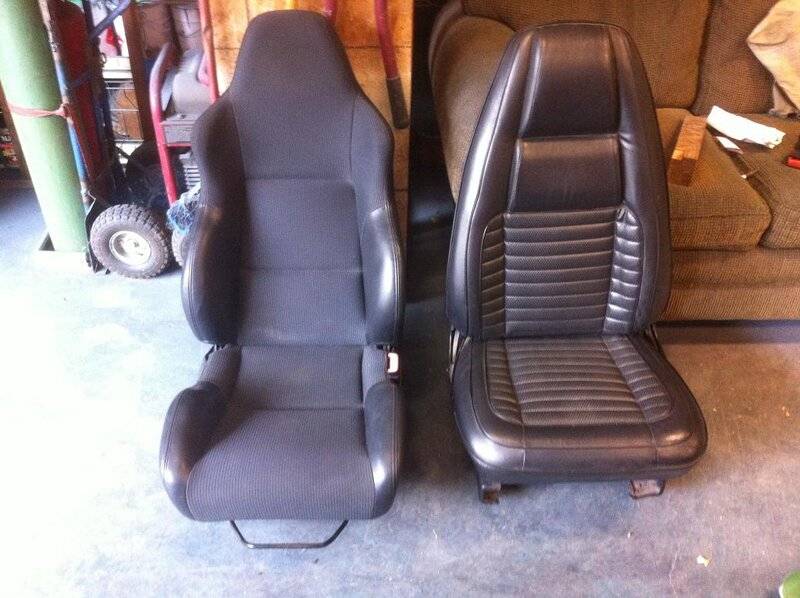

I am so tempted to just bolt in the original bucket seats that I took out of my red car:
(The one on the RIGHT)

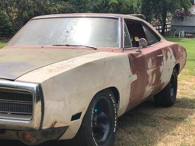

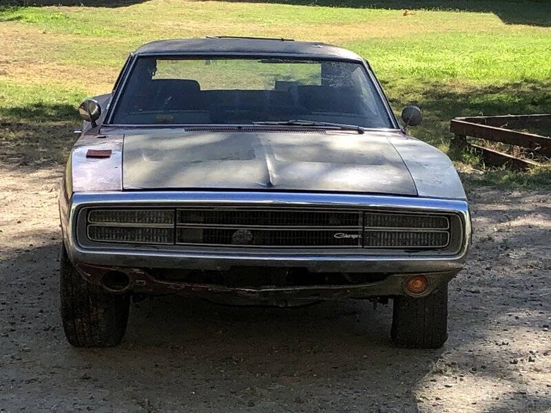

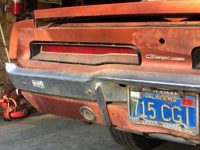

The sale included a nice grille and front bumper and an 8 3/4" axle without a 3rd member or brakes. I got a nice hood, fair fenders and a beat up valance panel.
The car still sits at my buddy's place until he can clear a path to get it out. He has 2 non running cars blocking the way out of his yard. Once I get it home, I'll need to inventory what is there and what I'll need. I might use some "Hand-me-downs" from my red car...That is a good excuse to make upgrades to the car I'm keeping, right?
