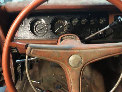

Now the tach works along with the speedometer and gas gauge. The water temp and oil pressure gauges are dead. I have 2 other clusters that I can try. As I mentioned before, the faces of them are heavily faded but if I can get those vinyl overlays, it would buy me some time until I restore the panel.
This is the original gauge panel....

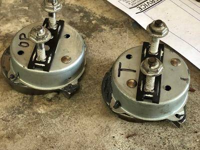

Today I rigged up a few wires and batteries....

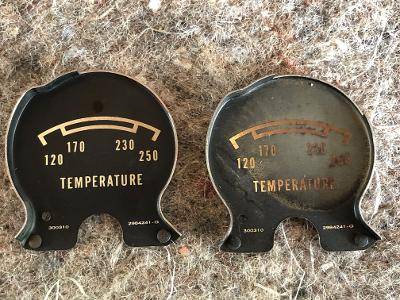

Then tested the gauges individually. The fuel, water and oil gauges...they all worked in both of these clusters BUT the faces are heavily faded.
The faces of the gauges in this car now look better. Not new but still better...
The faces of these gauges is held to the housings with small rivets. They are not visible once the clear plastic and the black plastic trim is on. I'm thinking of removing the faces from both the good and bad gauges and using some type of JB weld or small bolts and nuts to hold the good faces to the good gauges.
This small rivet could be drilled out or ground down with a Dremel tool.
I always wondered if that was some sort of brownish funk that accumulates on the white lettering,
something that could be carefully cleaned - or if the silkscreened/printed white lettering ink itself
had discolored forever?
I just thought it was faded water based paint. I might try cleaning the faces before I do anything. Nothing to lose, right?
Cleaning didn't help. The paint was just baked away. I wonder if the sun shining through the window hit the clear plastic and maybe acts like a magnifying glass, putting increased heat on the gauge face.

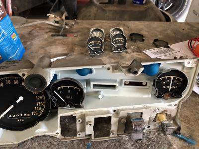

I started digging into the pieces yesterday.

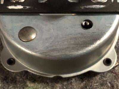

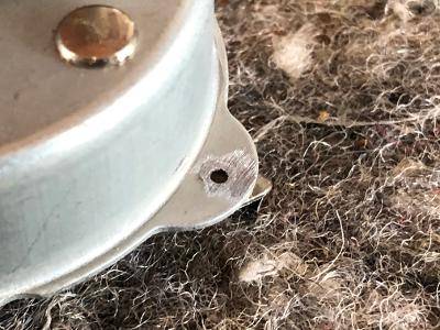

Each gauge is held in by two threaded rods with 3/8" speed nuts.
The back side has the mushroomed rivet.

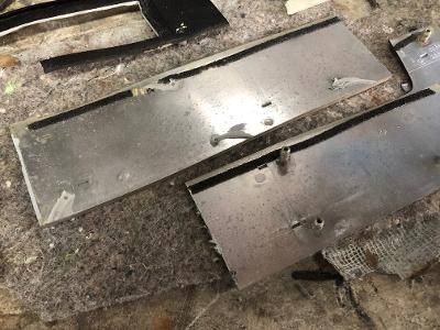

A few seconds with this:
Grinds off the flared edge...
Then you can pry off the face.
You can see the back side here. Note the sloppy JB weld...

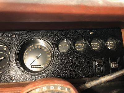

With the whole she-bang back together, I turned the key and....
The oil pressure came up immediately. The water temp did once the engine warmed up.

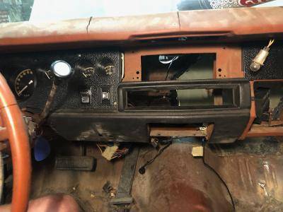

This car wasn't stripped out when I bought it but it was missing a few things. The radio and face plate were gone, the A/C and heater controls were too. There is no ash tray or map light. The glove box liner was missing but the door was in the back seat. The center panel that has the vent (In A/C cars) was missing too.
I bought a used center panel. For the radio....
I have a broken section that came out of the red car.
Nah.....I have another idea. I'll eventually put a stereo in the car but for now, I'm going to make a radio delete plate.
I took a spare panel that usually fits over the glove box door...
It was cut down to match the width of the radio face plate. The mounting pegs on the back were cut off since this will be retained with screws.
Test fit.
Holes drilled, then another test fit....
The lower middle section has nothing behind it and it wants to bend in. I put a section of a paint stirring stick in to see how it looks when straight.
If the paint stick doesn't cause a fitment problem with the plastic lower panel, I'll leave it in there for awhile.

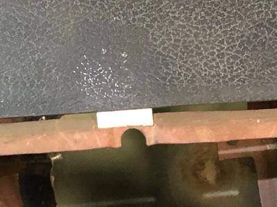

*I started replacing the rear window trim clips. The ones along the top were replaced only because they were bent. No rust or corrosion.
The clips on the right side and bottom channel were too far gone to use, plus I patched in new metal in a few spots last year. There were 2 original clips on the left side that I replaced. I asked elsewhere about the proper positioning of the clips. "Pnora" responded with some advice...Thanks to him.

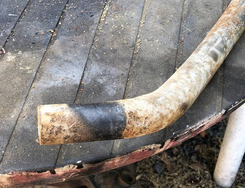

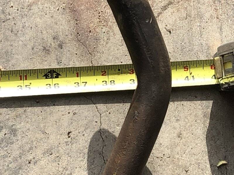

Note the way that the ends of the bar turn back towards center. Those get cut off.
The straight part of the bar fits through the K member in the aforementioned models. It is tight but it does fit K members that are not pushed in, bent or damaged. IF it rubs, thin shims can be slipped in for clearance.

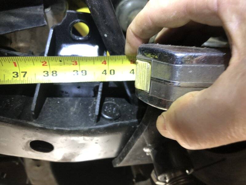

First up, with the car resting on the tires or with jack stands under the LCAs, I measured the distance between the sway bar end link brackets.
I came up with 39".
