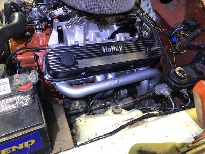

It sure is crowded in the engine bay with a battery up front. I've had the battery in the trunk of the red car for 8 years. Getting to the #1 and 3 spark plugs is sure easier with the battery gone.
I pulled the header. It made more sense to me. Clearance was tight with a spark plug socket and I figured that by denting the tubes, it would make all future work easier.
I took a spare head and set it on the bench.....
...Then slipped the header over the studs and screwed in the spark plugs. It was easy to see where I needed clearance. Some whacks with a hammer, wire brush off the flaked paint, a few shots of fresh paint and all is well.

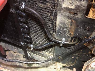

The transmission cooler was mounted in the same place I had it in the red car.
I wanted to do a better job of routing the cooler lines than I did in Ginger. I picked a spot to pass through the core support below the battery tray.

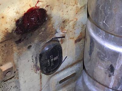

I found a spot that looked right. I found a body plug intended for the clutch pedal pushrod hole and traced around it...
I used the trusty Harbor Freight air saw....

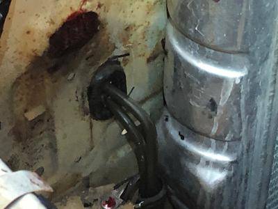

I fitted the grommet in place.

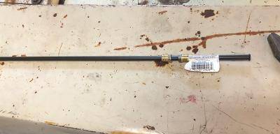

Using some 5/16" line....
Bent and shaped to fit...
All buttoned up and ready.

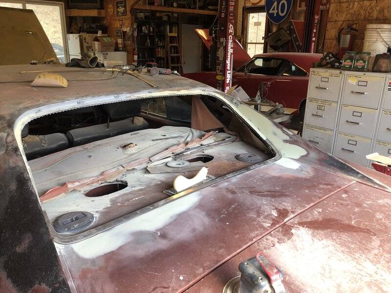

The rear window still needs to be installed but I need to prime and paint the window channel before I can do that. There are some trim clips to replace as well. I bought a set when I bought the rear window.
The rear window channel had a few rusty spots that I cut out and patched maybe a year ago? I'd have to go back and check. I have a new AMD rear window to install. I've read that their glass is thinner than stock so the trim clips might have to be set a smidge lower so the trim will sit right.
I recall that the glass is supposed to sit on that black sticky rope type seal. In the red car, Ginger, I used the 1/4" black licorice seal and then spread windshield urethane around it from the inside. It has never leaked.
So grab the 5/16 seal ribbon & your glass will sit higher causing the trim to fit with the clips in the stock location..
