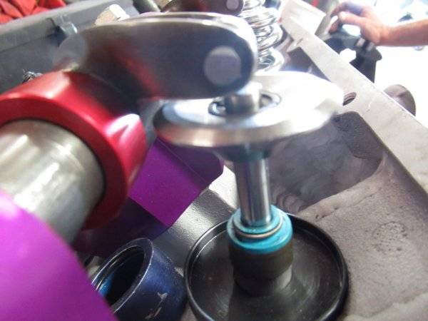

lewtot184

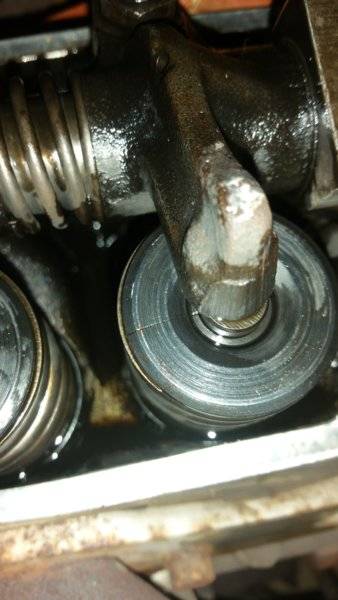

simply adding a cap will dramatically change geometry. whether that would cause a retainer to break in two I don't know. one of the problems I've found with those rockers is getting the scrub pattern correct with high lifts. for me a roller tip is much easier to correct because the pattern is much narrower. setting up the scrub on stamped rockers is even worse and that's why I limit the lift which limits the tip travel.
