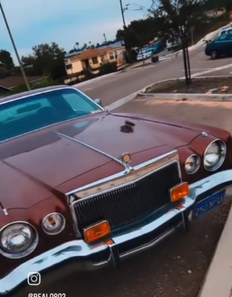

So I'm thinking about upgrading my 76 Cordoba headlights to LEDs . I do not want anything to fancy, no halo or anything like that .I want brighter lights , just plain glass look for the four lights . So the outer lights are 7 inches and the inner ones are 5 inches . Let me know if I am wrong I haven't measured them . If you guys know any links to some decent sets , please let me know

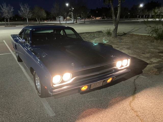

Wanted brighter headlights for my 70RR, shopped around and decided on the Holley retrobrights..
Yes they are pricey but well worth it, installed them and very pleased...
Just my $0.02... :thumbsup:

Note the previously mentioned Holley retrobrights do not require any modifications or cutting of the headlight buckets..
Their rear side is shallow and provides a nice heatsink.

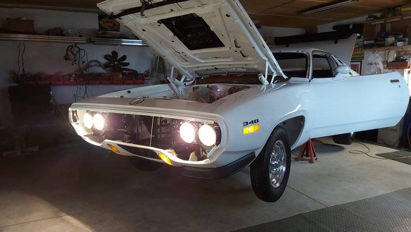

Or get the headlight relay kit thu Crackedback and brighten the ones you already have.
Or buy new Halogen headlights and use them with the relay kit.
Here is what halogens look like with the relay kit.

I bought the low and high beams from Walmart.
