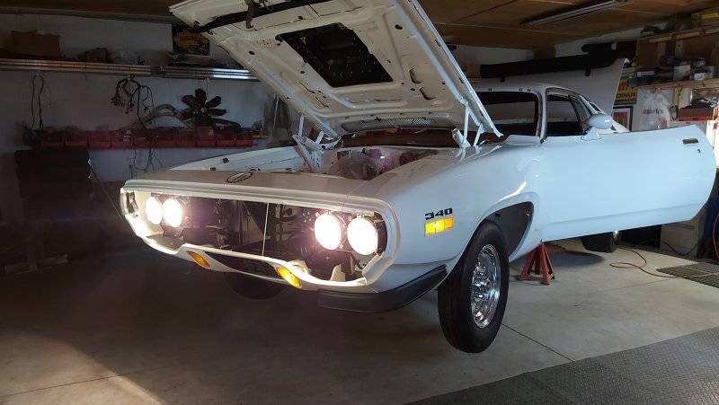

Here is what halogens look like with the relay kit.
I bought the low and high beams from Walmart.
IMO, I have seen many well intentioned pics like above, meant to be informative., but coming up a bit short. First, I believe we all can agree at some point all headlights are working, two, there is no way a screen shot viewed on a computer monitor can indicate intensity, etc of a headlight, and three this is again IMO, any way indicate the actual beam pattern.
The more useful solution I believe is, take a picture of the headlights working, properly aimed at a blank, preferably white wall, from say a known and noted distance of say 50'?, and include anything of visible size in the pic against the wall, to get a sense of scale, like a broom, a tire, etc. and if you want to get real fancy, also include a single sheet of white notebook paper to help a tiny bit with color temp distinction for the viewer.

Once my Runner is finished I can certainly take some photos like you mentioned.
