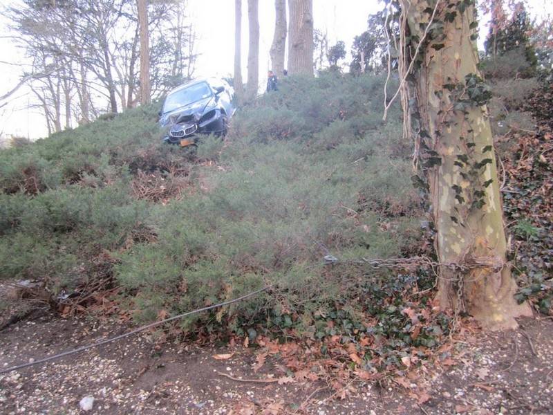

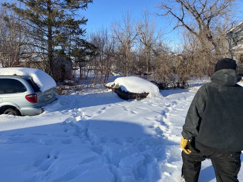

Looking for suggestions on what equipment to use to move some classic vehicles.
saw
...or at least clippers.
thank you. snack block will be added to my list. Waiting for some snow to melt.
Cool, looks like fun. Forgot to mention
the use of a dyneema winch rope.
Much lighter than a steel cable and
zero recoil if it breaks. The only thing
to be careful of is any sharp edges
against the rope when pulling. I
also found that two 6 foot lengths
of 6 inch diameter steel pipe can
get a car body moving where axles
have been removed. Finding
someone to help with a winch
would be a major asset.
I am having trouble retrieving one car. Is there away to bypass the locking steering? I have no key. Can't turn the steering, can't put into neutral to get it on the trailer

On the locked steering, sometimes you can pull the steering wheel off and remove the lock pawl.

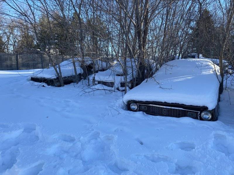

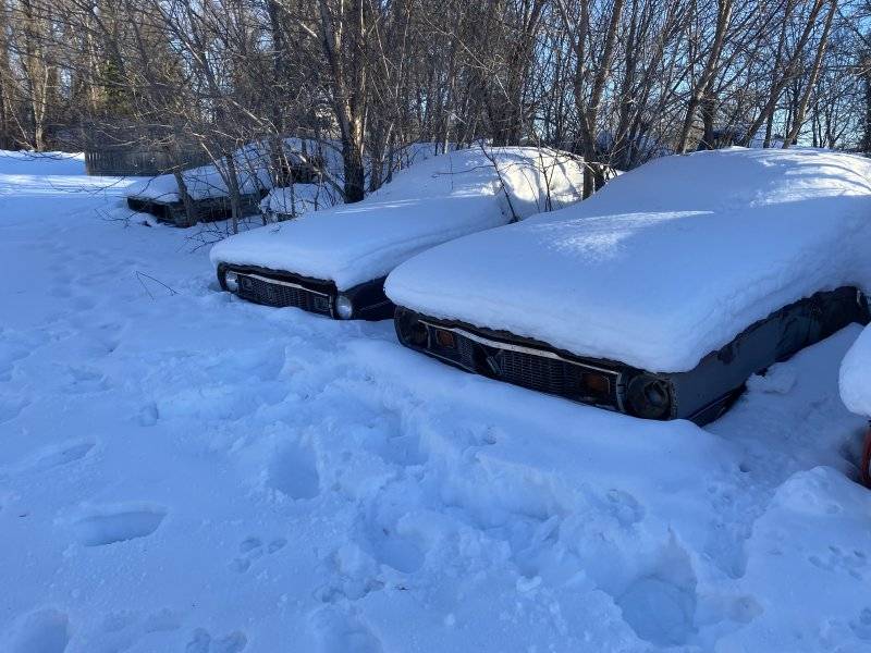

I have one lastd Duster to retrieve. Torstion bar on the drivers side is broke, that corner is dragging. Any ideas on how to load this on a trailer??

I got it done. Now I'm trying to figure out how to get the last Duster home. Driver side torstion bar is broke. That corner is dragging. Wondering how to load it on the trailer.
Harbor Freight furniture dolly under the broke end of the T bar?
Maybe lash it real good with a ratchet strap?
...or ratchet strap the T bar to the fender.

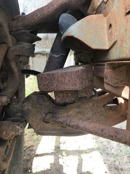

I have one last Duster to retrieve. Torsion bar on the drivers side is broke, that corner is dragging. Any ideas on how to load this on a trailer??
Raise it so the suspension hangs and fill the gap between the lower control arm rubber bumper and frame with a piece of steel or hardwood. How I loaded this Satellite for the same reason. Needing to do this to a couple more cars so I can move them too.
A buddy broke a torsion bar off-roading a Nissan 4x4. Did the same thing you mentioned...jacked, inserted block of wood between lower control arm & bumpstop, ratchet strapped it in place...and (carefully) wheeled it out and then home.
