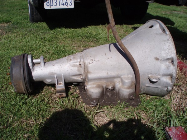

make sure that tranny doesnt have the trans brake drum on the back of it , most moblile home 727's did , and you cant just change the tailshaft .

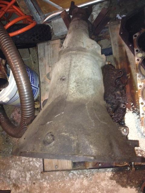

look at the tranny tail housing ...it's probably the real short stumpy version, not the standard tail length.

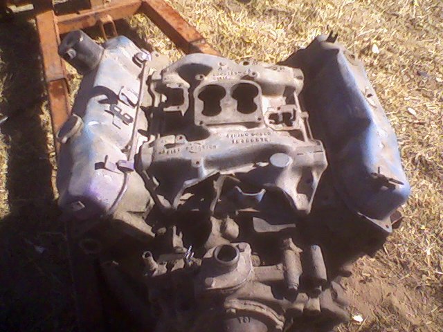

I Also have a 440 from a Motorhome in my 73 Roadrunner. Can't remember the year of the Motorhome but somewhere in the mid
70's. . Picked it up, brought it home and Pressure washed the old gunk off of it i found this!
So i decided to build this!

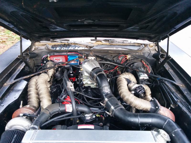

this is a 77 sportsman 440, cast crank, flat tops , 452 heads , LY rods , picked it up for 100 bucks. went through it , added a few goodies, slapped a 72 35" 727 on it and away we go.
