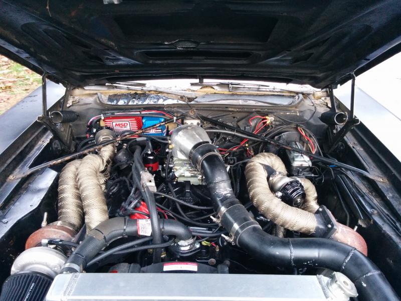

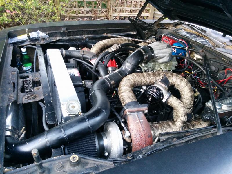

Looks like FEETS ride also. Tell us more. I hear 800 ft lbs of torque out of stock longblock with cam, valve springs and twins.
Man, haven't talked to Feets in a long time! He stopped by the house when he was in town with his Dodge diesel and that thing was boosted up pretty good too. Last time I saw his car was at the Mopar show and race and that show hasn't been in town in years. :(
If Im not mistaken his 65 plymouth started out life as a stock long block 78 452 headed motorhome job with small twins and he kept twisting input shafts at low boost on that in his a833...
