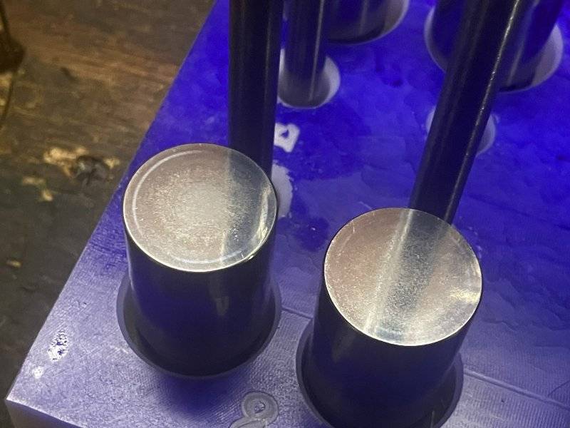

Last year when I changed my oil towards the end of the season, there was a small amount of iron fuzz on my magnetic drain plug. The only place I can figure thats coming from are the cam and lifters.
I finally got around to inspecting it today.

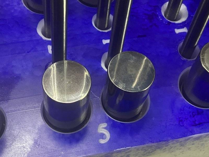

some of the lifters show a rougher wear patern in the center.
I measured the crown on them all and the ones with the least crown correspond to the visual wear.
I'm figuring its time for a new cam and lifters.
Looks pretty normal, that's how they look after some use.
Did you put this cam in or buy it this way?
Do you know how many miles are on this engine/camshaft?

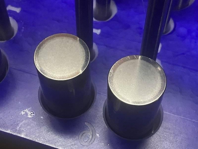

Lifter Pics:
I thought I posted these last night.
The lifters concern me more than the cam.
I installed this cam in 2021 when I rebuilt this engine.
It has around 450 dragstrip passes, probably not more that 2000 street miles.
Its a Lunati, hydraulic lifters are Rhoads.

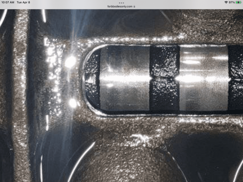

On of the visual tell tale signs that things are starting to go away is when a second wear pattern starts to develop on the lobe.
It’s usually an indication that the crown is basically gone, or is starting to get concave.
This one appears to have two patterns.
(Which lobe is it?)
(Which lobe is it?)
I think that’s the front, so cyl 2 intake

[1] Wear pattern is going to dependf on mileage the cam has done & spring tensiom.
[2] Any FT lifters made after 1995 are suspect.
[3] That is why you see me saying, ad nauseum: get your factory lifters re-faced.
It appears the cam has as much or more wear than the lifters.
From what I can tell by looking at pics on a small screen……… it would appear that some replacement parts are needed.

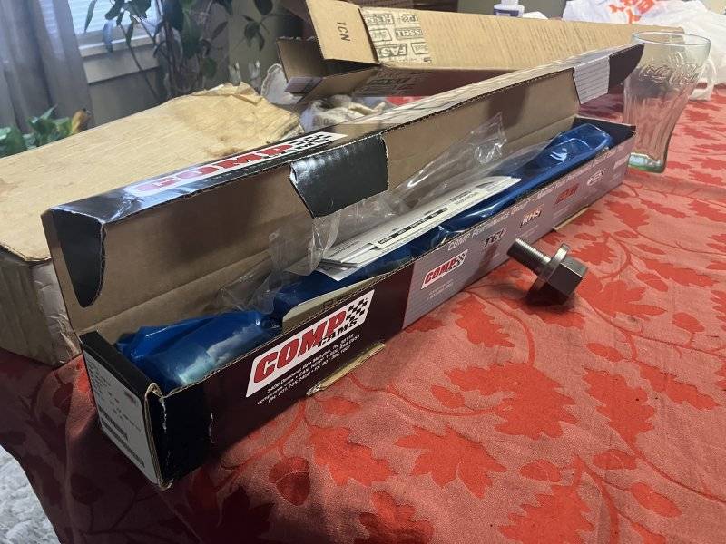

I just ordered a Comp. 23-230–4 which I believe is a XE268 solid.
It’s supposed to be in next week.

Speedway motors got right with the program!
And someone does make a crank bolt with a proper head, me.
Perfect, nicely done. Can you share the cam specs?
New Cam
Comp 23-230–4 Solid Flat Tappet
In Ex
.488 .501 Valve Lift 1.500 Rocker Ratio
.339 .356 Lobe Lift
230 236 Duration at .050
268 274 Advertised Duration
I am hoping to not lose to much power with this, but these Xtreme Energy cams have a good reputation.
I needed to lose som duration to ensure the valve to piston isn't an issue.
I'm also hoping that solid lifters will be better.
