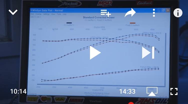

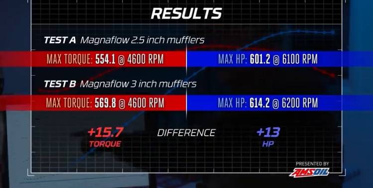

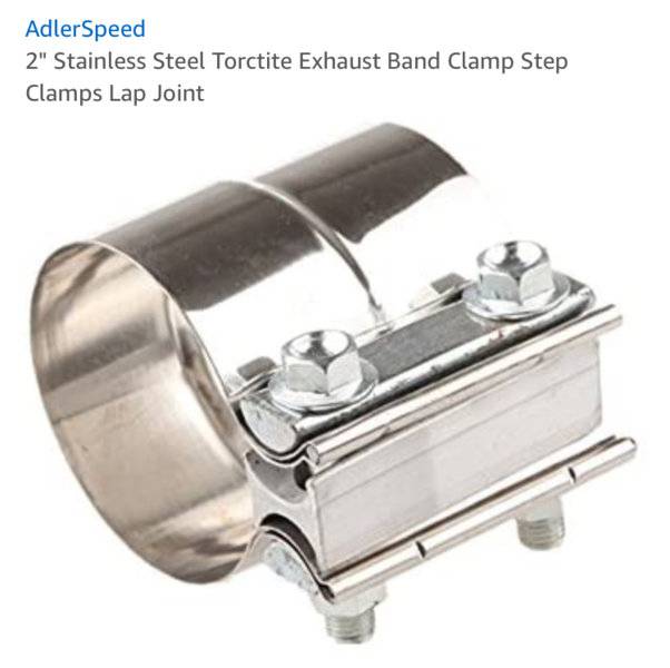

I wouldn’t get to wrapped up in stated numbers honestly. If you can see the Engine Masters series on beating/denting headers you’ll see a negligible effect. It’s an excellent episode, worth watching. I have a 67 charger, warmed up 383 with tti 1 3/4 ceramic headers (got them used- l looked at 1 7/8 because of the listed numbers too, but $600 used vs $1500 cdn new). The fit is excellent, workmanship awesome, and I bought 3” xpipe tti exhaust new. Zero need for 2” in your application in my opinion. And sometimes extra room in the engine compartment is valuable! The installation was easy, even by yourself. Use step clamps and not the supplied clamps though. 2.5” exhaust would have been better. Bigger can drain HP in some cases.I looked at the TTI website that was posted above and just going by there description of the 1-7/8 headers shows they are only good for 400-500 hp rating don't know how true of a statement that is
