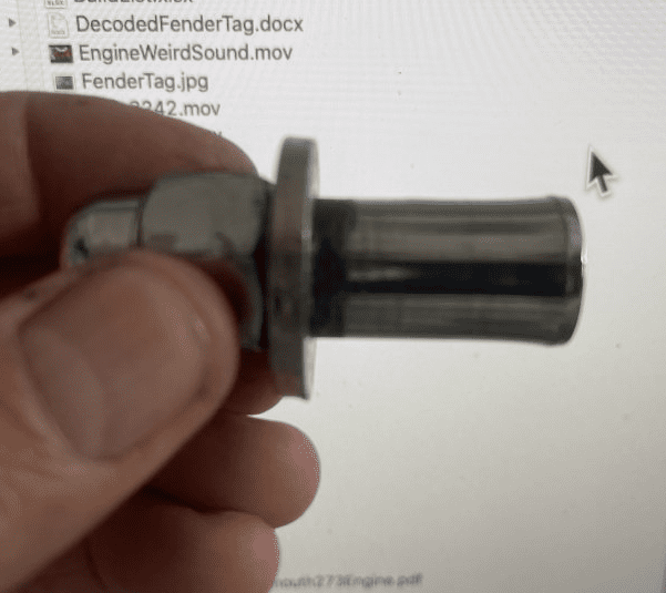

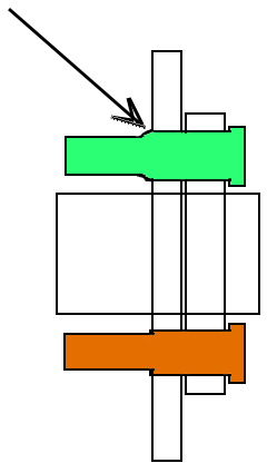

OP, image from a previous thread, do your lugs (lol, sorry, studs, tanks 33!) have a taper that may have caused this flare?
Tapered vs non-tapered studs, I don't know I'll have to check. The other thread... I recognized the nuts had been mushroomed, all have been replaced.

If you have the wheel mounted with a couple of nuts how much stud is showing where there isn't a nut? Down in the hole a little, flush with the hole or out of the hole? Then run a nut on the stud without a washer and see if it bottoms out before making contact with the wheel. If it does how much gap is there?
I think everyone is making this too complicated.
Take the wheel off, put a lug and washer in the lug hole. If it sticks out past the mounting face, you have the wrong lugs.
If it doesn't, look at the drum (if i recall, o.p. said he has drums up front too) and see if there is part of the stud, or a drum retainer clip sticking past the drum mounting face. If there is, that's your problem.

I've stated before, the lug nuts do NOT extend past the mounting face of the rim, I'm certain the nuts I'm using are correct for my rims.
I haven't had a chance to take the wheel off and inspect the studs.
These might look excessively long, but they are the correct length for the weld wheels I had
