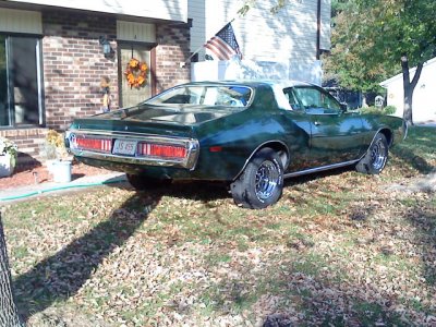

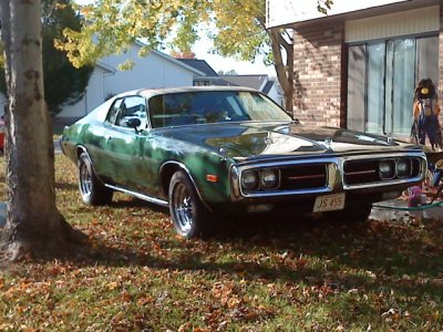

Theres a real good thread on moparts about this. You will have to search for it. Here's a pic of my 74. 275/60 0n 8 and 245/60 on 7. Most b bodies require a pretty good rear height to clear 10s. Mine has the prefect no hassle size. If they made the 10s with a little different offset, I would have 10s. 10-20-2011 051.JPG

Theres a real good thread on moparts about this. You will have to search for it. Here's a pic of my 74. 275/60 0n 8 and 245/60 on 7. Most b bodies require a pretty good rear height to clear 10s. Mine has the prefect no hassle size. If they made the 10s with a little different offset, I would have 10s.View attachment 47975

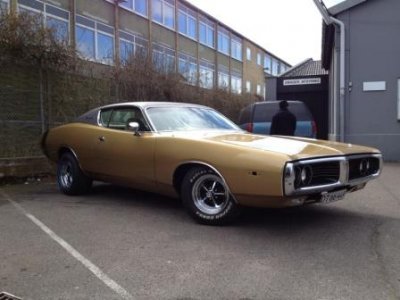

I go for the 15x8 (4,5 backspace) and 295/50-15 on rear, look forward to have it mounted!
It came out with 15x10 with 295/50 15 and new leaf spings from ESPO
Love the old school look :headbang:
Next step, on front will be 235/60-15 on 15x7 :)

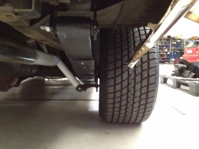

Are those the 5.5 back spacing Wheel Vintiques Magnums? I currently have 4.5 back spaced Steel rims, and they are so close to the leaf springs. Can you post a picture from the rear?

They are from Specialty Wheel (http://www.specialtywheel.com/ )- in size 15x10 with backspace 5.0
I shoot a picture and post it soon
Make a shoot under the car - hope you can use it

Maybe the Chargers are different, just a bit in the area of the wheel well, i have 15x9 on Centerlines and if i hit a dip, fender well scrapes the raised white lettering on mine, that shock stud in your picture is what ive been doing all week, mine snapped off, had to drill it out, tap the mount and put a new one in, all because of this, i put on new shocks to keep it from happening. You have any problems with this?
Nope, I mounted new shocks for little year ago, new leaf spring mounted here yesterday, I have not yet been cruising with my new wheel set up - weather in Denmark, still to cold - and when we have frosty nights they still trow salt on tarmac(waiting for some good rainy days :) ) - so late April we ready for cruising :)
