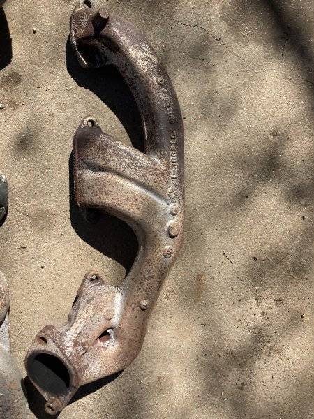

Hi Folks,
Would the earth explode if I used these older 2 BBL style Exhaust manifolds instead of Headers on my 383? What would I be sacrificing? Top end? etc.
- Currently the engine is a 40 over with stock 4BBL manifold, Edelbrock AVS 650 CFM, 516 Heads and a 'stockish' Summit cam. I don't really care about top end. Low end Torque is good though...

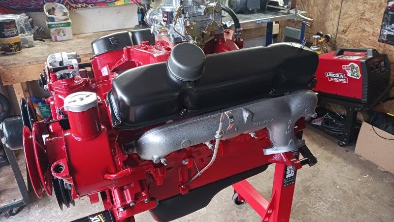

Depends entirely on what you want your car for. If you just cruise around and don't exceed 3-4000 rpm then your world won't explode.
If you like a free breathing, more efficient engine then you may be disappointed.
The more modified the engine, the bigger the loss in not using headers.
The '67-'71 H.P. manifolds would be a good upgrade. But, they are getting expensive. I never cared for headers; they usually leak somewhere.

That left side won’t fit a b-body very well, the collector will very close to touching the steering coupler.
The b-body collector dumps behind #7 plug.

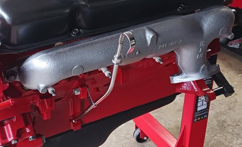

Cast iron is a lot less maintenance than headers. You could check for any casting flash inside the ports before you install them. File or die grind if neccessary.

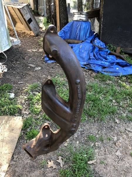

There was a special L.H. exhaust manifolds for use with a B-motor in an A-body. It kinda curled under the steering shaft. I agree that the pictured manifold will not fit. I assumed you were putting this in a B-body. That special A-body manifold is made from Unobtanium and is priced thusly. Headers might be your only option.
I kind of figured, that like lots of things Mopar, mixing and matching can be a can of worms... The motor will, in theory, run ok with the small manifolds, but not if you can't get the engine in the car. That must be why there is so many different crazy looking exhaust manifolds in the Mopar world.

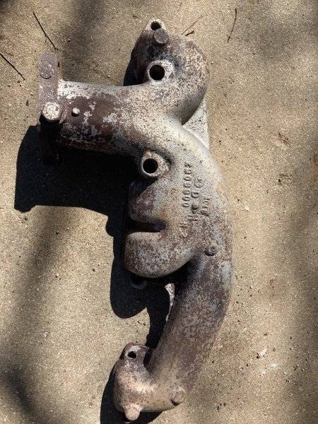

However, hp manifolds are the next step, and I do have a really good pair (the failed paint attempt makes them look worse then they are), with all the hardware. I’d let go for $450 plus the shipping (these bastards are heavy!)
U can use those manifolds in your 73 duster. U can also use C body hp manifolds. B body manifolds will work too. Go over to Fabo and ask your question. U will get a hundred replies. I have done 20 plus cars myself. Kim
