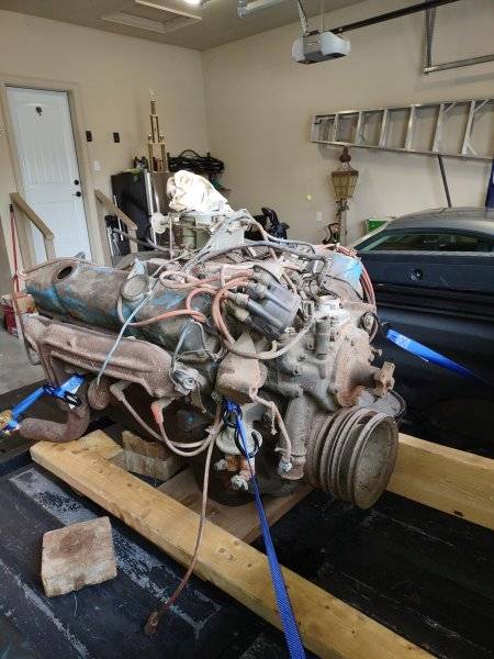

Well the engine is finally home. I was surprised at how clean it was on the outside. It is supposed to have 29,000 miles on it and it looks like it. Tomorrow I will start pulling it apart and see if the inside is as clean.

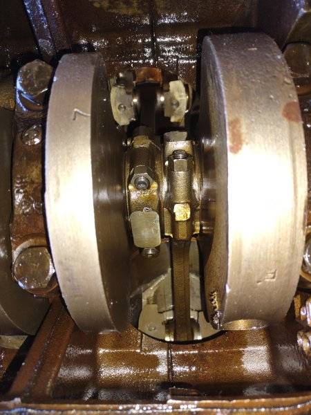

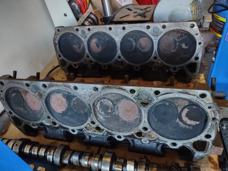

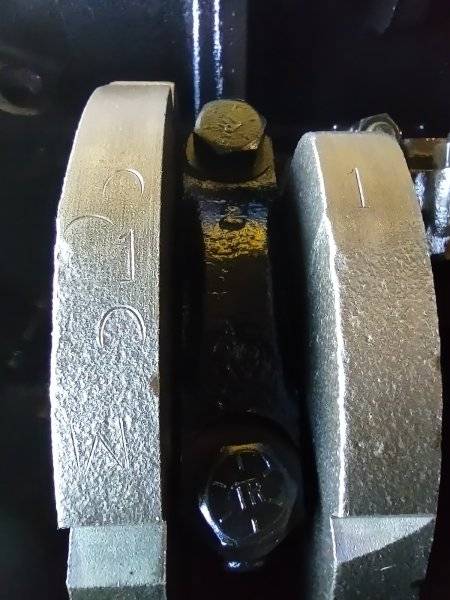

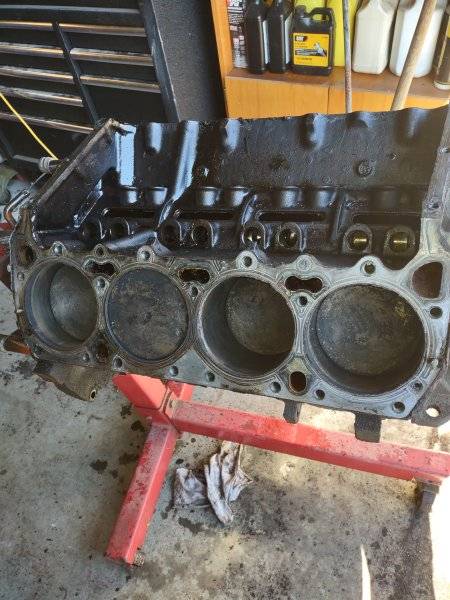

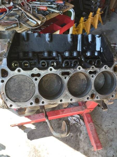

I got the engine mostly torn down today. The top end looks good, but I found out why it lost oil pressure. They said they shut it down when they heard it rattling, and the engine spins over easily so I am hoping no crank damage, but I haven't started pulling bearings yet. I ran out of energy.

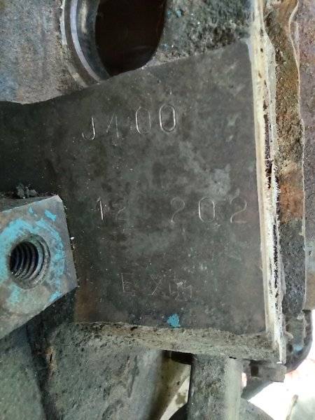

I did determine that it was a 73 engine with 346 heads. It also is marked for o/s exhaust valve stems, and the crank has a marking that looks like it is .010 under. There is also a 7 on the deck and on the crank, so not sure if a rod bearing is undersized. I'll find out soon. Once disassembly is done I will probably start a new build thread.

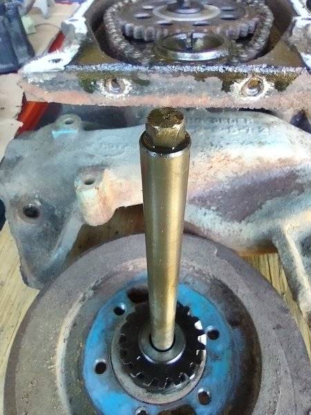

Did you see your oil pump issue?
Pickup tube problem. Tube was bent at the screen end, restricting flow. Like drinking a milkshake through a soda straw. I got a couple of different length pickups from a Mopar friend. I plan on putting a blob of PlayDoh in the sump, push the pan up into place, and see what kind of clearance I have. I am all ready to go at it tomorrow.
I didn't take a picture of the oil pan, but it was smashed on the bottom and the pickup was jammed up against it. Not sure if it happened before or after they pulled it, but I will need a new pan and pickup.
