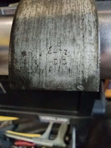

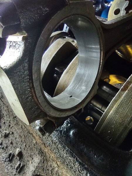

I got the rod and piston assemblies out today. The bearings had a little trash in them, but no scoring. The crank looked pretty good too, might even clean up with a polish. An interesting note was that there was a 7 on the deck pad and another 7 on the crank, so I expected that rod to be different, but all the rod bearings had the same markings, all dated 11 72, and all appeared to be standard? The crank spins freely, so hopefully the mains are as good.

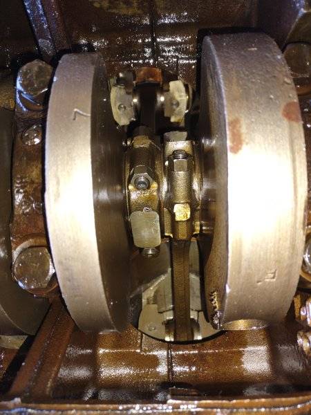

I got the crank out today. The mains were .010 under from the factory. Again the bearings didn't look bad, so it didn't run long once the oil pump drive broke.

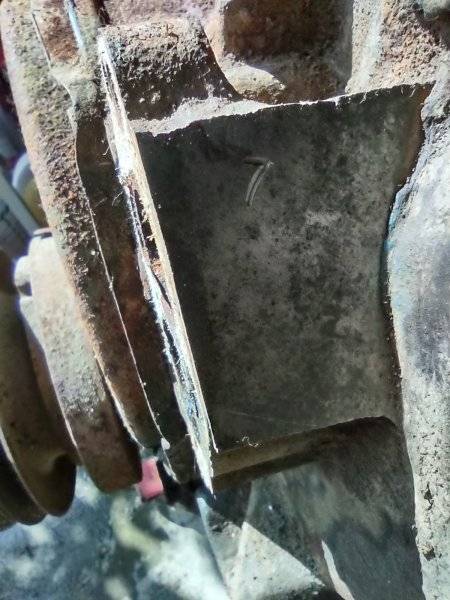

I did some more research, and it appears that I misread the info on the block pad. The E refers to a cast crank engine and the X with a maltese cross refers to .010 undersized main bearings, which checks out. That means the heads should be all standard sizes. The 7 stamped in the drivers side pad and on the crank throw is still a mystery to me.
The 400s I've seen usually have a number there. Not sure what it denotes, if anything
Here's 2 I have
Interesting, mine has the 7 there and also on the crank throws. There was nothing different about the number 7 rod or bearing that I could see.
