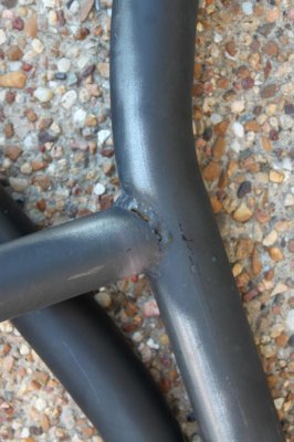

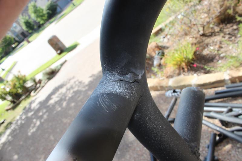

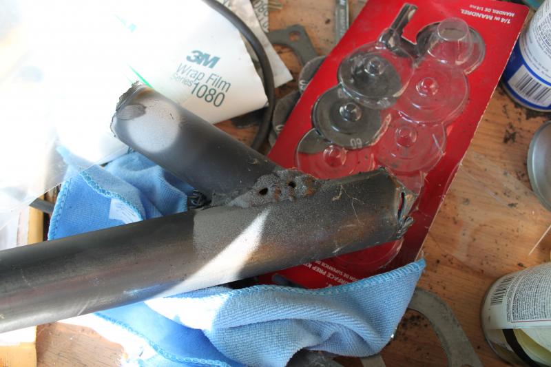

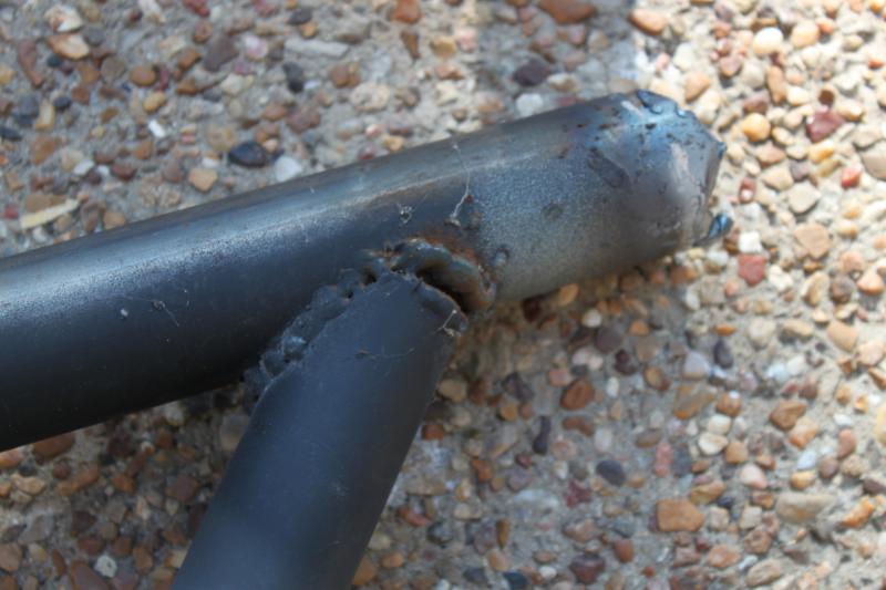

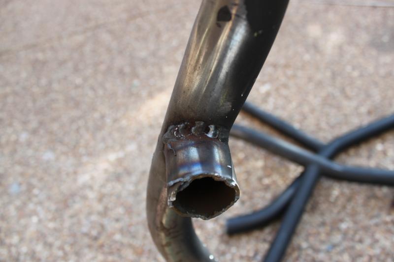

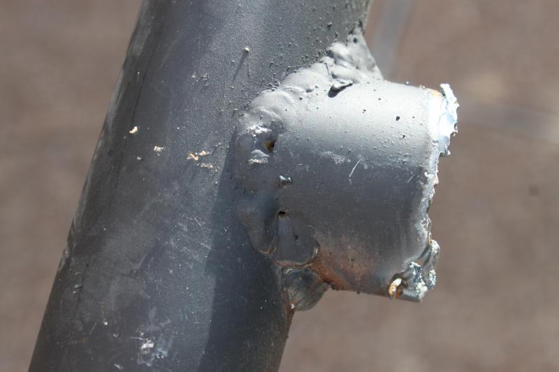

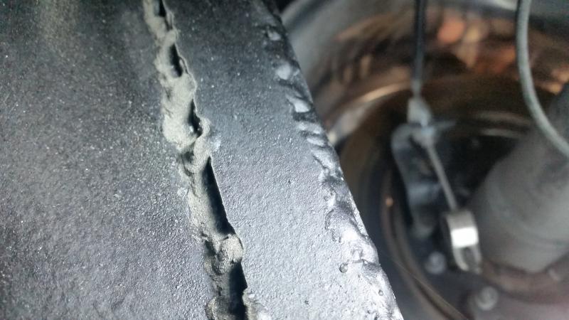

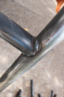

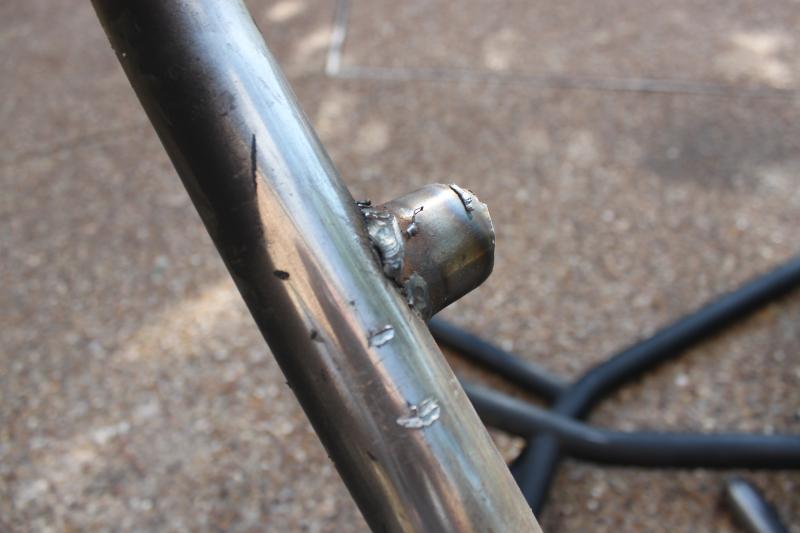

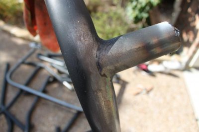

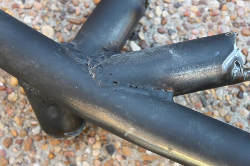

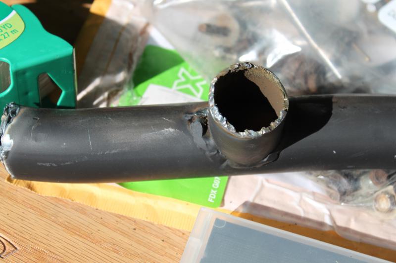

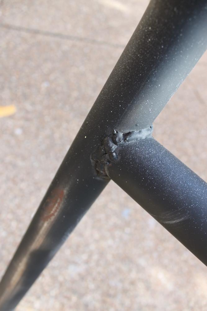

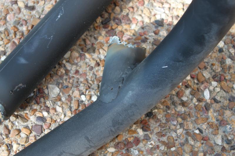

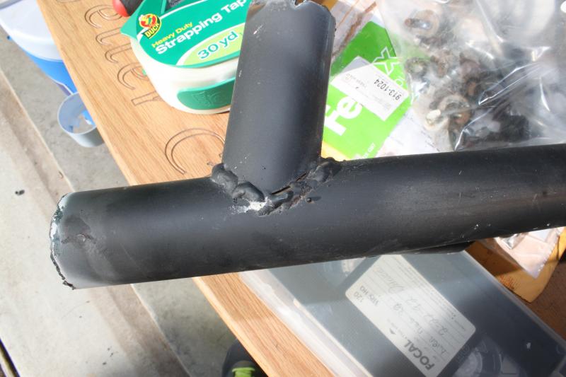

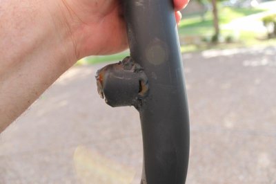

I know most of you probably dont follow my build in the new hemi section. I wanted to share this to make sure that you avoid using him if possible. I know recently he did a blue road runner that was very fast. I wish I could find that guy to ask him to check all his weld. I have absolutely no doubt that if I had crashed my car at 150 plus mph I would have died in the crash. That is not being dramatic, that is what 3 NHRA cage inspectors told me. All of them told me to cut the cage out and start over. This is a guy I trusted, I guy I thought was my friend. I took the car straight from him to the paint shop and didnt scrutinize the cage like I should of. He did an on job of welding the joints that showed. These pictures are the backside and bottoms of basically all the welds. At this point he will not stand behind his work because I cut the cage out. I would not allow him to cut it loose and re-weld it. First off, it would never pass certification, second my life and safety are worth more to me than letting this man touch my car to do anything else to it. Judge for yourself. If you know the guy from houston that Mark did his b5 blue road runner in the last 6-9 month PLEASE have him check the welds.

Those welds are even worse than mine. Why did you accept that?
Wouldn't have taken me 5 seconds to see that crap. I take it you never checked on the progress of the build?
ouch he is no welder ,he would not pass the test needed to become a cert. welder

Wow that is pretty bad. Hope it was mild steel and not chromoly.
Time for me to go to my night school welding classes, so far straight A's, and my welds were better than that before I started classes.

He was the only one to weld on this cage, I know that for a fact. No one else works there anymore

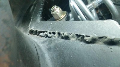

If you look at the pictures you will see the welds on top were ok. He was deliberate on those. All those welds are the backside and bottoms. Some of em I couldnt even see until I got it cut out. Then I was like HOLY ****

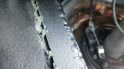

And those that think I might be embelishing a bit.......here is the rear 4 link work he did
Is this a licenced contractor? Can he be reported to authorities ? I can see a crime of manslaughter in his future unless all of his previous work is checked & rectified.

I've heard of 'Bird-****' welding before, but that doesn't even come close. You can't tell me that this guy has a Welding Certificate.
That looks like my first attempt at Night School more than 30 years ago.
