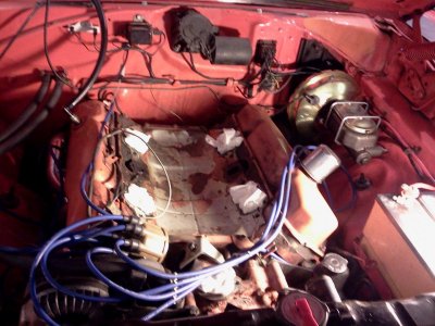

1. First picture shows the removal of carb, coil, dist, and intake. Prop was right, just like surgury.

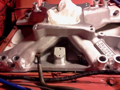

2.Shows how tight they had to make the fit to try to keep the runs as straight as possible. Tough to get a wrench in there.

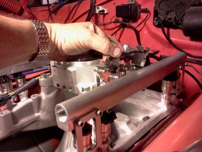

3. Shows the installation of the injectors and the fuel rails.

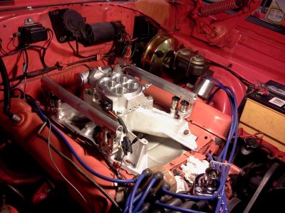

4. installation of the 4 barrel body capable of 1000 cfm/600 hp so there is room to grow.

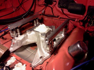

5. Shows where I need to figure out a solution for throttle linkage. This is where I left off last night. Next is a trip to the auto parts store. Any suggestions here would be appreciated.

You will have to change from the original throttle cable to the newer style. In this picture this is what i have, im trying to find a new end that connects to the same thing you have in the set up. What i have will work if i drill a new hole in it but the bracket is what i wanted to show you that was bought at a parts store, maybe you could ask about this and the cables that are adjustable. Hope this helps...
I forgot to add that I do not know for a fact this come from a parts store, i was told this. It works fine but you may find something similar that will work for your hook up.. with the new style cables.
Thanks Ron, Yeah I was coming to that conclusion about the new cable. Yes the picture helped. I think I might go with some kind of rod set-up. I seen those throttle ball attachments at the auto parts stores with a threaded end for a rod.
Here is a link and picture of one that may work with the older style.. As far as the bracket goes..for throttle. Im sure they would have about anything to get you started. Sorry pictures blocked view, i didn't see the rod set up but they might have them i imagine.. sorry.
http://www.summitracing.com/parts/SUM-G1419/
Yup, I just ordered a cable from summit. The return spring will have to come from the front. I may be able to use the mopar set up for that. I guess I will have to see if I can do some other stuff while I'm waiting.
