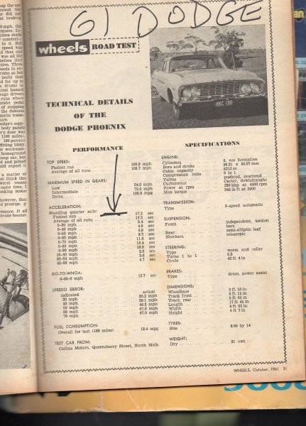

Dodge Phoenix was an Australian car, from down-under. Very few shipped to north America, since they arrived upside-down. :eek:
I owned many Dodge Phoenix's, including this model, for 16 yrs.
