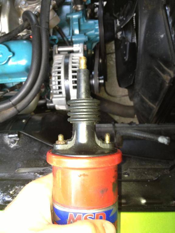

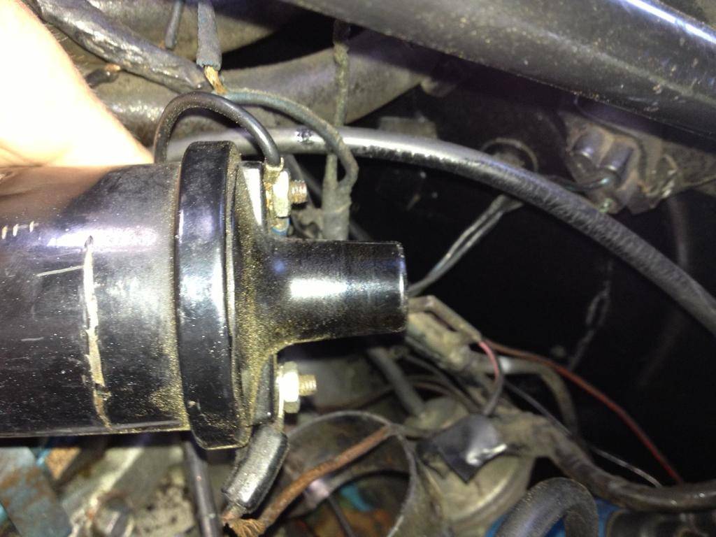

the cable from the distributor to the coil will not fit on my other coil. they have different outlets... this is probably a stupid question but how do i get one that works for the MSD coil?
Current Coil
New Coil

You need a Blaster 2 Coil (or just a stock replacement) or find the coil wire that came with that Blaster 3 ... judging from it's well seasoned appearance it's probably long gone.
Doesn't that boot and male end just pop right off? if not don't use that coil just get the msd one like your old one. Get all new wires that match the distributor cap and get a new coil that has the same inlet that one looks used? do you have the old points style distributor? if so did you make sure you points are gapped correctly? contact points are still good not worn out?
