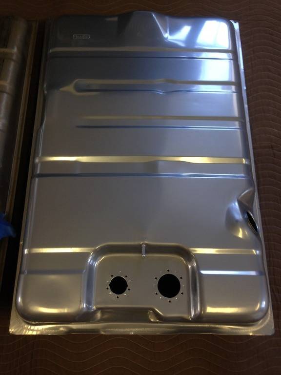

I received the back ordered EFI fuel tank from Tankstoday. The tank looks stock but it is set up for an in tank fuel pump and ithas baffles spot welded inside along with a 6” X 6” fuel tray. This looks likea nicely made tank for anyone putting a EFI system on their Charger!

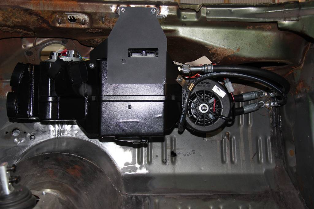

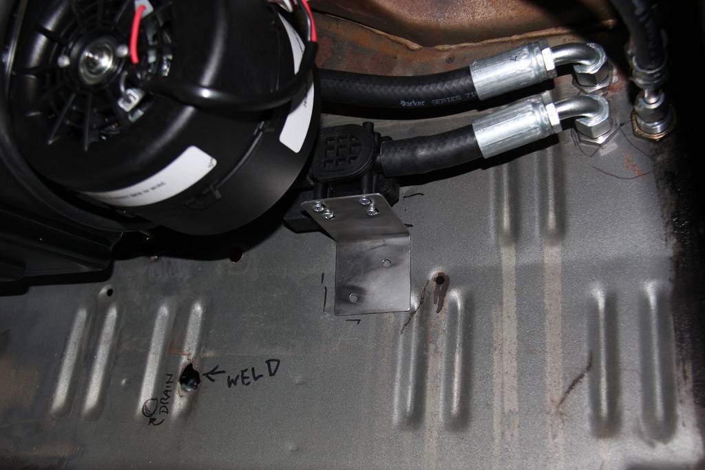

I finished test fitting the evaporator and making the heater and AC line inside the car. Welded 4 ¼-20studs on the firewall and top of cowl to hold the evaporator instead of the through-bolts and screws. I also put the heater control valve under the dash to hide it.

Nice pictures Pat. As always - top notch work.

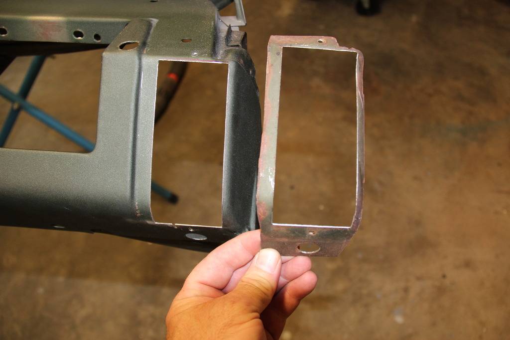

I have the Classic Air system, and it is set up much like this. In my case, I had to block off the passenger vent, although I was able to keep the driver vent. In my opinion, it is still really nice to maintain the use of these vents. They work really well and there are a lot of situations where you can use them. In your application, it looks like you could get a driver side vent and adapt it to the passenger side and maintain the use of a vent. I throw that out there just for your consideration...

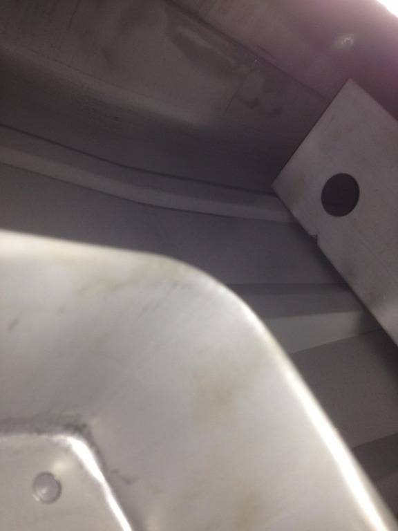

The other question/comment I have is about the wiper motor. I am sure you checked, but do you have enough room to allow for the wiper arm swing? It is hard to see in the picture.

Hawk,
The drivers side air vent is going back on but I will be closing off the right side vent. You are right the air vent is nice along with the vent window you can get a lot of air flow at low speeds. as for the wiper motor and regulators there is plenty of room, but looking at the pictures I posted the low angle makes it look tight.

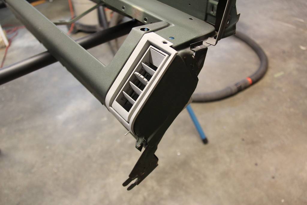

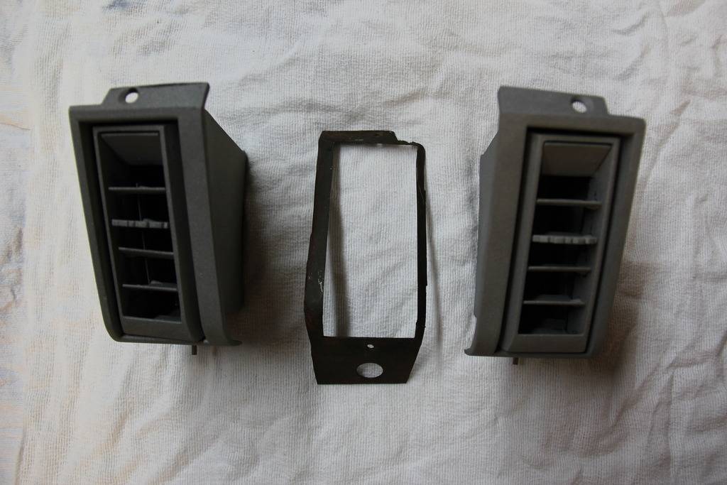

With the help of a few of the members from the DC forum Icut in the outboard dash AC vents use some great measurements, pictures, and partof an AC dash for an original template.
Thanks
Pat
Dude, I was thinking the same thing for mine. I have the two side vents.. I have a center vent, but I might use that area for a double DIN audio unit...

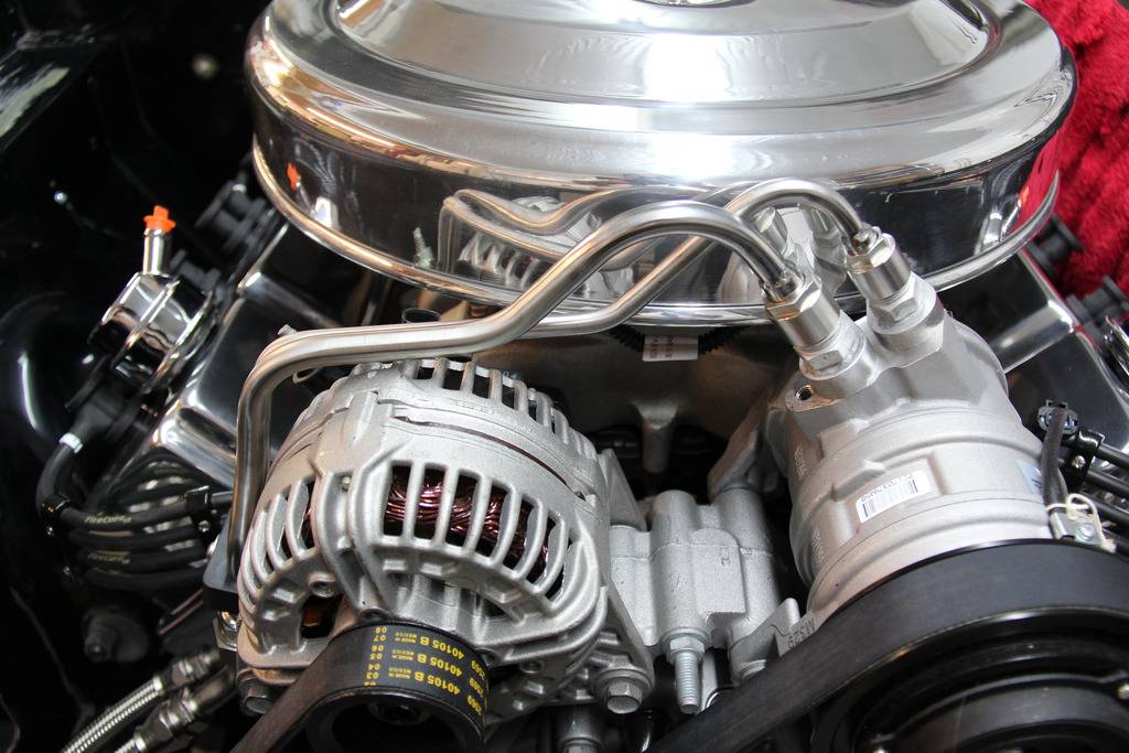

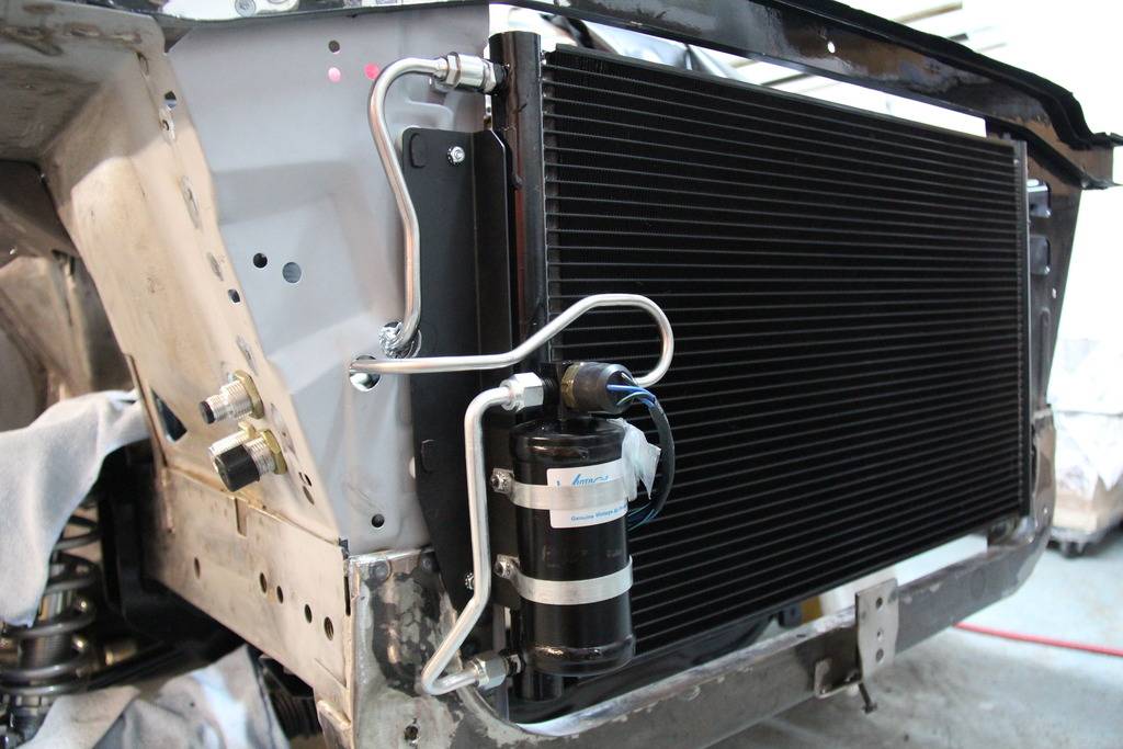

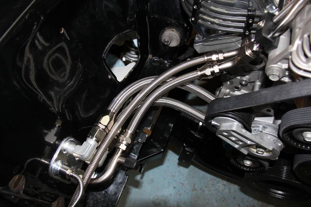

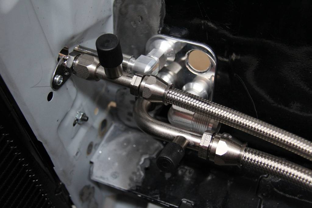

Finished the AC and heater lines at the motor, all that is left is one short line to make from the drier to the inter fender bulkhead fitting.
After bending the S/S line I had a friend weld the fitting on instead of silver soldering them on.
The short braided soft lines for the heater and AC running forward and down will help to de-clutter the engine bay.

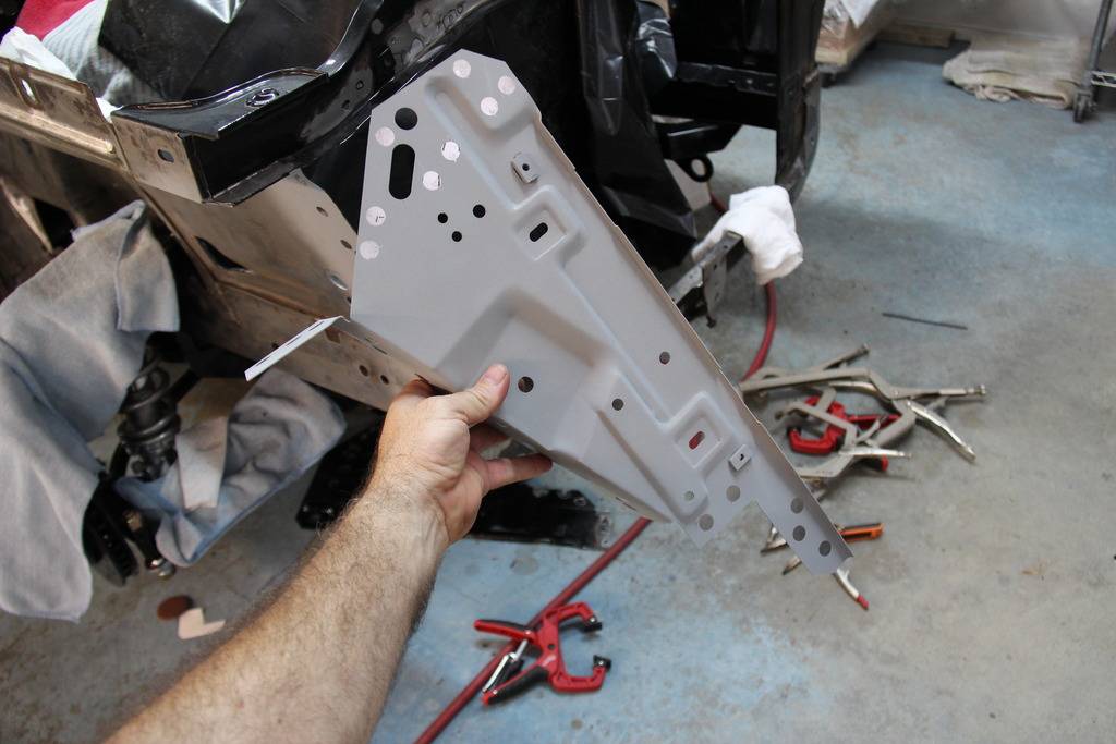

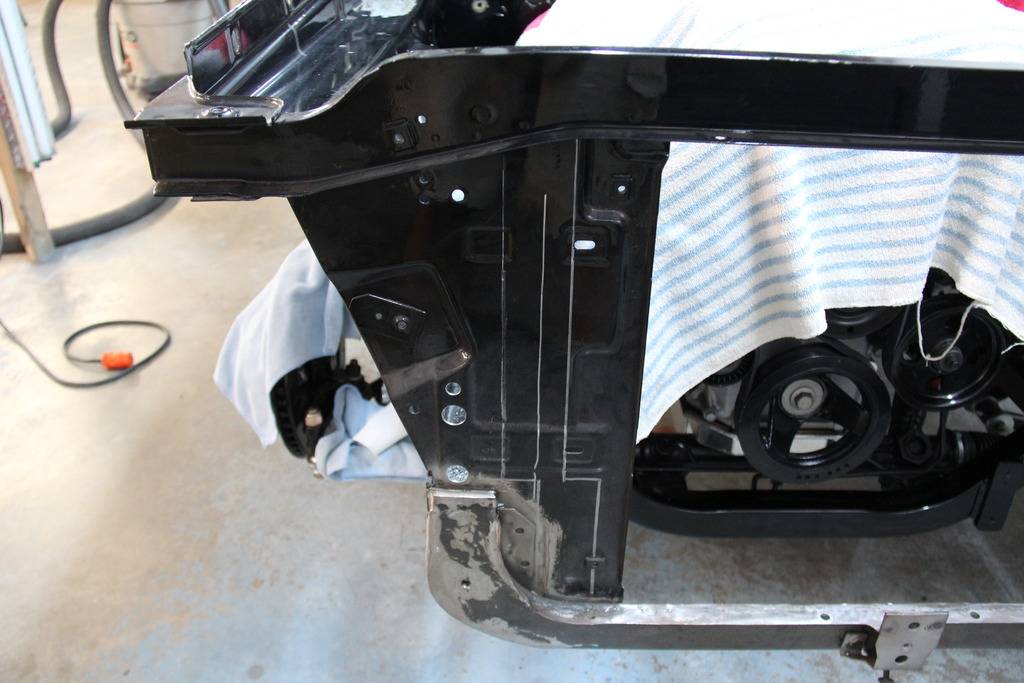

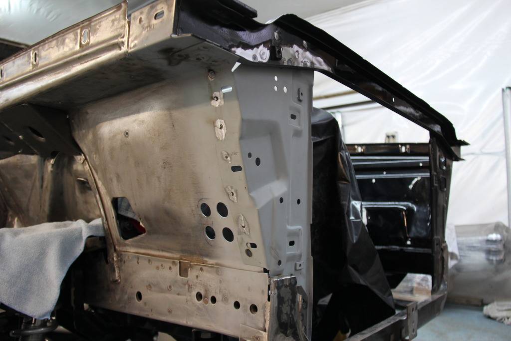

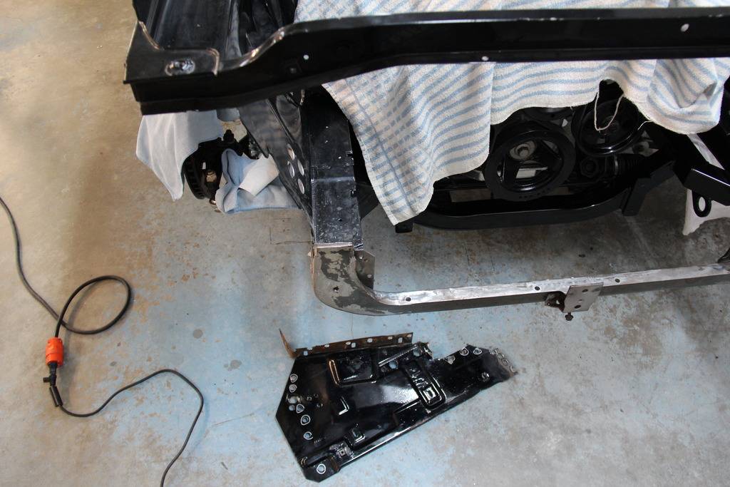

Today I replaced the right side radiator core support so Ican use the larger radiator. The new part fit nice and I spot-welded it inplace. I hope to test fit the new radiator next week.
Thanks

All the AC lines are finished and the drier & condenserhave been test fit. So far I’m very happy with the Vintage Air Mopar B Body system.I’m getting closer to putting the car on the rotisserie.
Thanks
