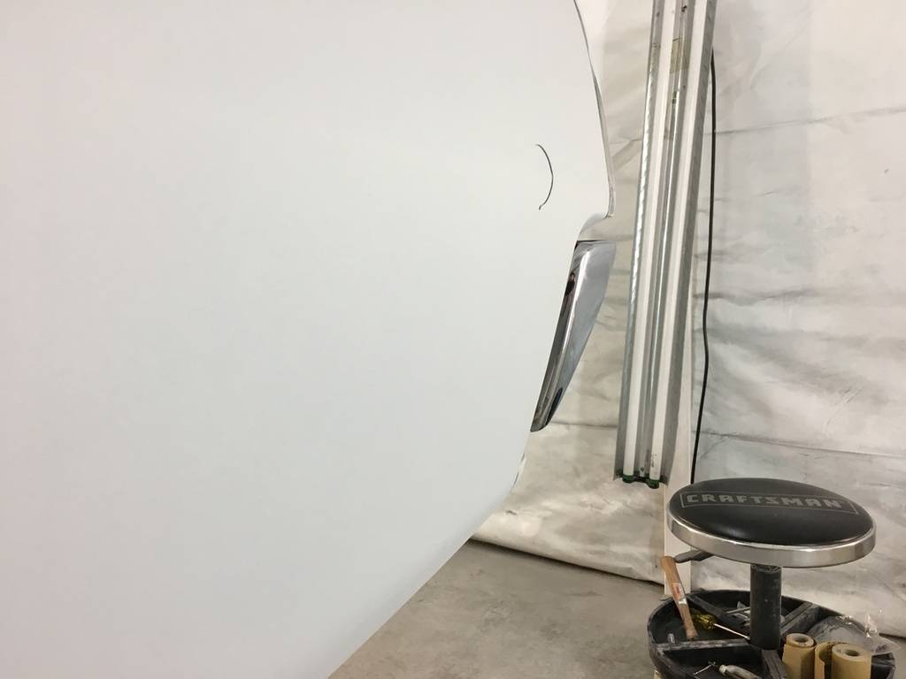

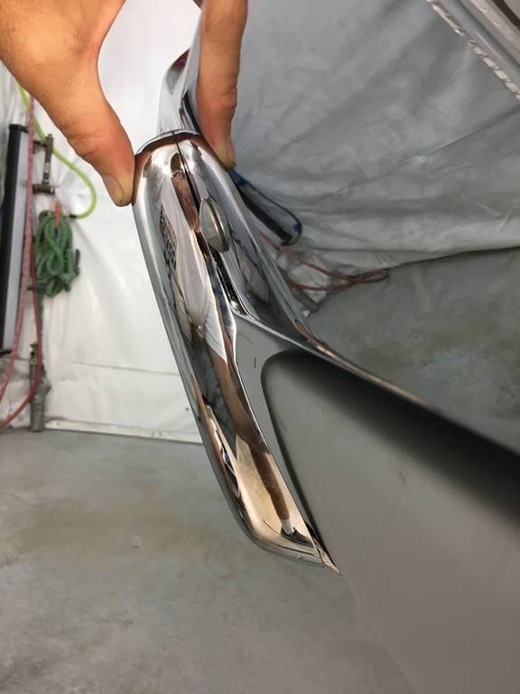

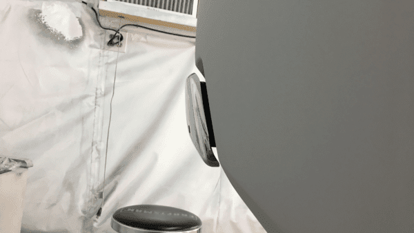

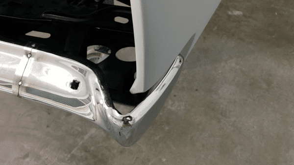

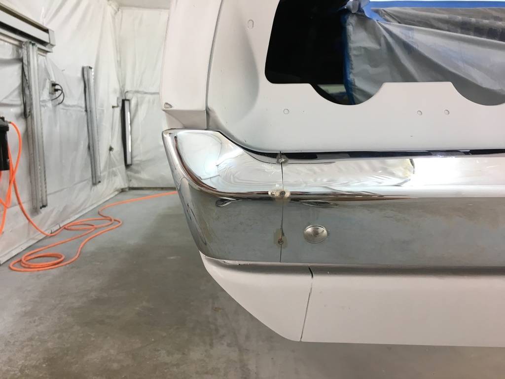

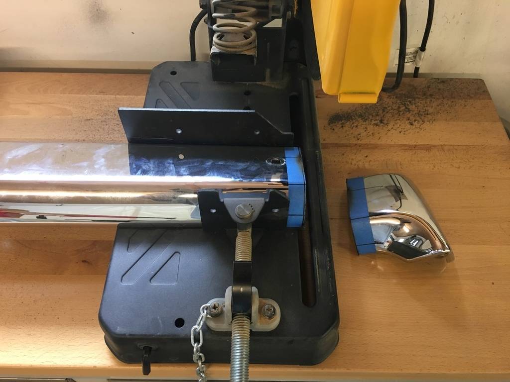

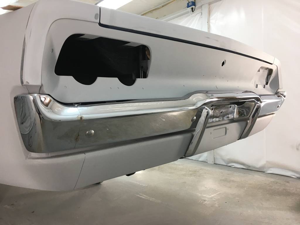

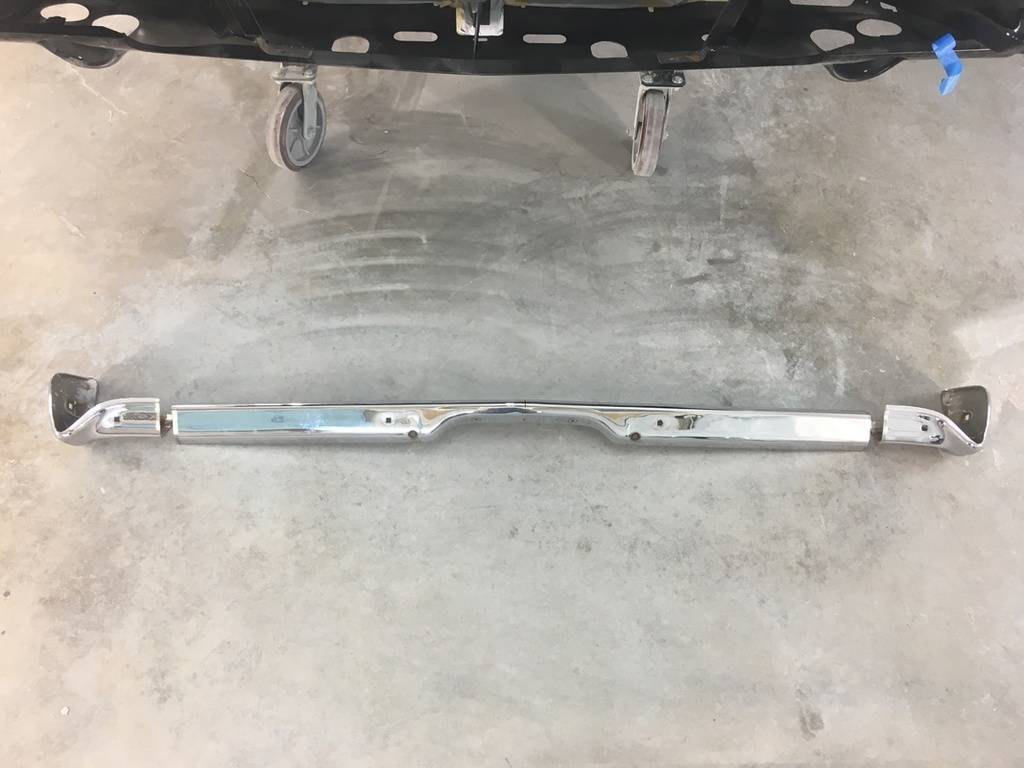

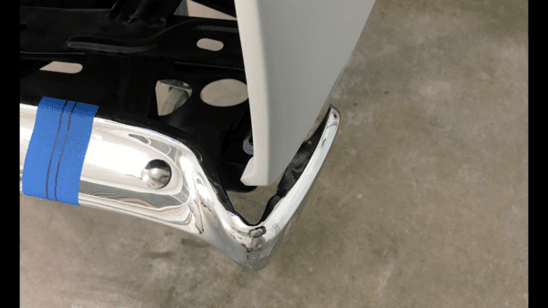

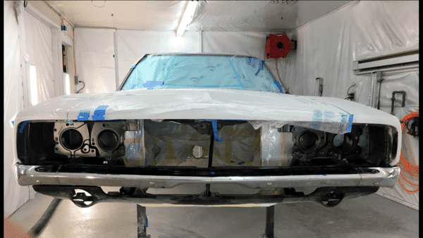

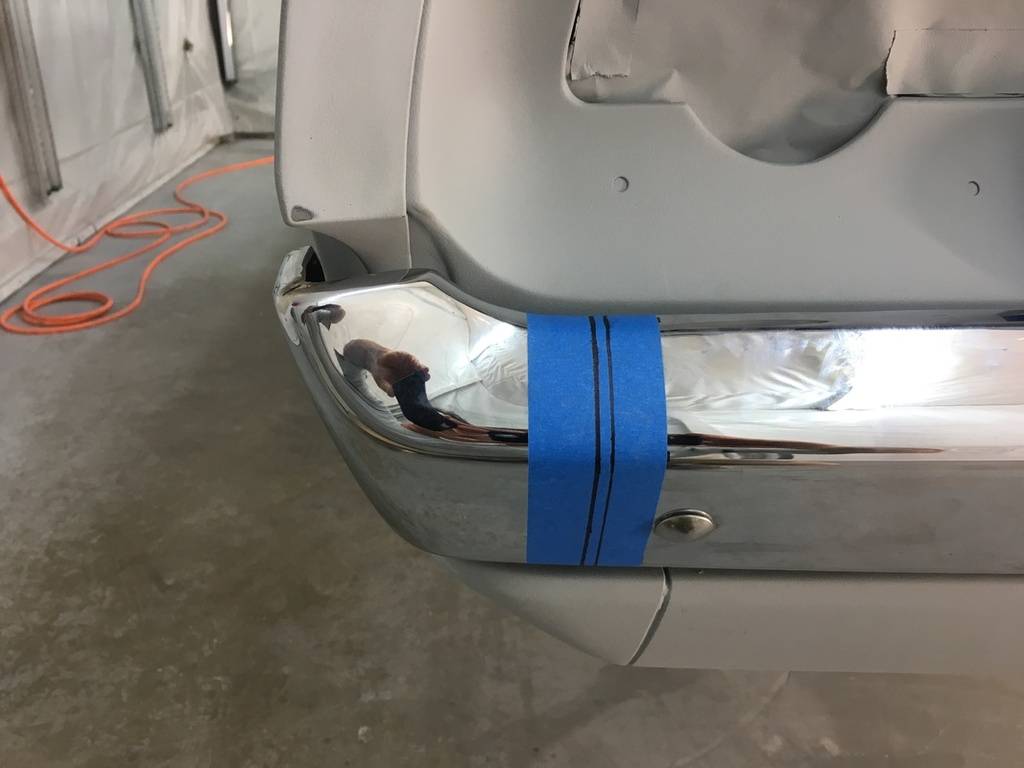

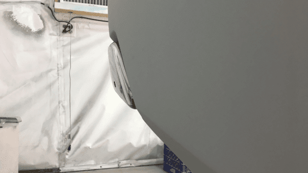

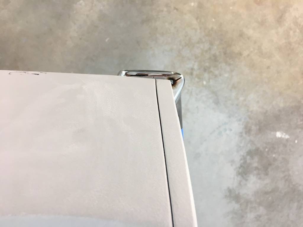

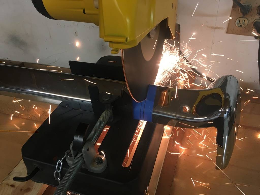

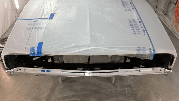

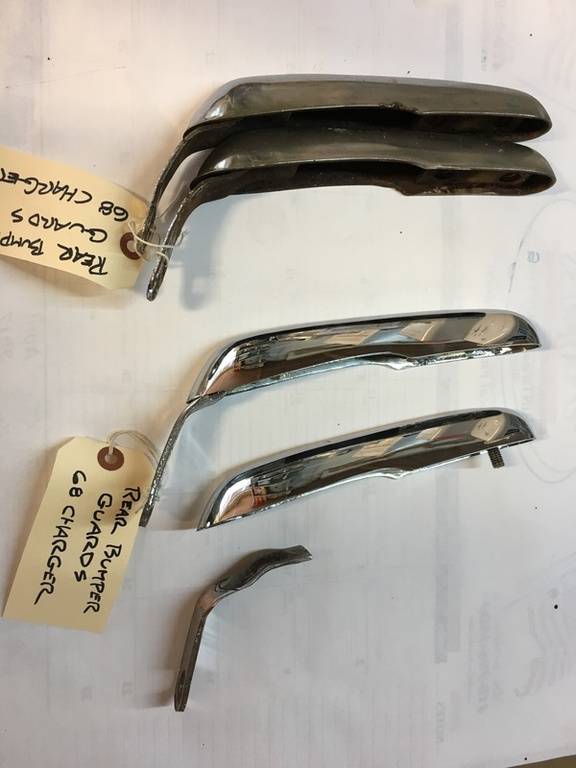

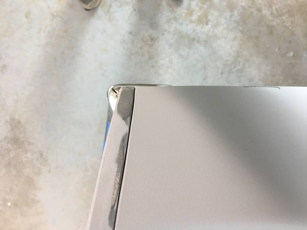

Outstanding as always Pat. Did you have to put in the rear valance corners? So far on my build that has been the worst part. I bought an AMD rear valance and corners and the corners don't come close to fitting. I only have one side done at this point and I had to cut it in half attach it to both sides and make a piece to fit in the center. They were that far off. I am more than disappointed in AMD.With the bodywork close to being finished I started fitting the bumpers. Both ends needed to bent out a fraction to be parallel with the quarter panel. Then I cut about a 1/4" off of each side for a better fit. Paul's Chrome will de-chrome the bumpers and then finish the welding, they will also weld on the studs for the mounts.
Thanks
Pat
