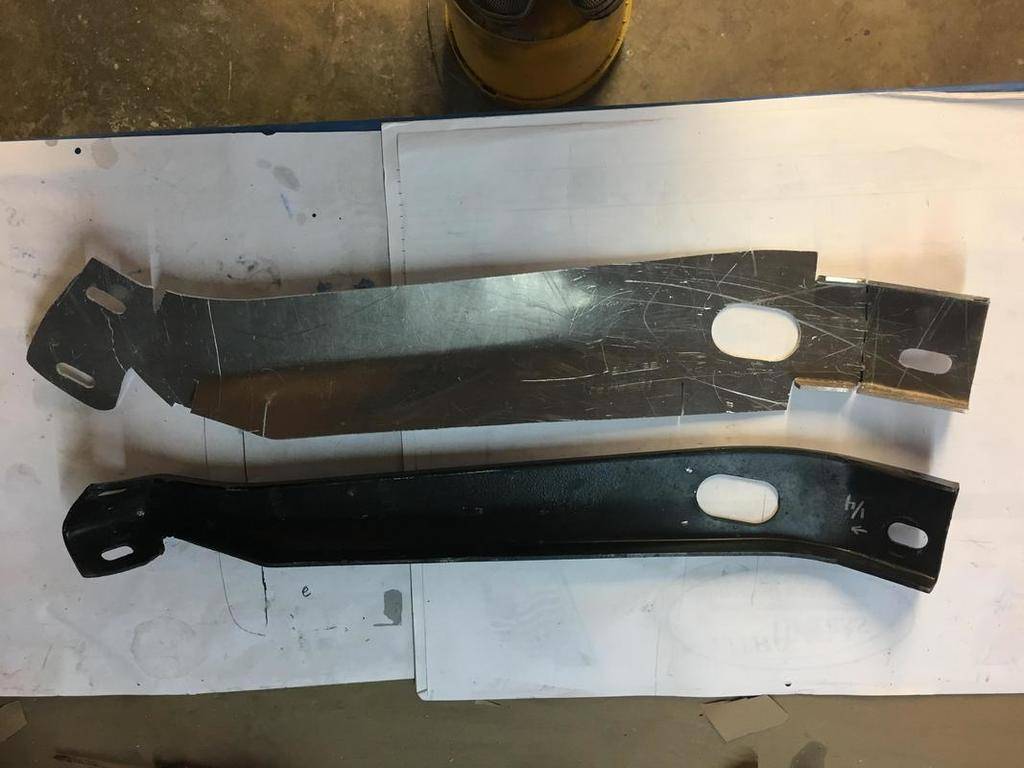

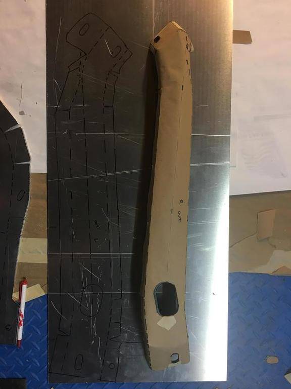

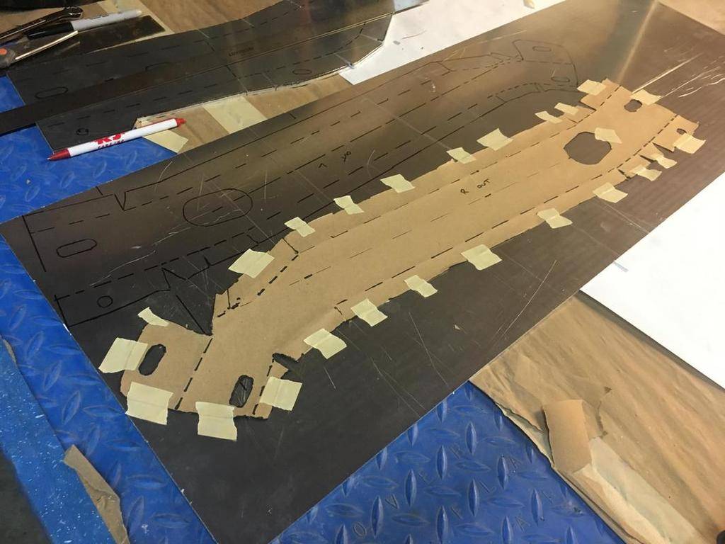

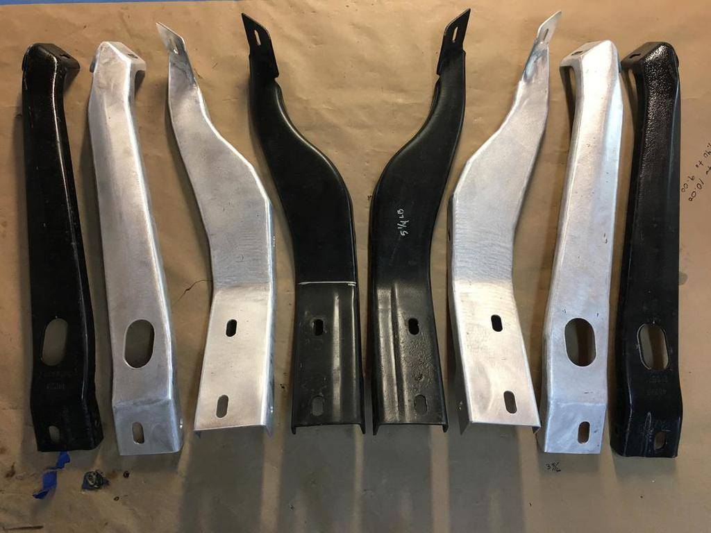

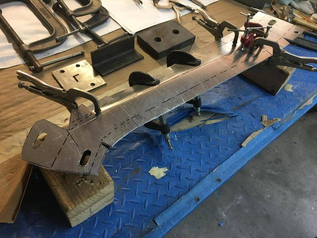

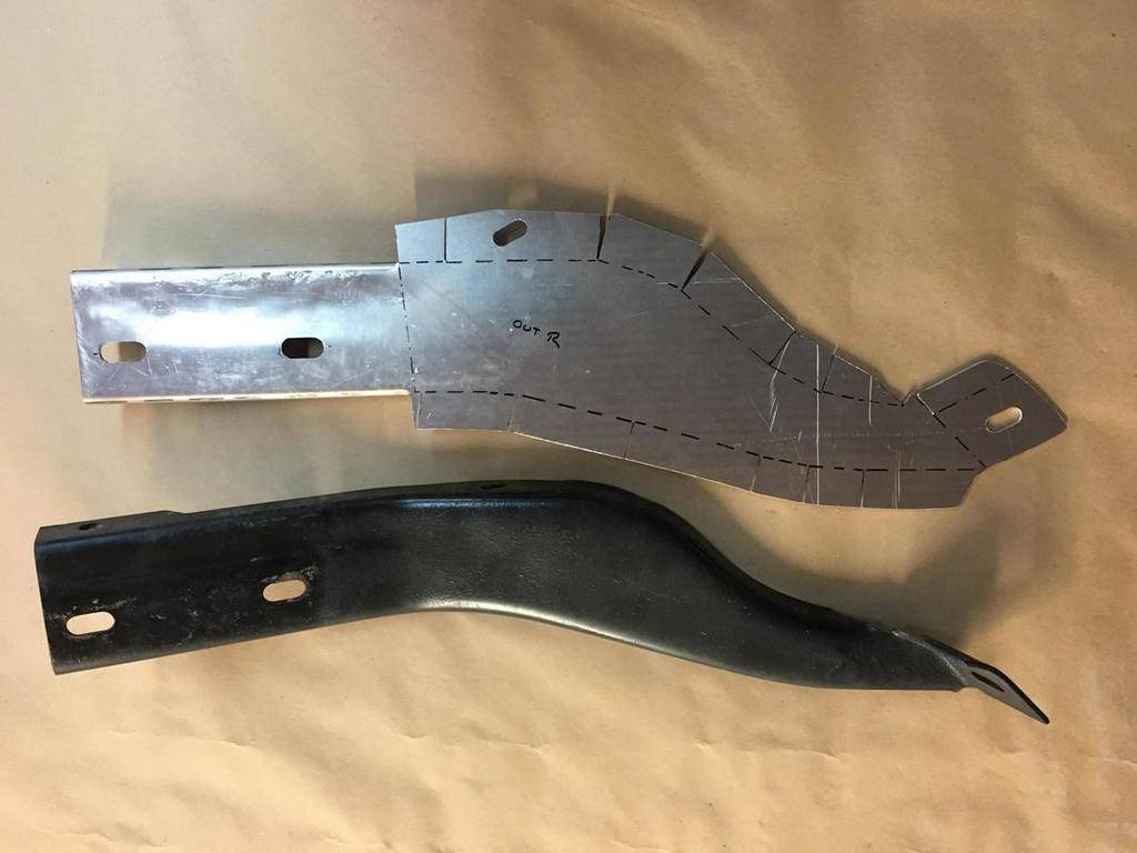

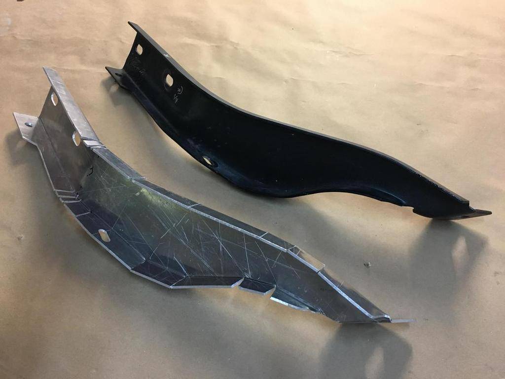

I took a little break from the block sanding and bodywork and started making the aluminum front bumper brackets. Made a paper template of the driver side mounts and was very surprised when I flip the template inside out and it fit perfectly on the passenger side mounts. Need to do some welding and bend up the other 3 mounts.
Thanks
Pat

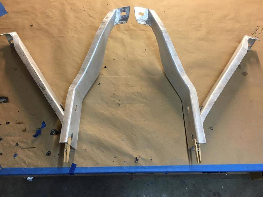

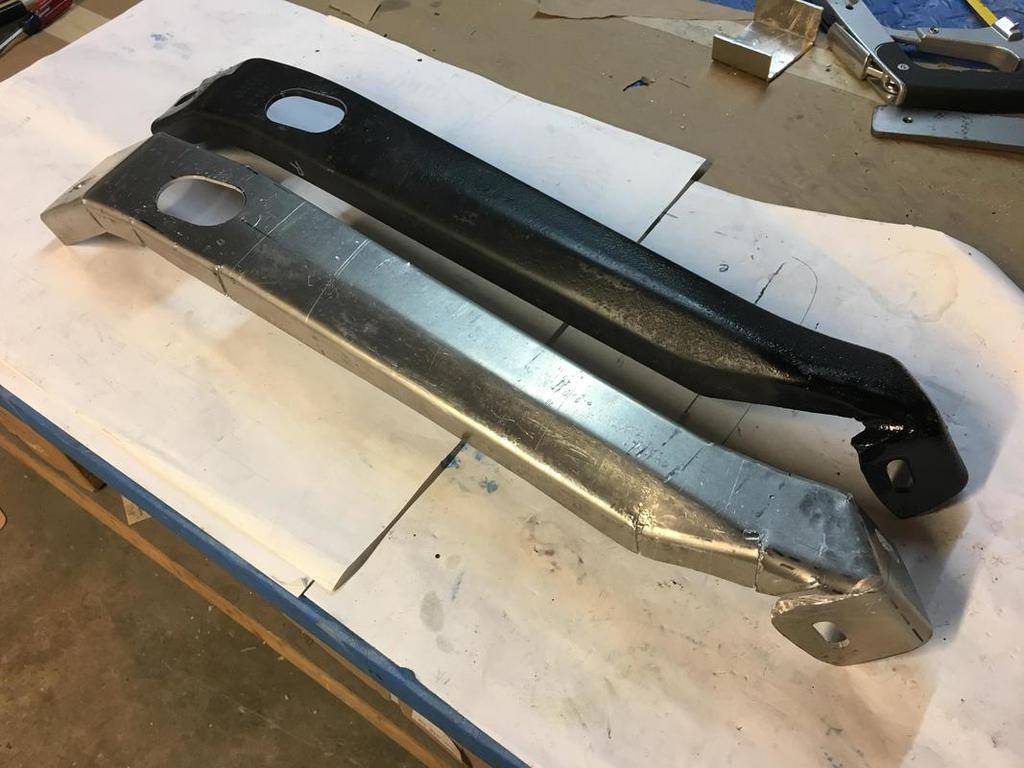

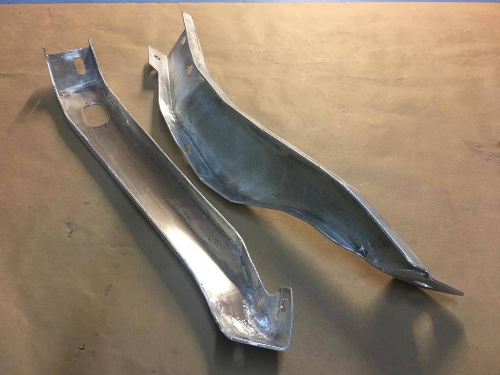

The right side mounts are bent, just need to be welded and then the welds ground down. I will test fit when the bumpers return from Paul's chrome before I paint the mounts, I'm sure they will need a little tweaking to fit.
Thanks
Pat

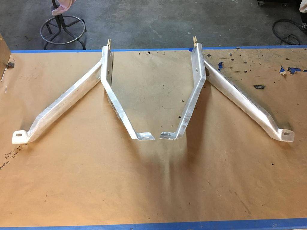

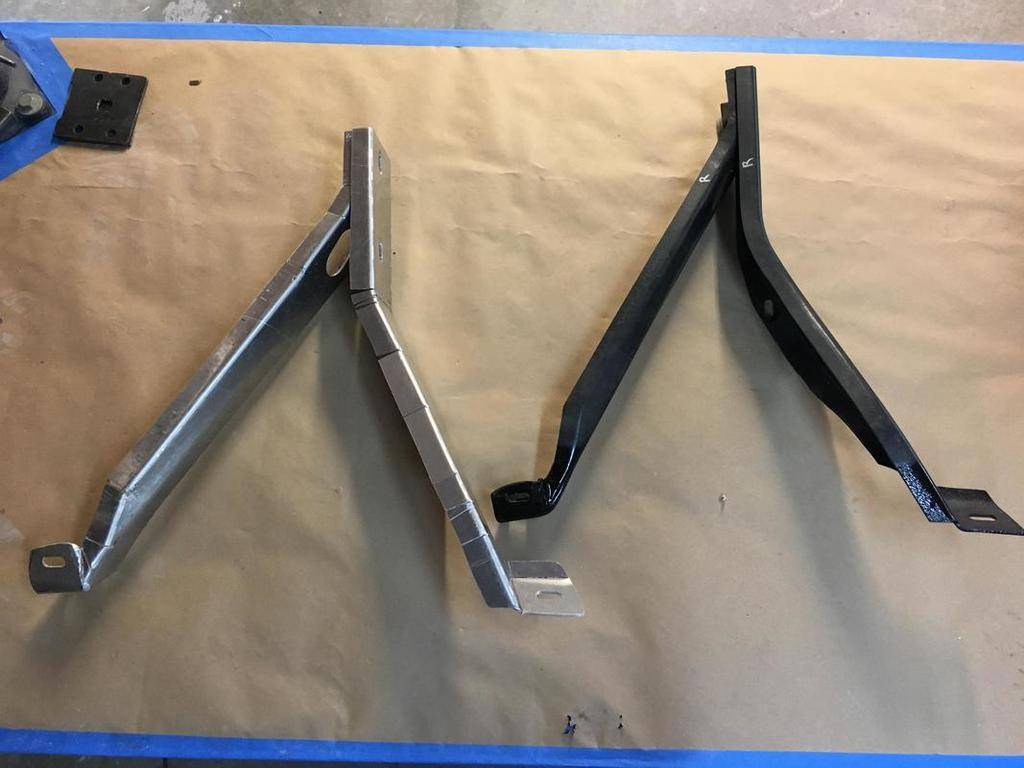

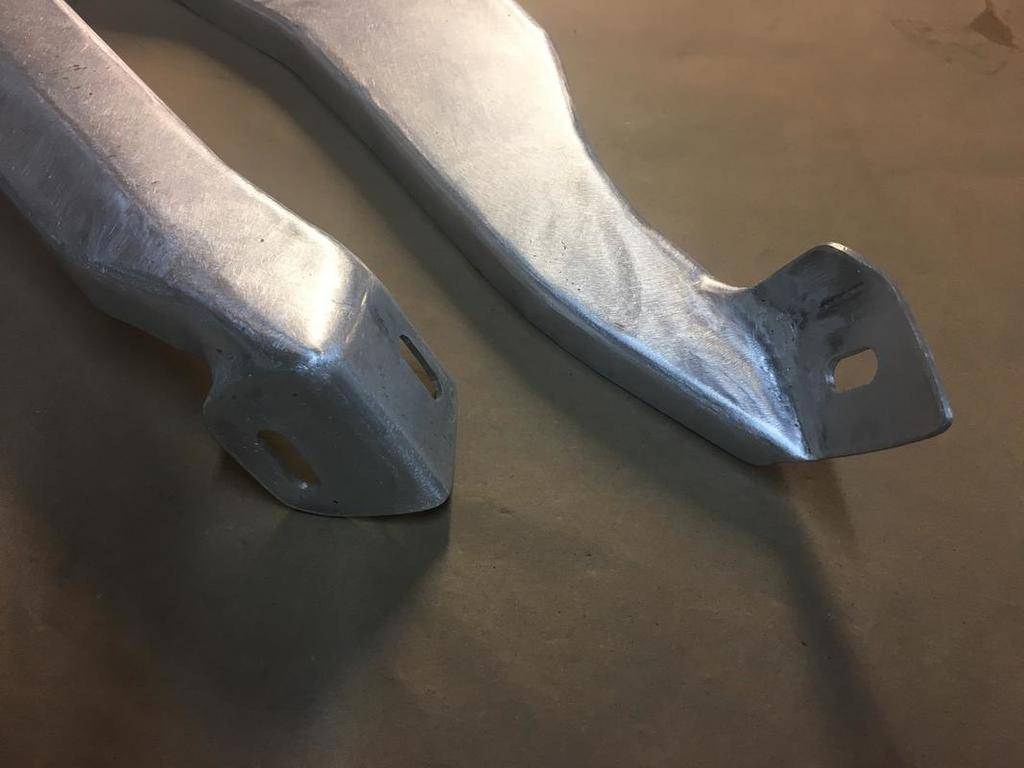

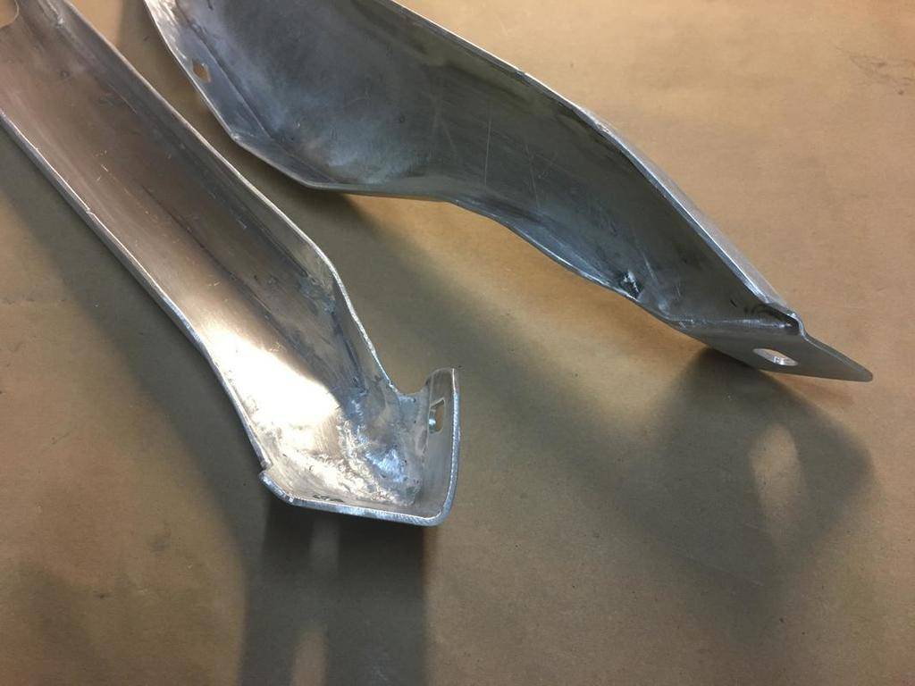

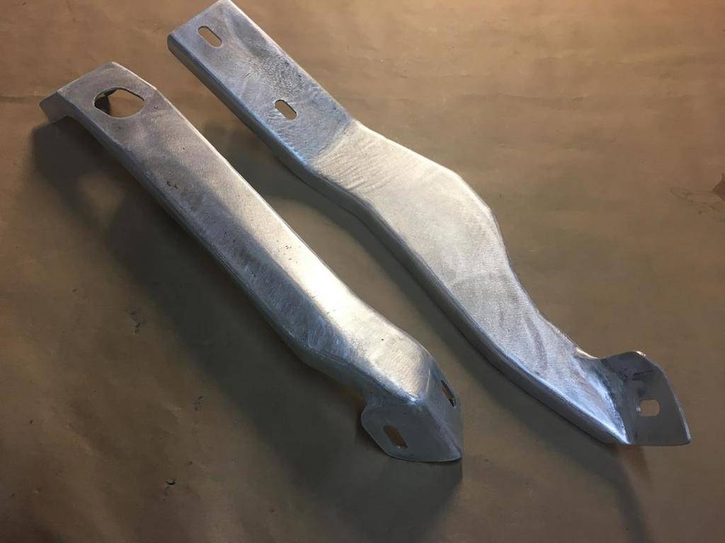

Finished welding up the right side bumper mounts and ground down all the welds. When painted black I think it would hard to tell that they're not original.
Thanks
Pat
Beautiful work once again.:thumbsup:
What make and model of mig are you using for all your sheet metal welding? Also, what size wire - .023 or .030 ??

I have a Miller 140 mig welder and use .030 wire. It has an auto mode but I alway use the manual settings.

A lot of work for bumper brackets,
they came out really nice too :thumbsup:

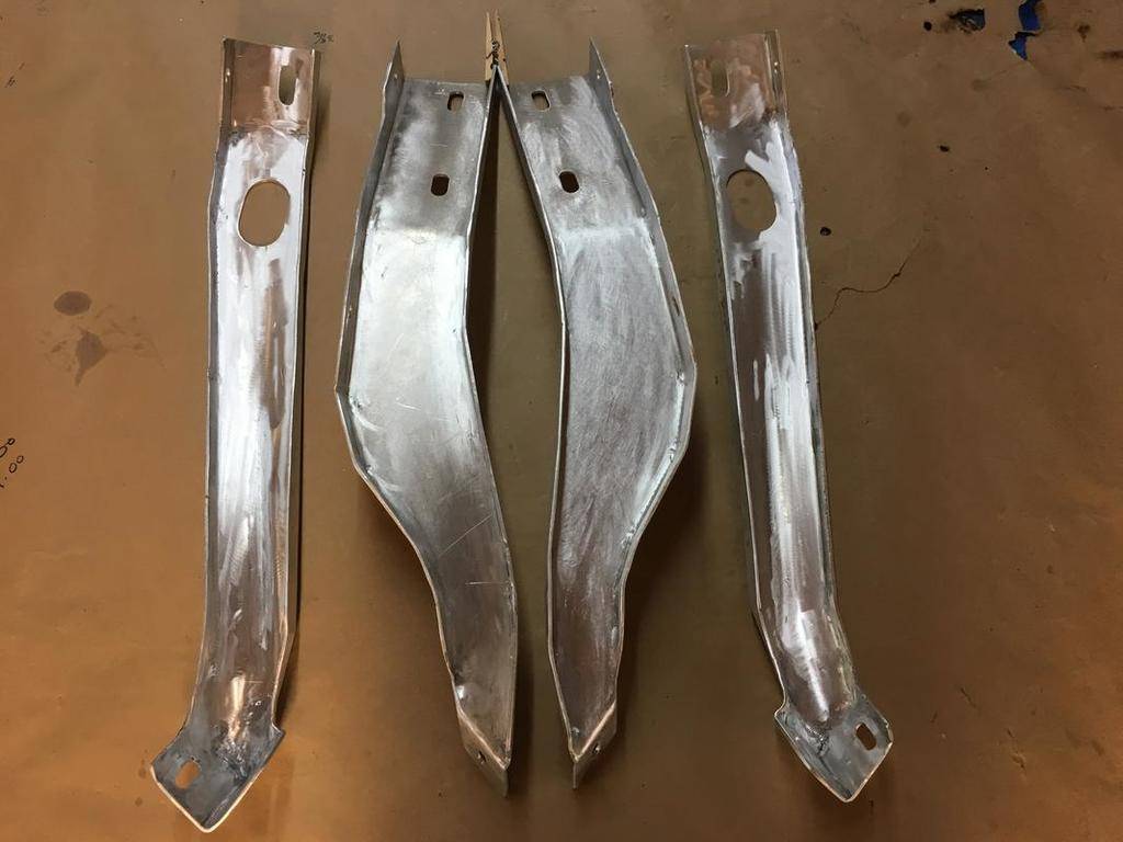

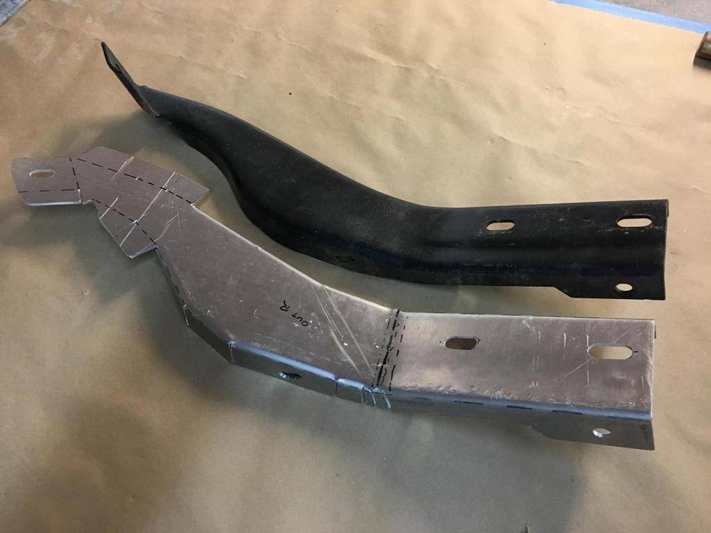

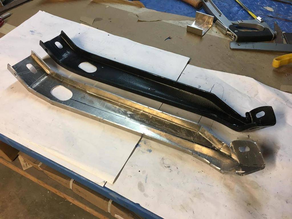

Finished the bumper mounts, time to get back to block sanding and bodywork :-(
Thanks
Pat

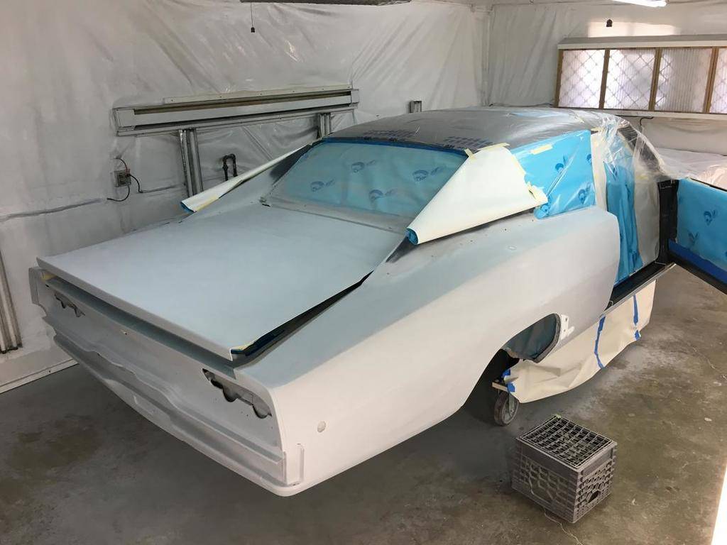

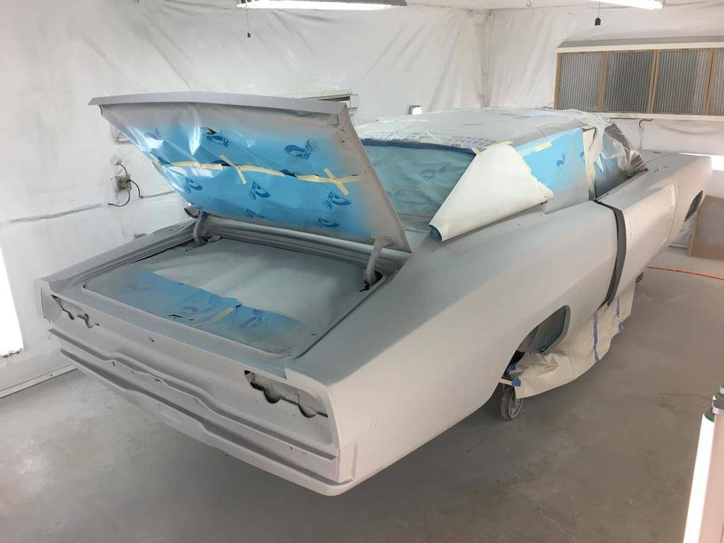

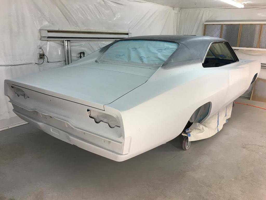

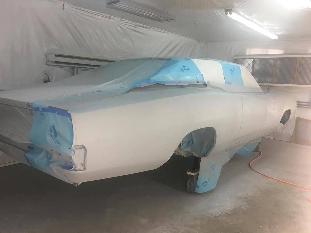

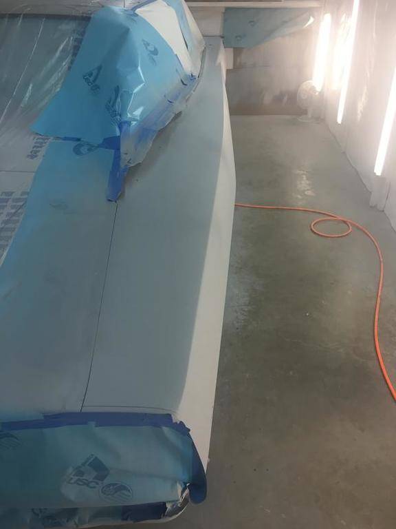

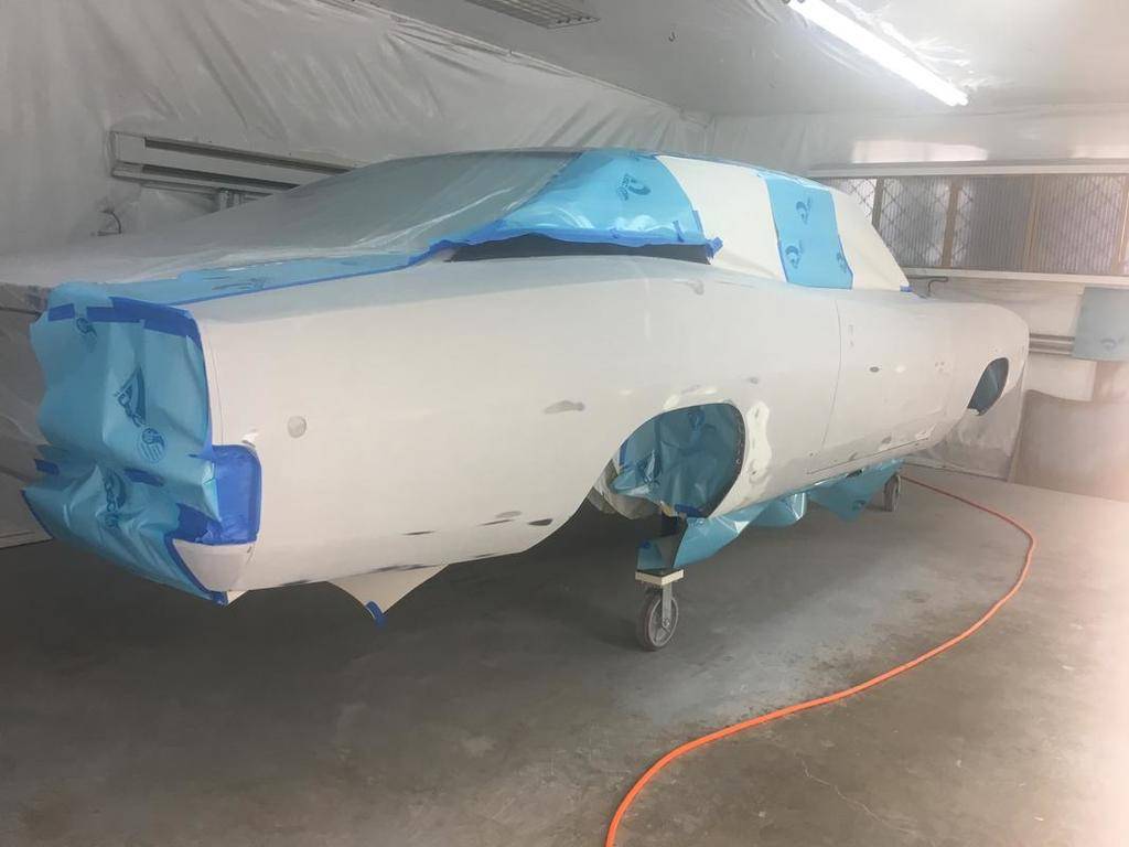

Sprayed the last coat of primer on the car and ready for the 320 blocking
Thanks
Pat

Sorry. I gots to do this. Those my lil blocking buddy are the famous last words. The song of my people.
