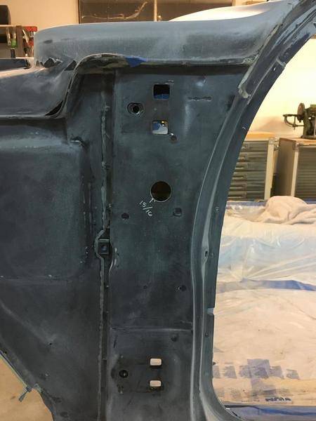

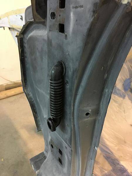

All the body panels are removed, still need to do some detail sanding in the door jams. I also drilled the holes for the power windows in the doors as well as the jams

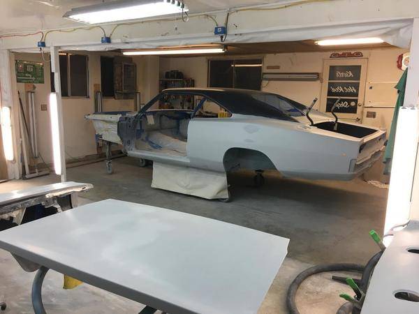

Most everything is sanded inside and out to 600 grit. Just the bottom of the hood left to do :)

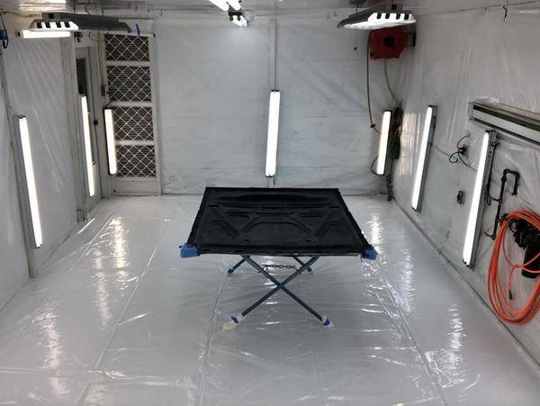

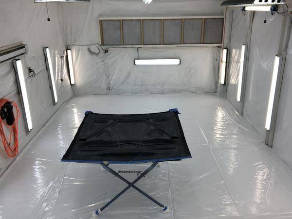

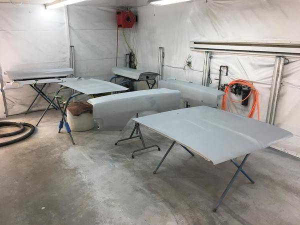

Paint booth is cleaned and ready for painting to start. I just need outside temps to be upper 40s to keep the shop temps above 65.
Thanks
Pat
. NASA clean room.

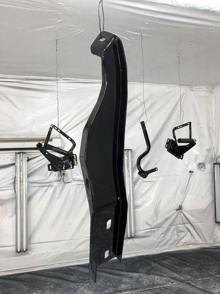

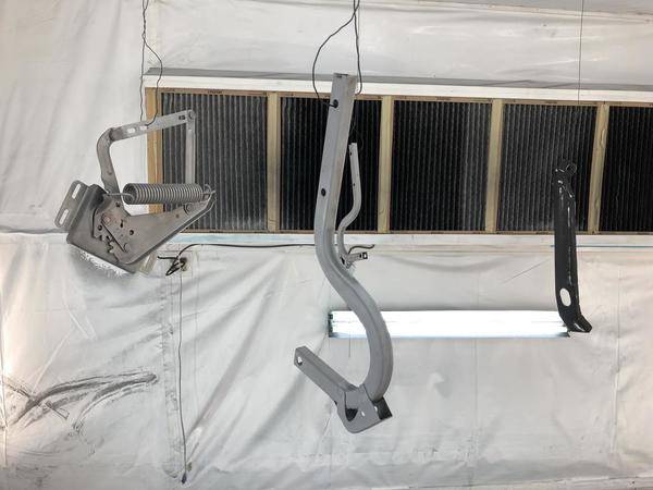

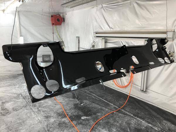

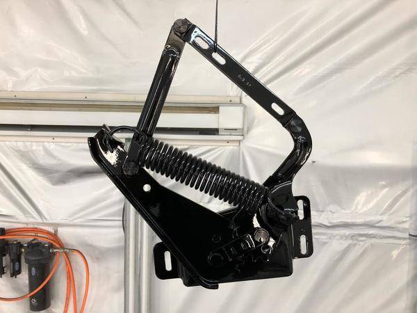

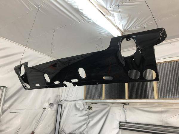

Painted 26 small parts with single stage black. Saturday planning on painting the inside of the doors and fenders with basecoat / clearcoat.
Thanks
Pat

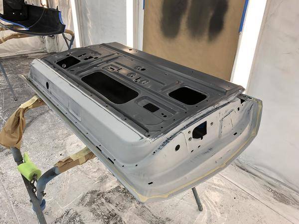

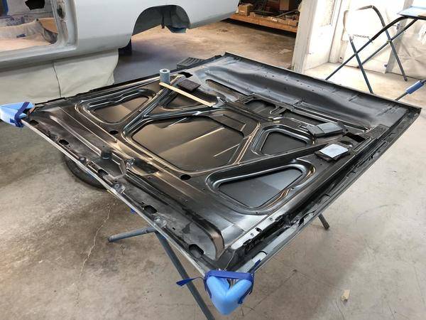

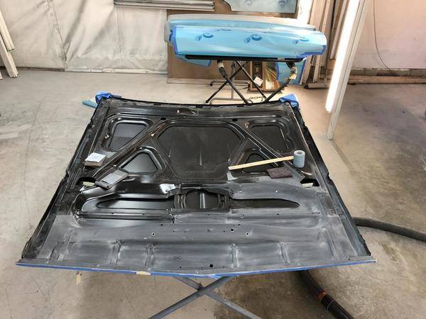

Painted the inside of the doors and fenders today.
Thanks
Pat

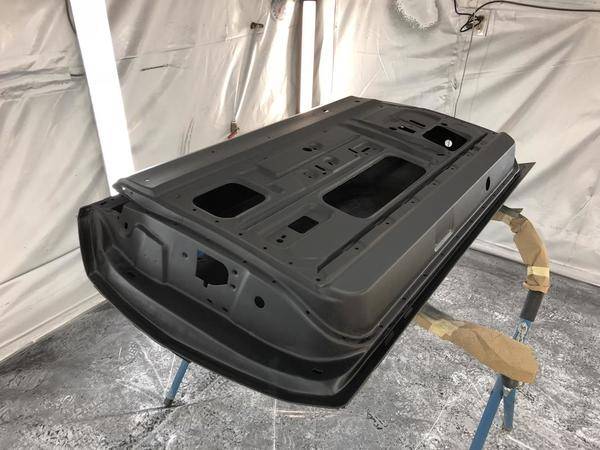

Sealer

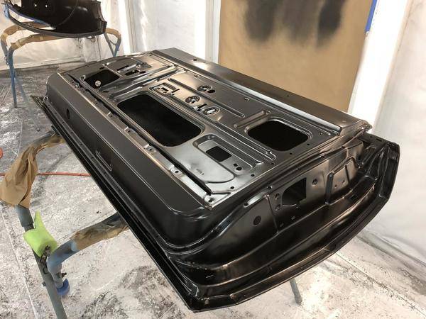

Base

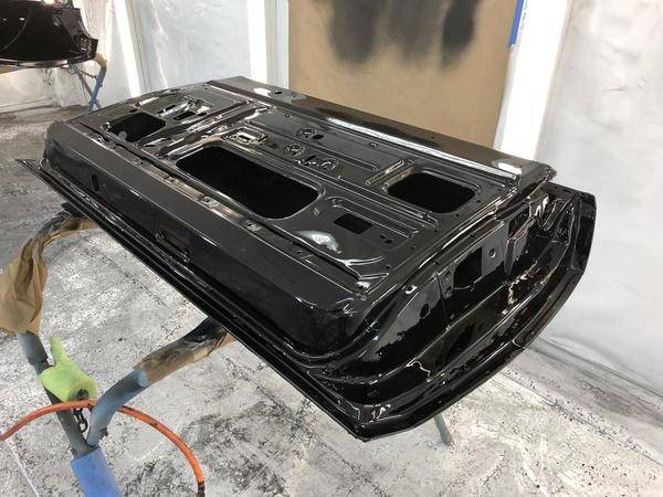

Clear
