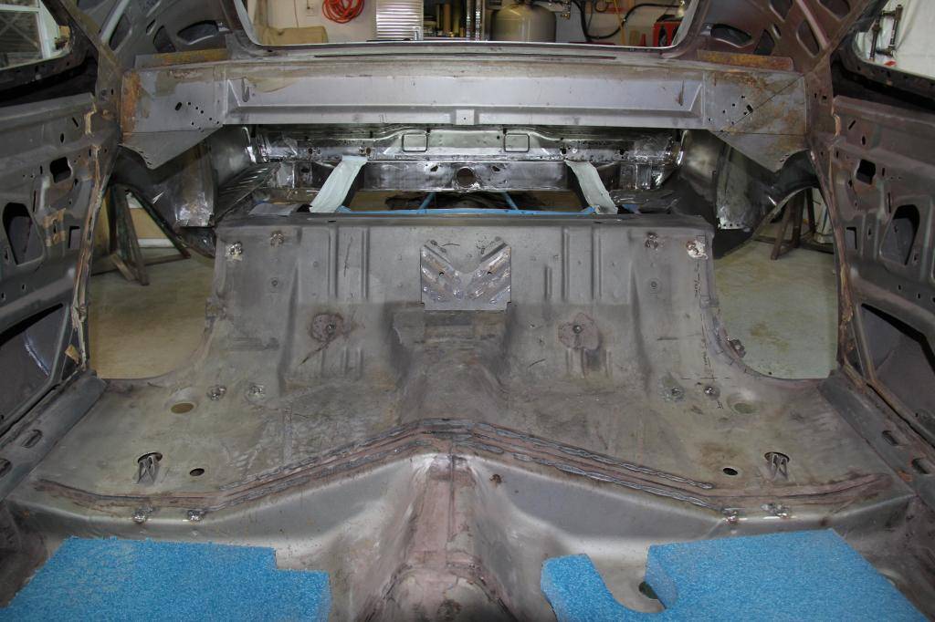

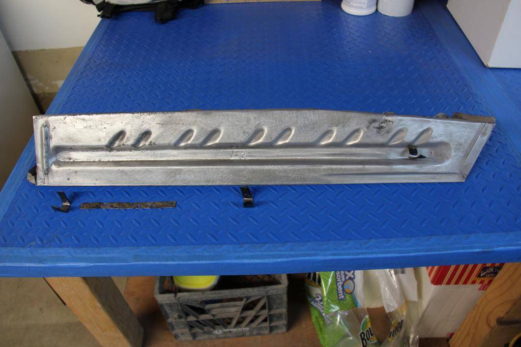

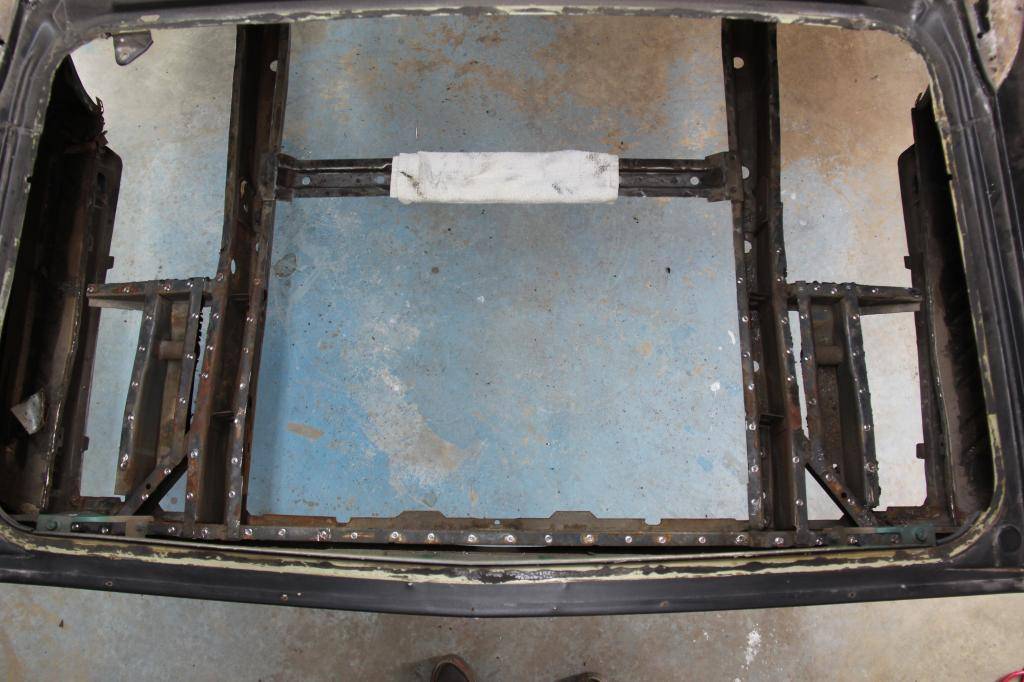

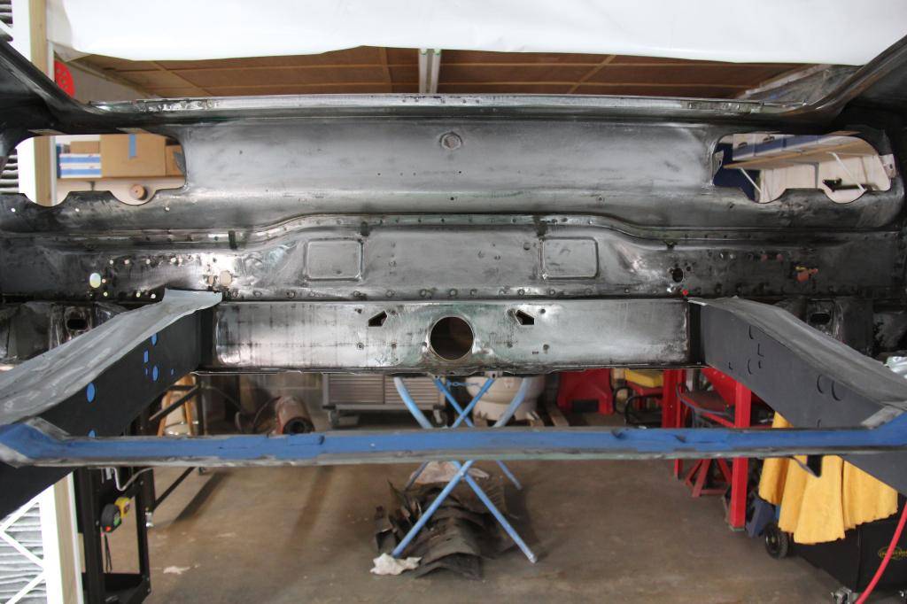

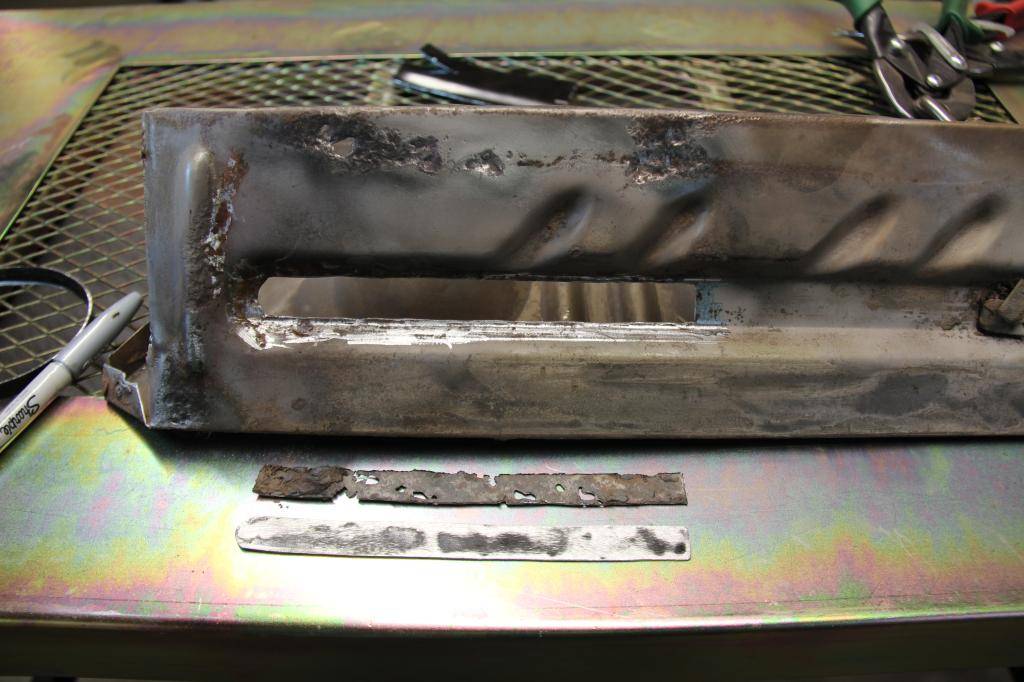

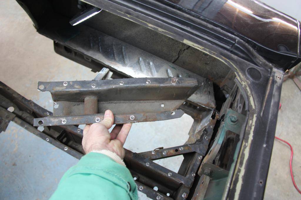

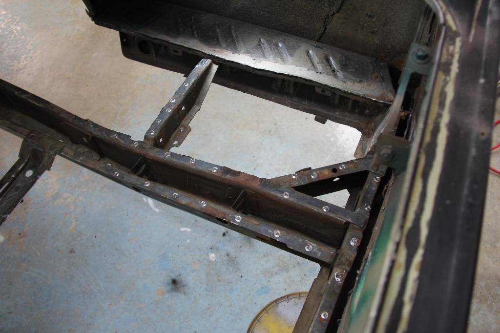

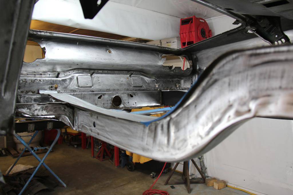

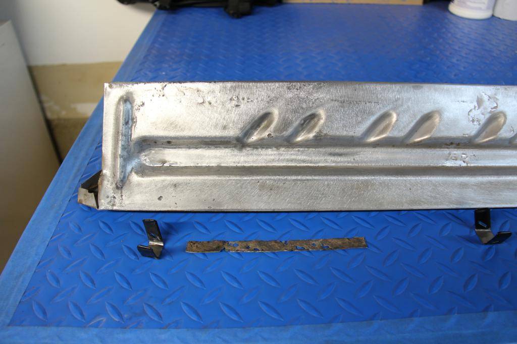

Remove what was left of the trunk floor and cut some dead weightout of the frame by removing the rear spring mounts. I also removed the leftside trunk drop to do a little rust repair that I found when the trunk floor wasremoved. I could’ve bought a new trunk drop but I enjoy saving as much of the originalsteel as I can.
Thanks
Pat

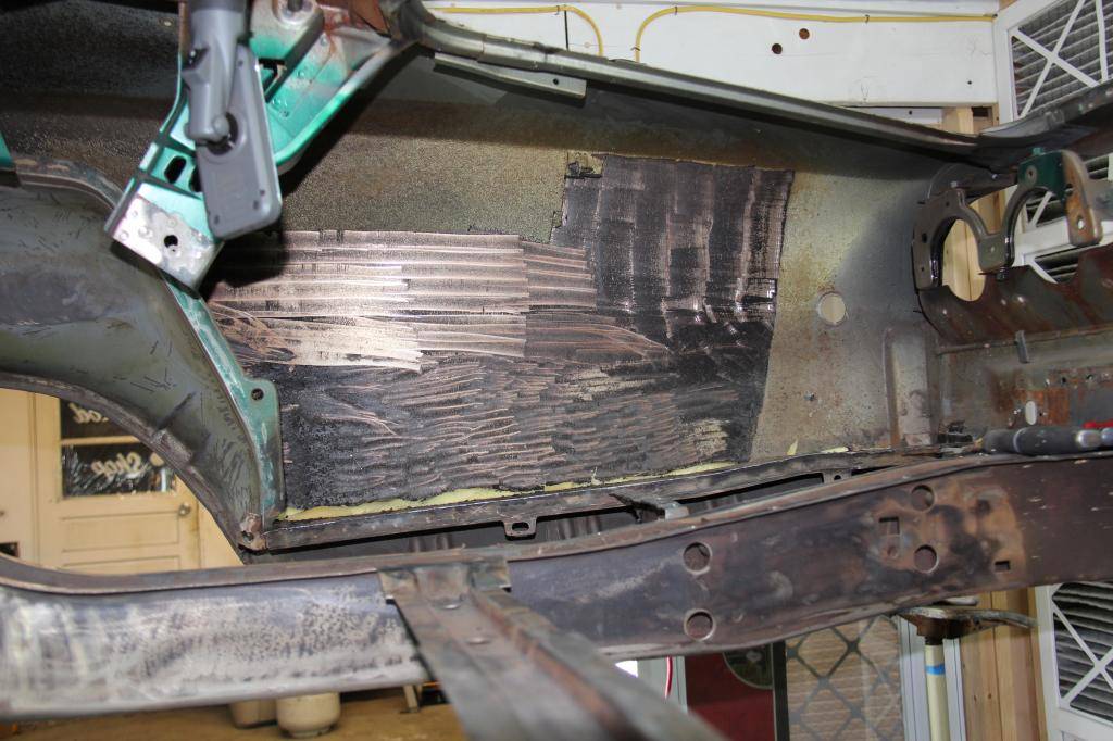

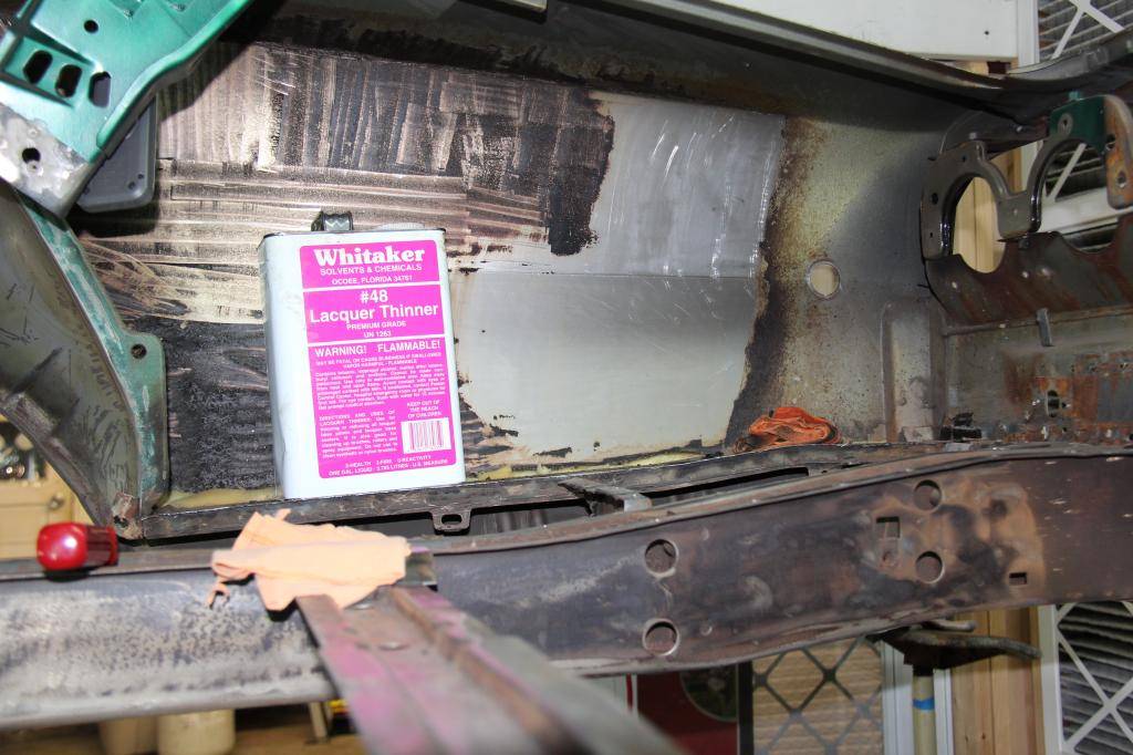

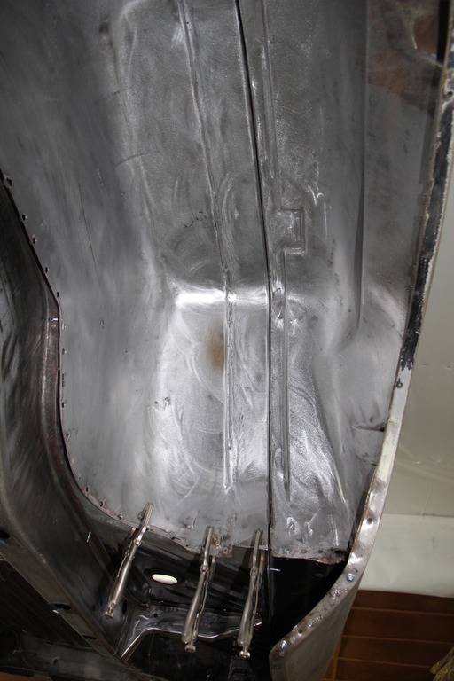

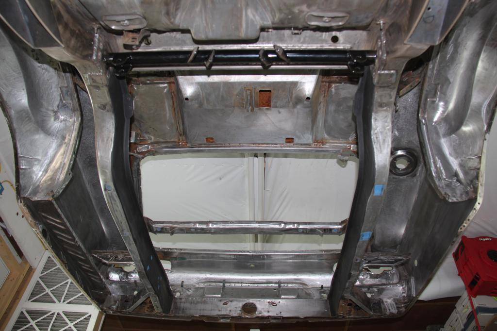

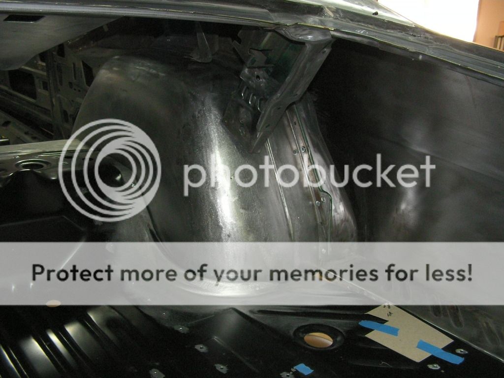

Out of town for a few days working at the Miami boat show, butgot back on the Charger this weekend. Remove most of the paint, undercoating,and surface rust in the trunk.
Thanks
Pat
Heat-gun and a putty knife and then wipe down with lacquerthinner makes quick remove of the original sound deadening.

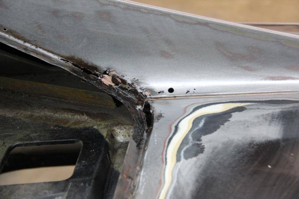

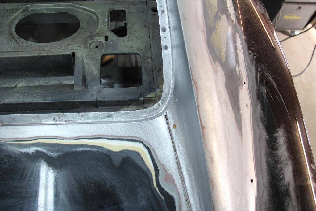

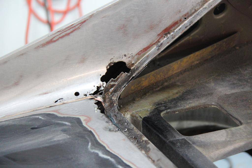

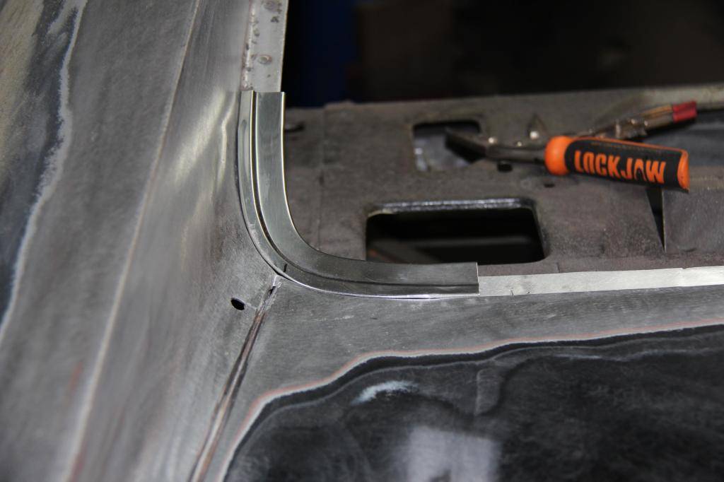

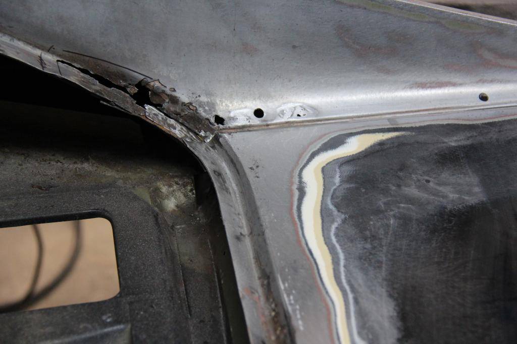

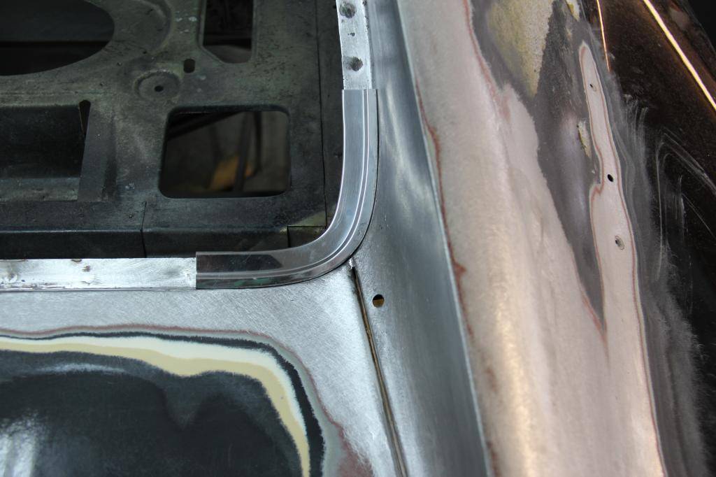

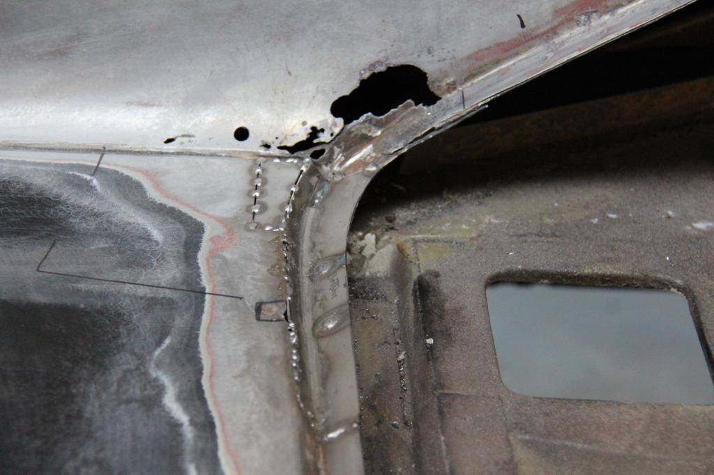

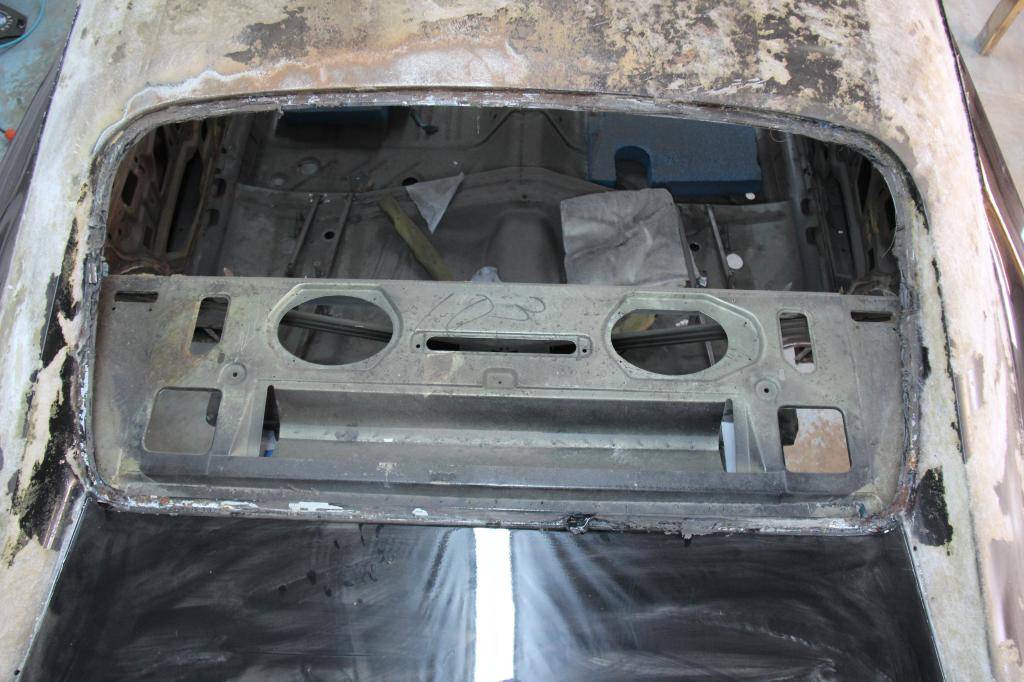

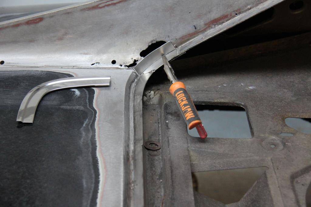

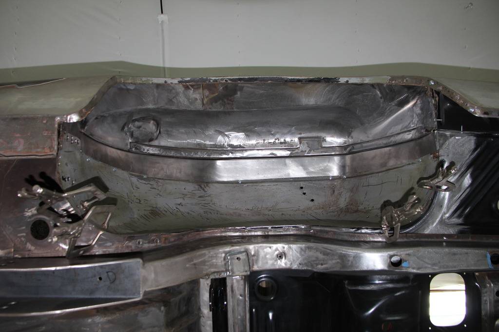

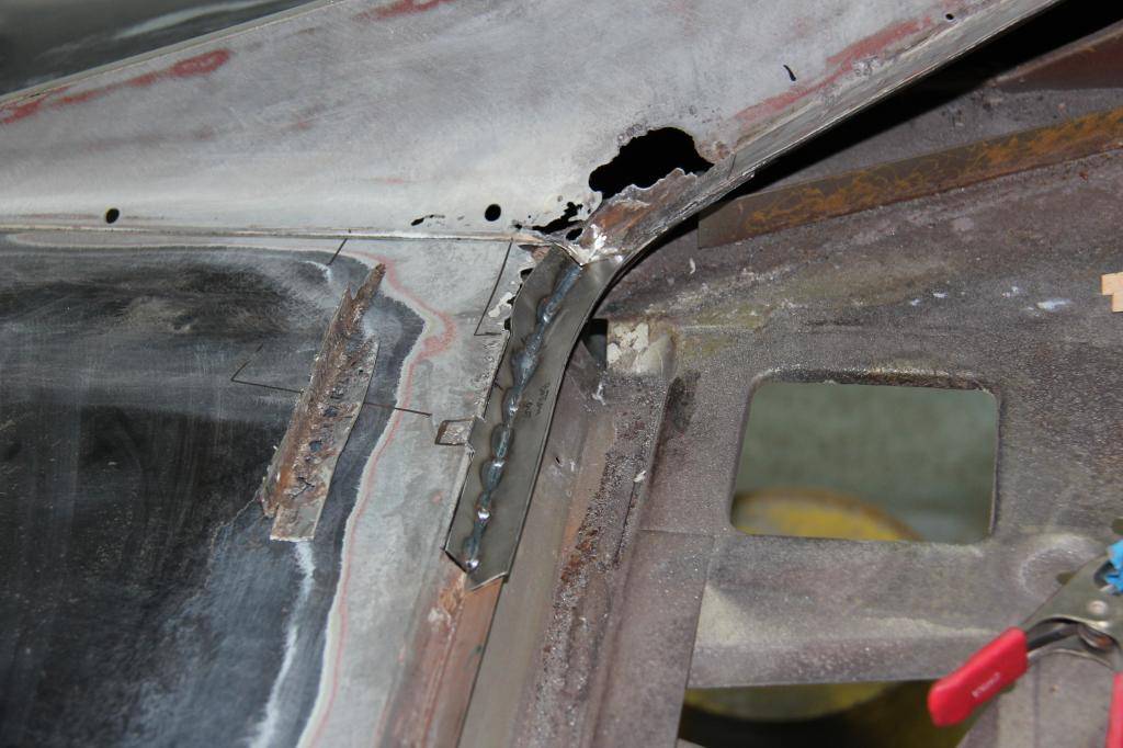

Before installing the trunk floor I started on theback window as it would be easier to clean up the welds under the window framewithout the trunk floor.

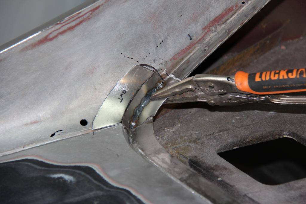

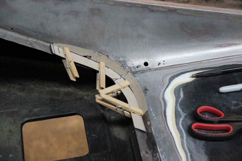

Made a few template of the corner before cutting therust out as to match the shape.
Welded in the lower half of the corner before cutting outthe top half to help hold the shape.

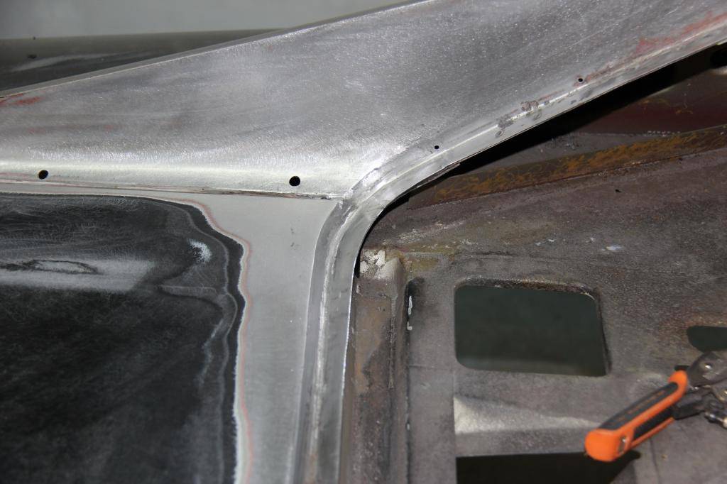

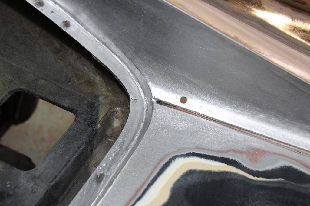

Use the trim to confirm the shape as I tacked weldedthe new metal in.
One corner done and one to go.

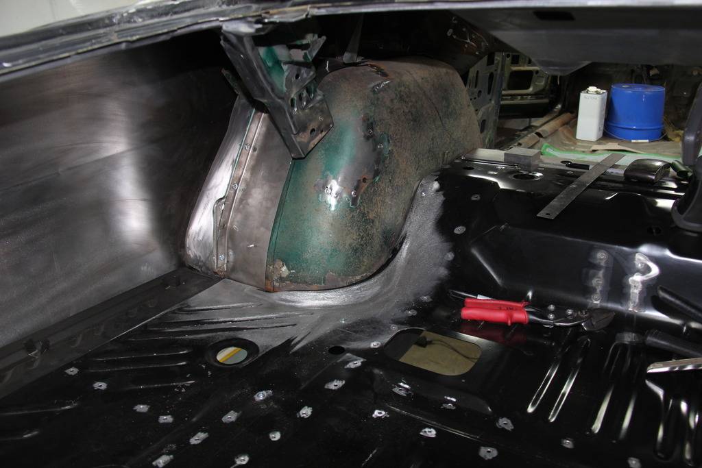

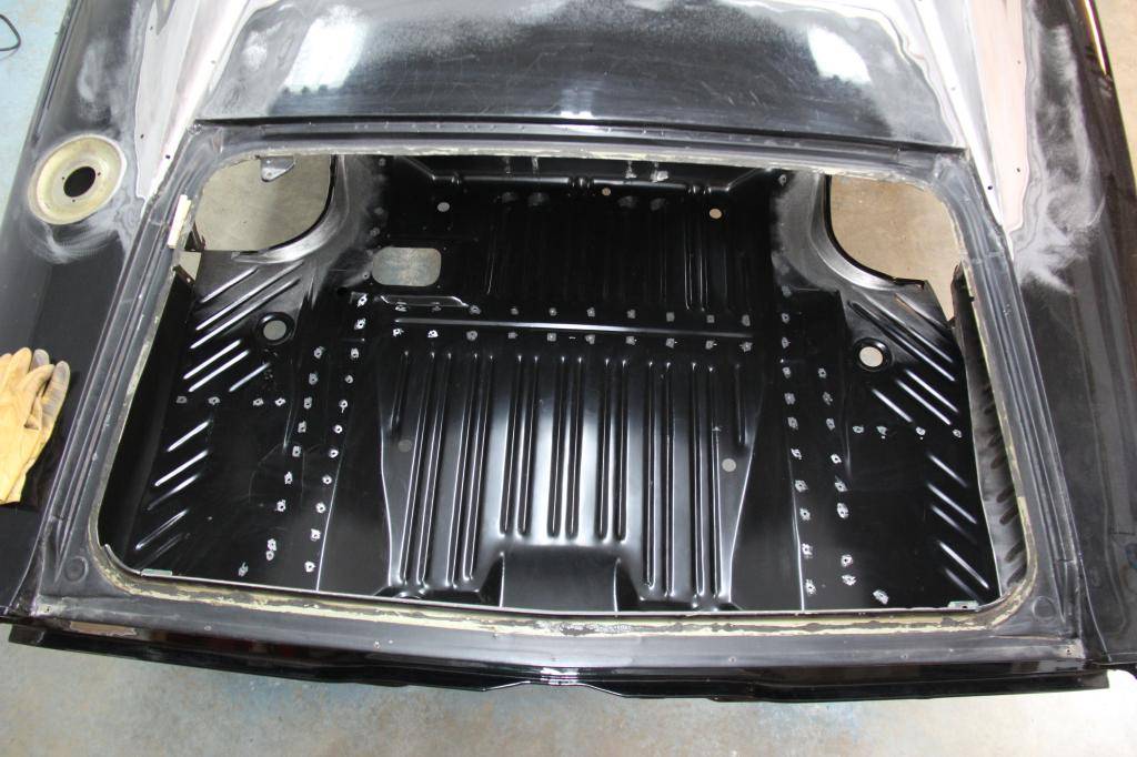

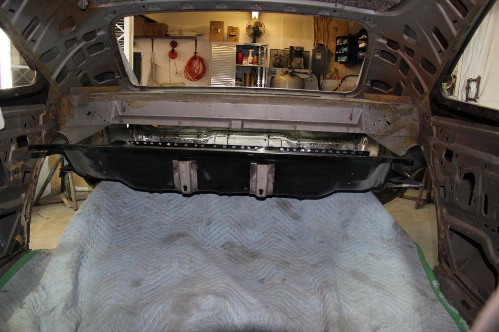

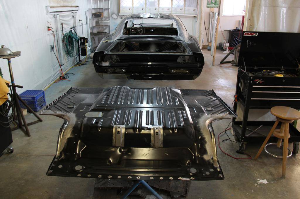

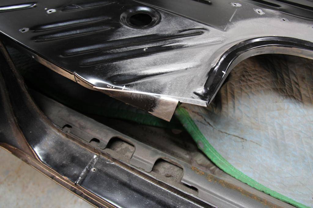

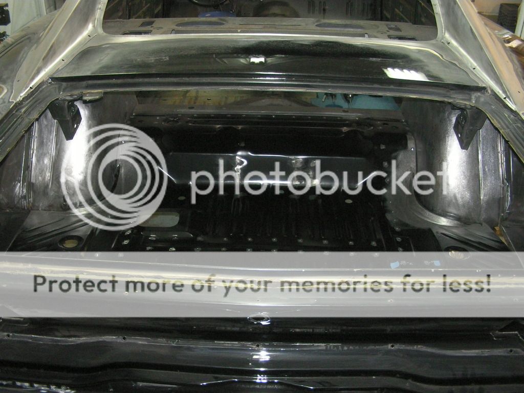

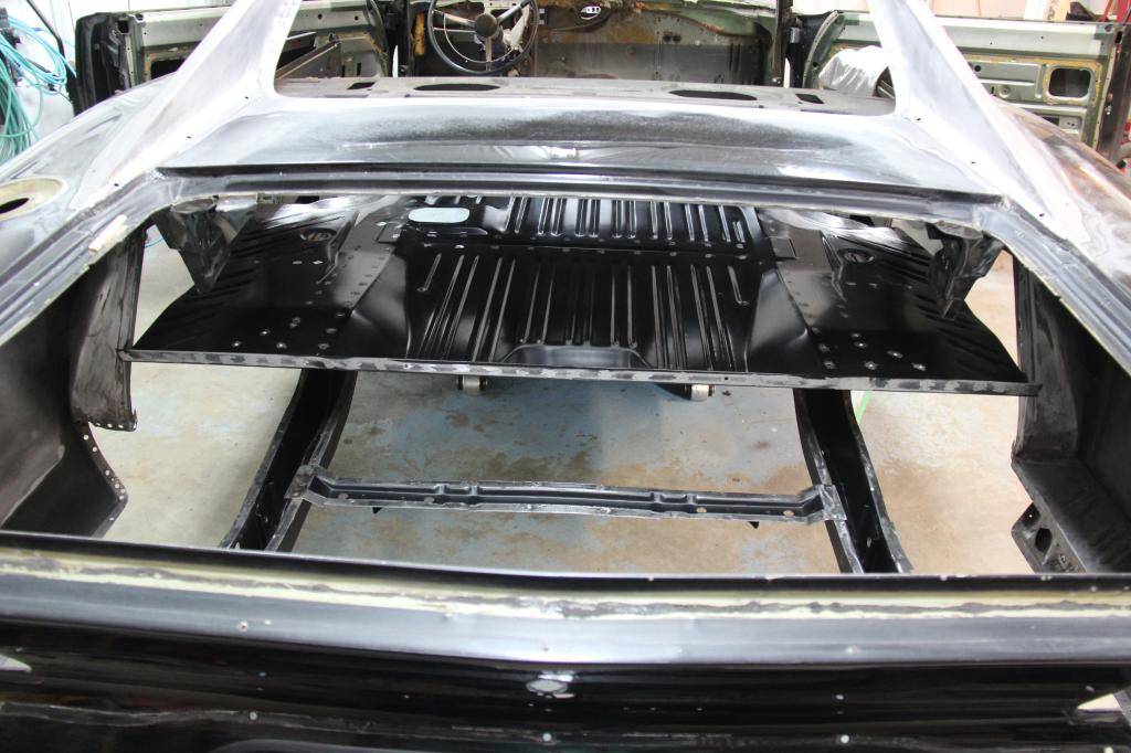

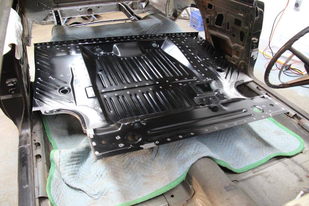

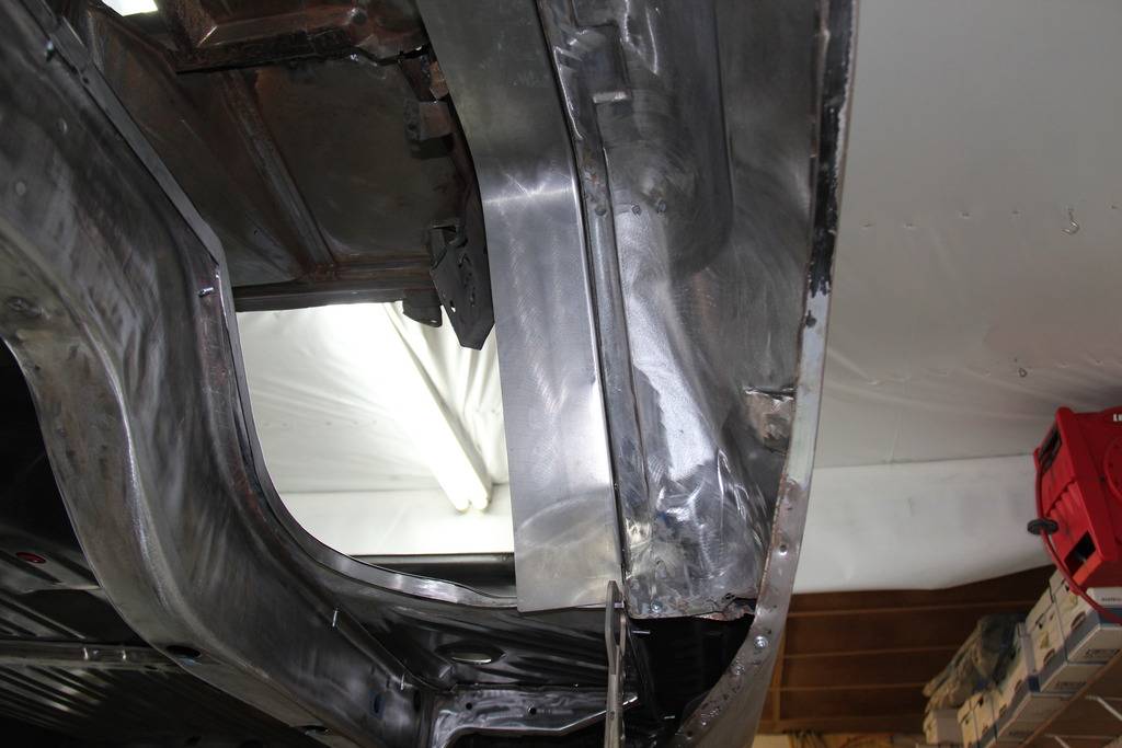

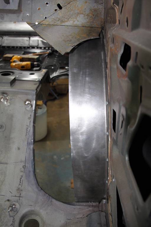

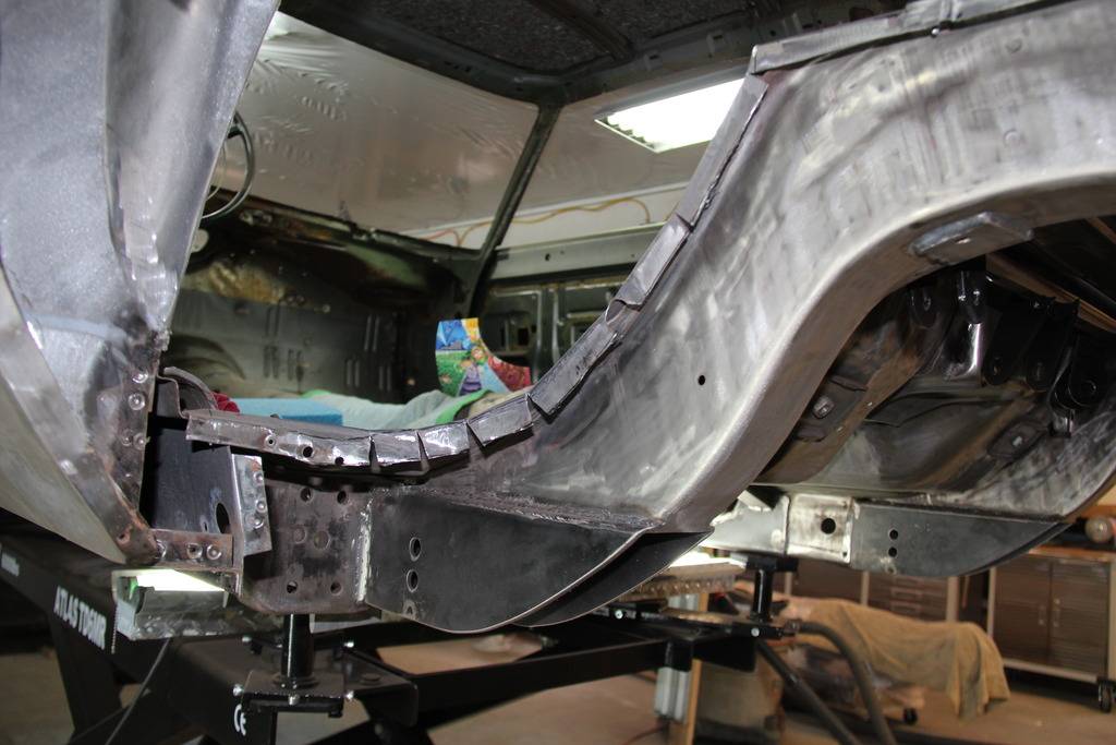

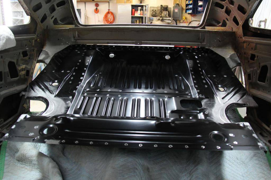

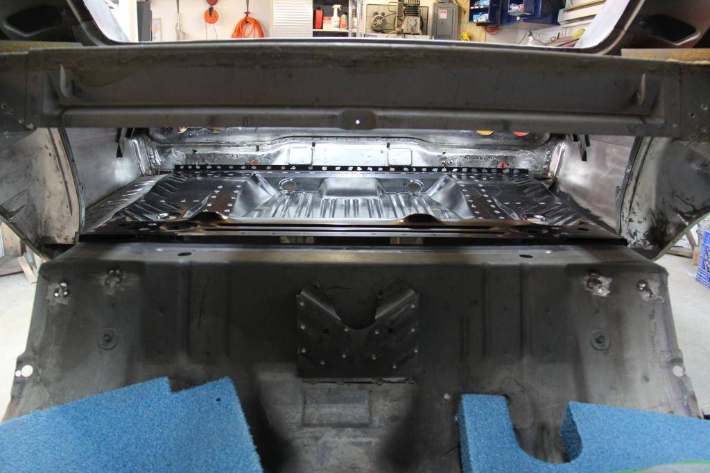

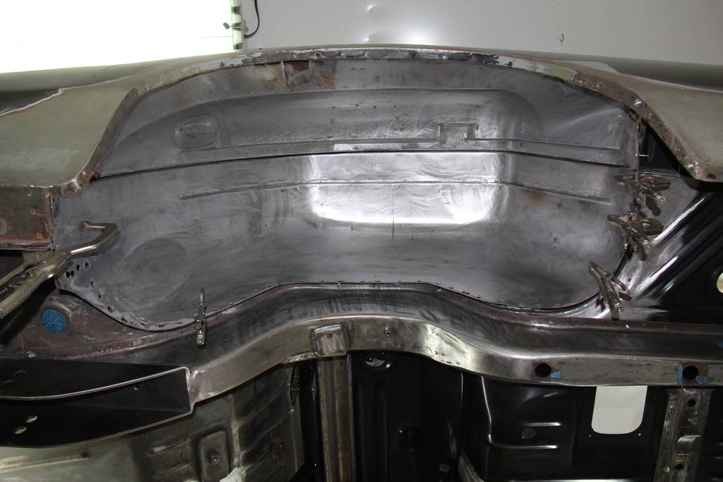

Test fit the trunk floor today so I can measure for the innerwheel wells. With the back seat cross braces removed and upper corners slightlybent up. The only other modification need was to bend the right side aft wheelwell corner which I was planning on as I didn’t weld that corner on yet inanticipation to a tight fit at the widest point of the trunk floor.

Very cool! Thanks for the back window repair pics. I'm gonna be tackling one of those soon.

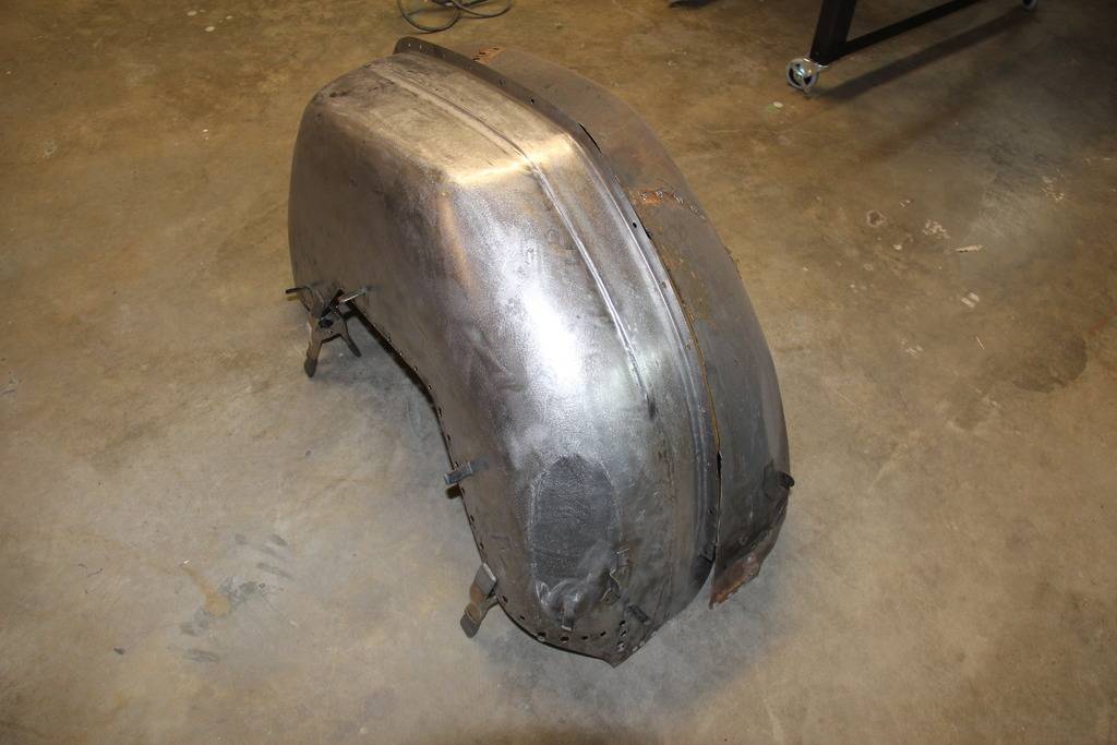

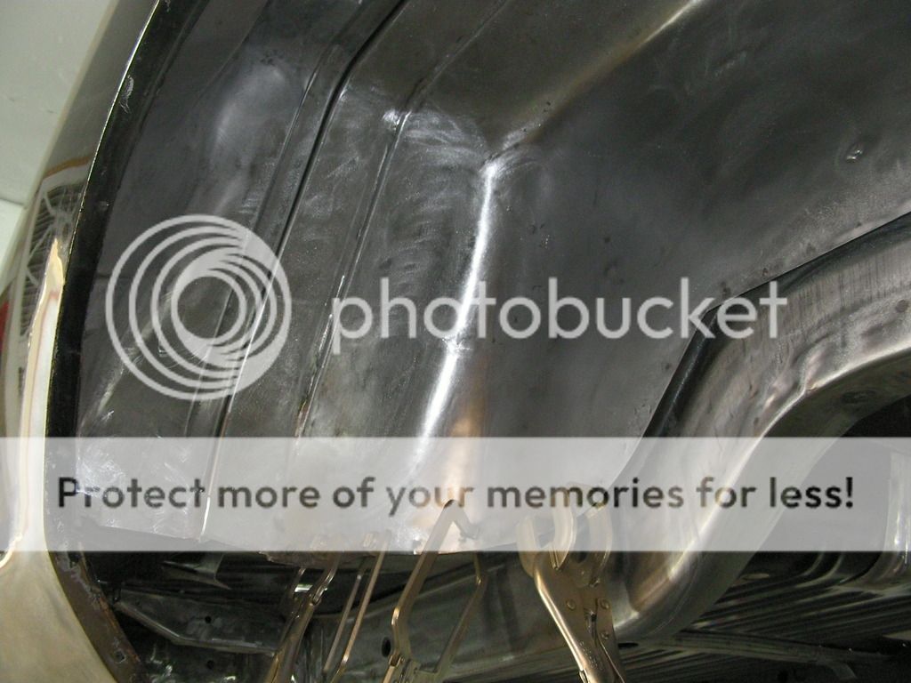

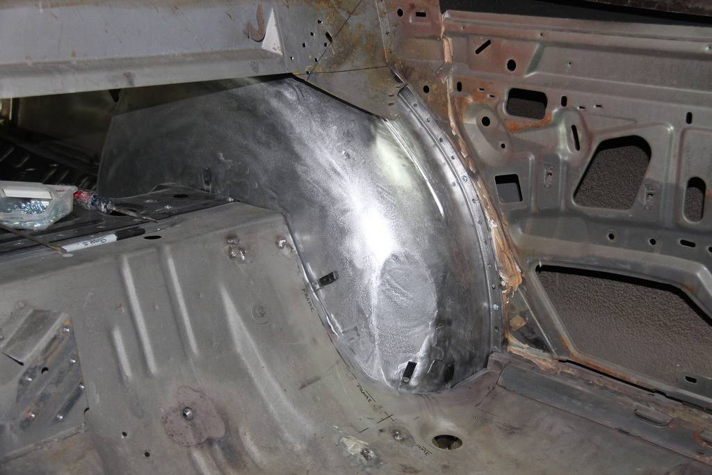

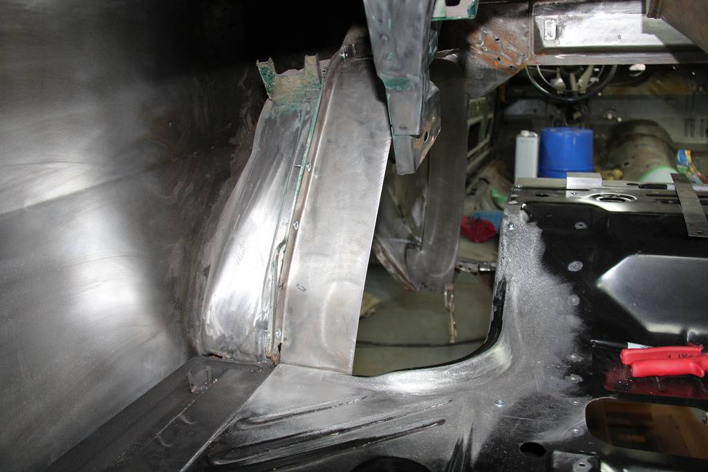

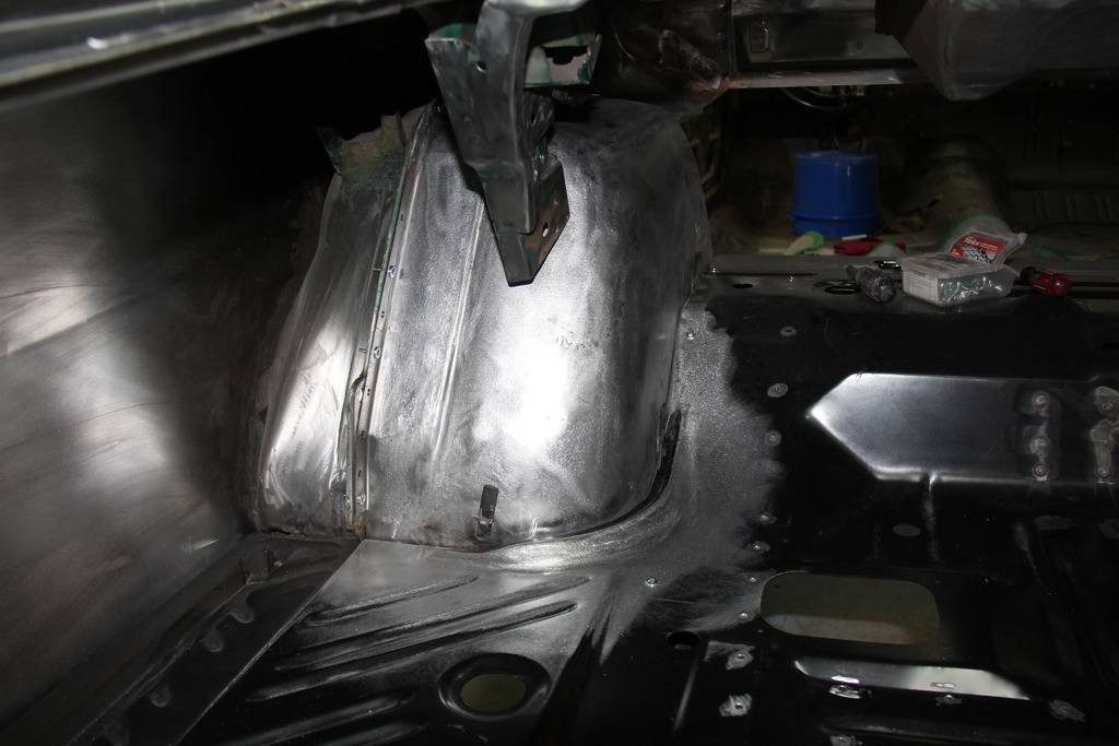

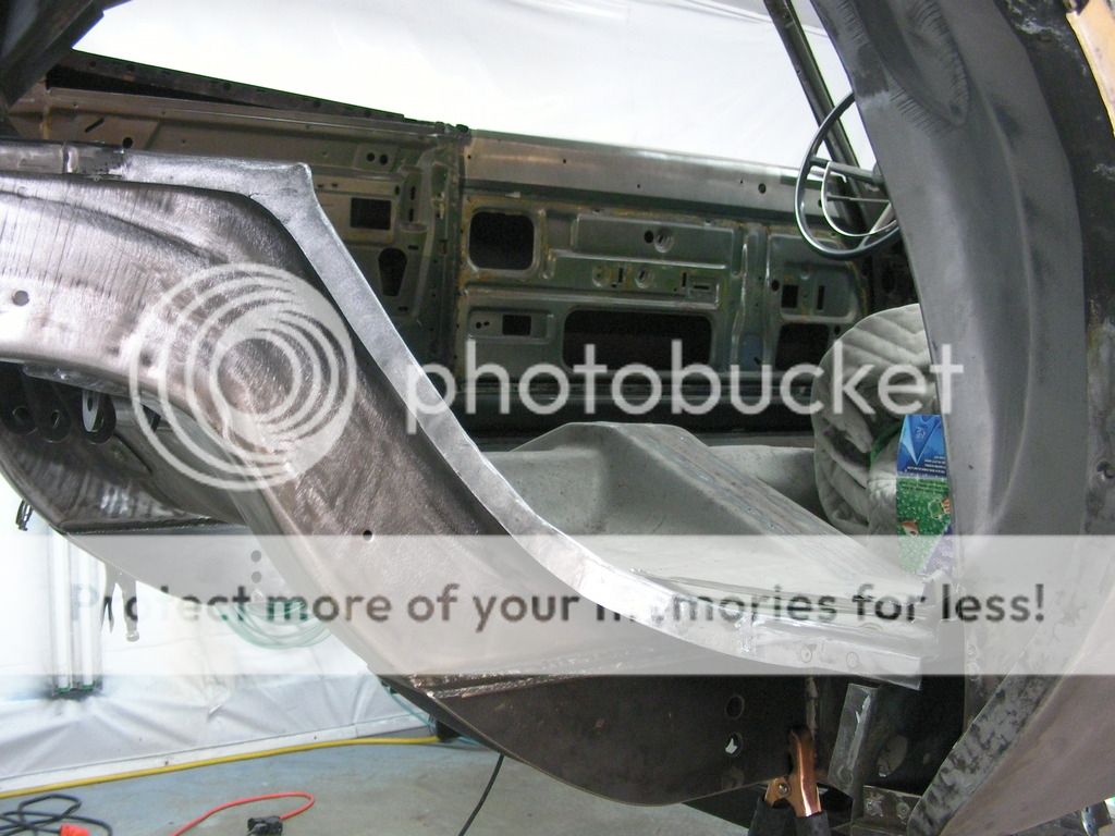

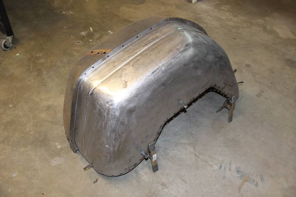

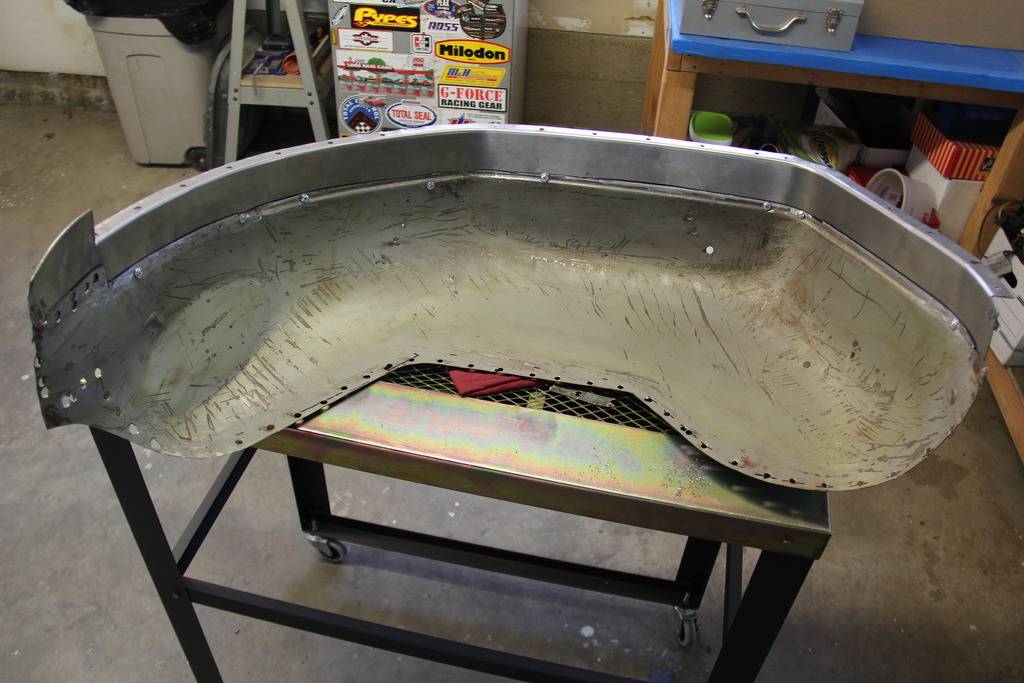

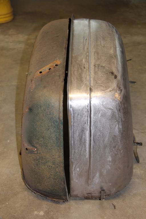

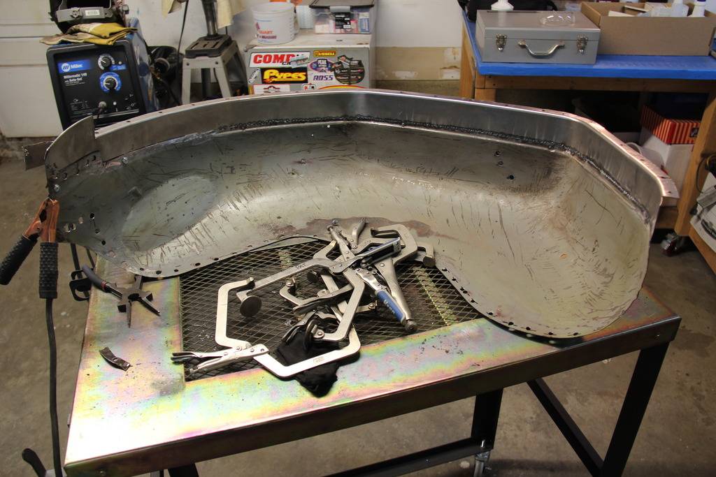

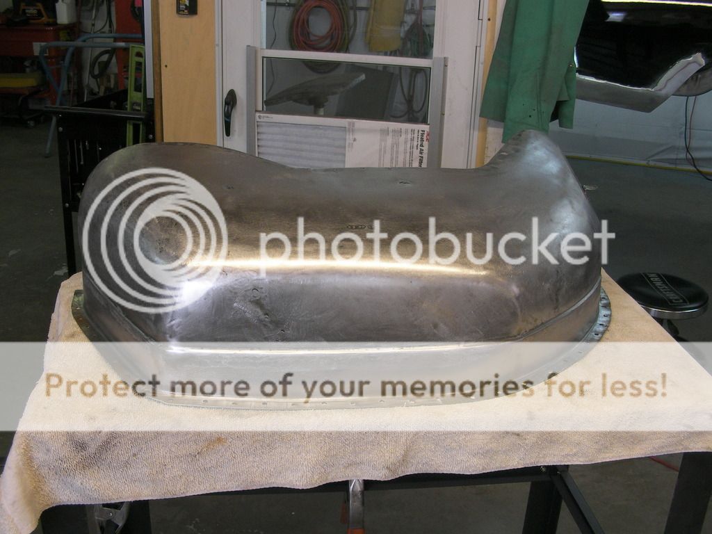

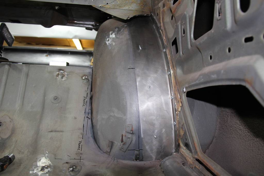

Fit and butt welded the US Car Tool mini tub kit toone of the wheel wells. The left side fit great and I’ll let you how the rightside works soon. Would be nice if someone made wide stock looking wheel well likethey have for GM & Ford cars!
I screwed on the extension to the outer wheel well. Theshape of the kit is spot on!
With the extension in place I screwed the inter wheelwell on so I could remove it as one part to weld it together.
Added about 2 ½” to the wheel well, a lot of work fora 335 tire but it will look cool!

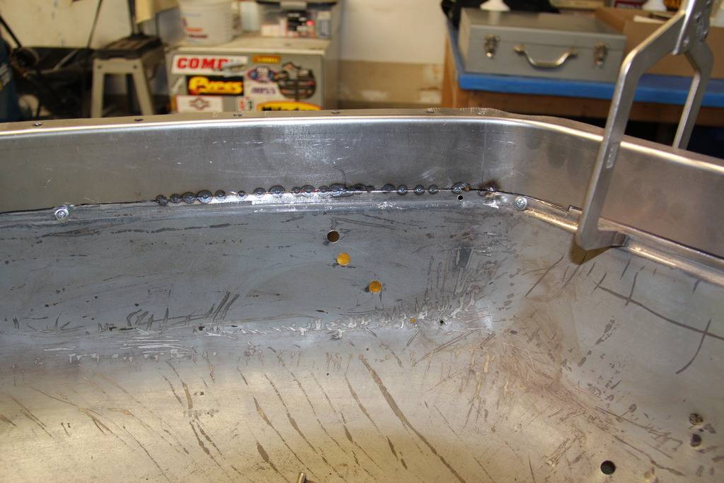

Are you TIG welding? Sorry if it's a dumb question - I'm still learning about welding and have a long way to go. The welds look very small so it didn't look to me like MIG...
Nice work, as always.
No I used a Mig.

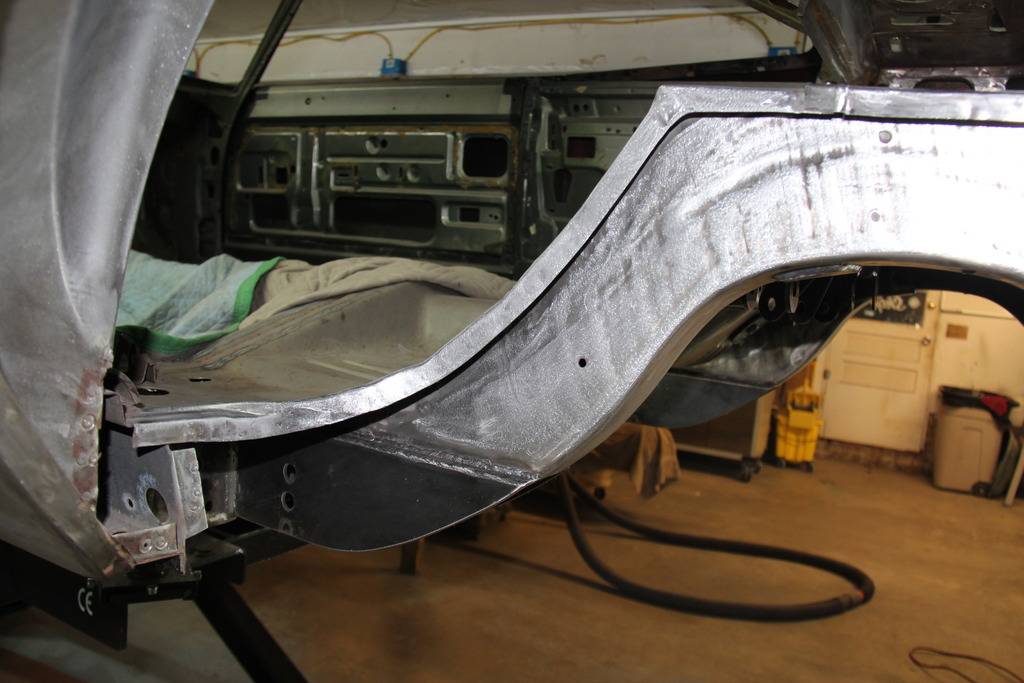

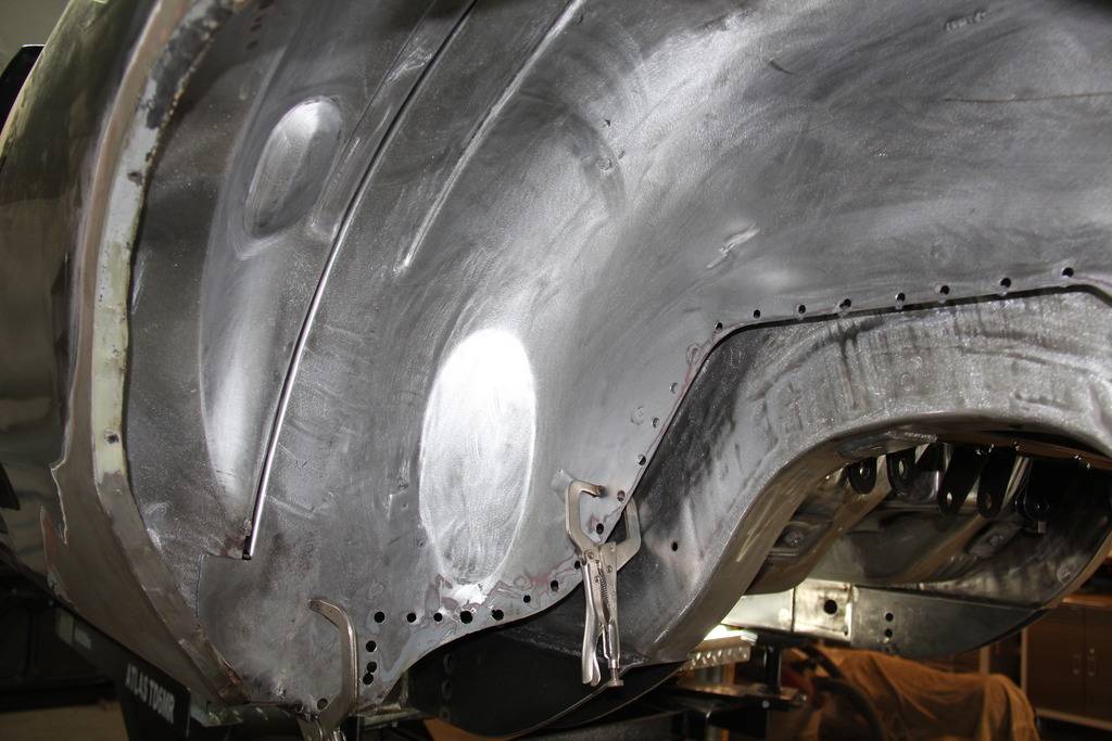

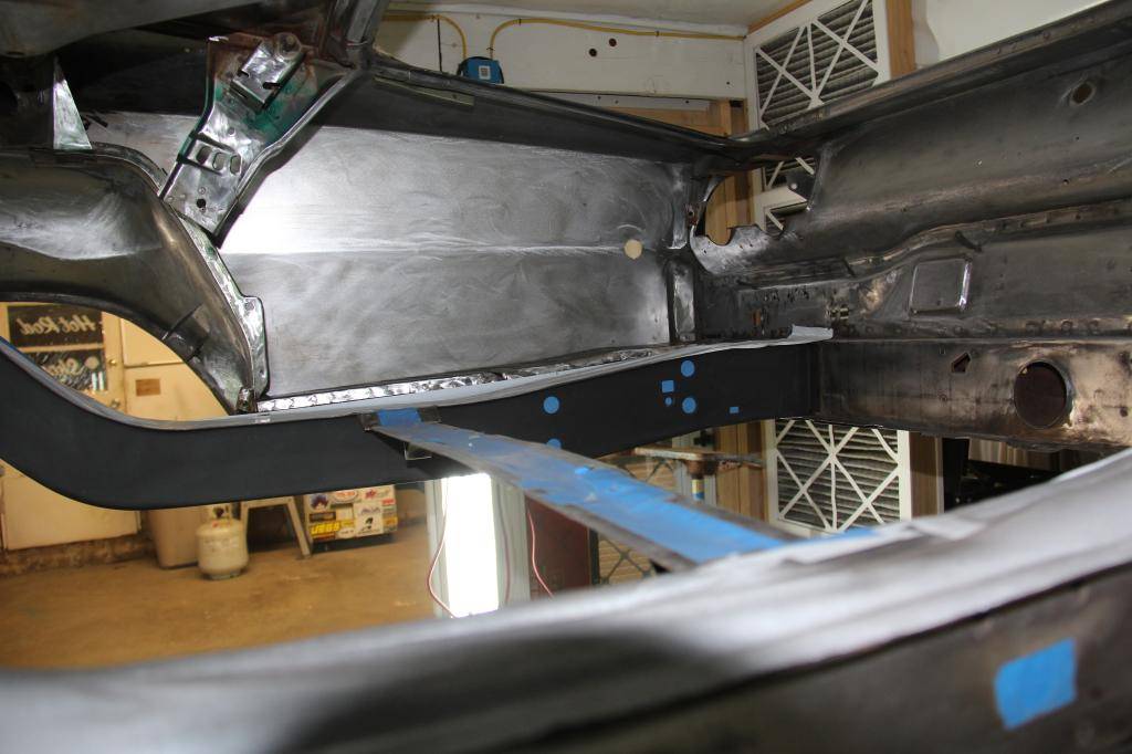

Finished the front wheel well floor flange and test fit theleft wheel tub. Now on to the right side.

Very nice work, I especially like the rear window lowers turn out, looks better that new.
