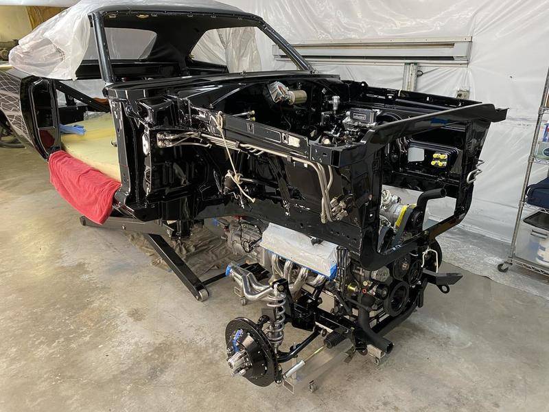

Modern Bullitt build
IMO to date there has never been a more stylish beautiful car built. And you have taken it to the next level sir.
This car, when done, should go to SEMA or some other nationally recognized show. I think it would do incredibly well. It is an amazing build!

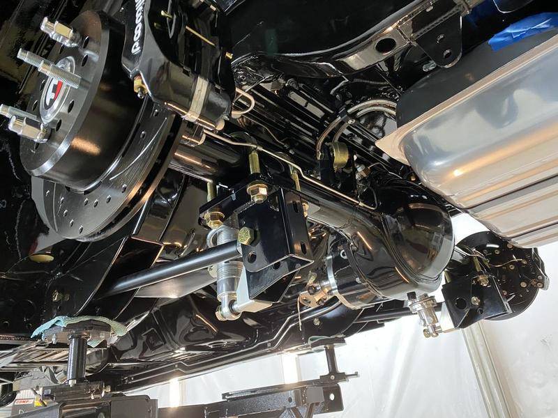

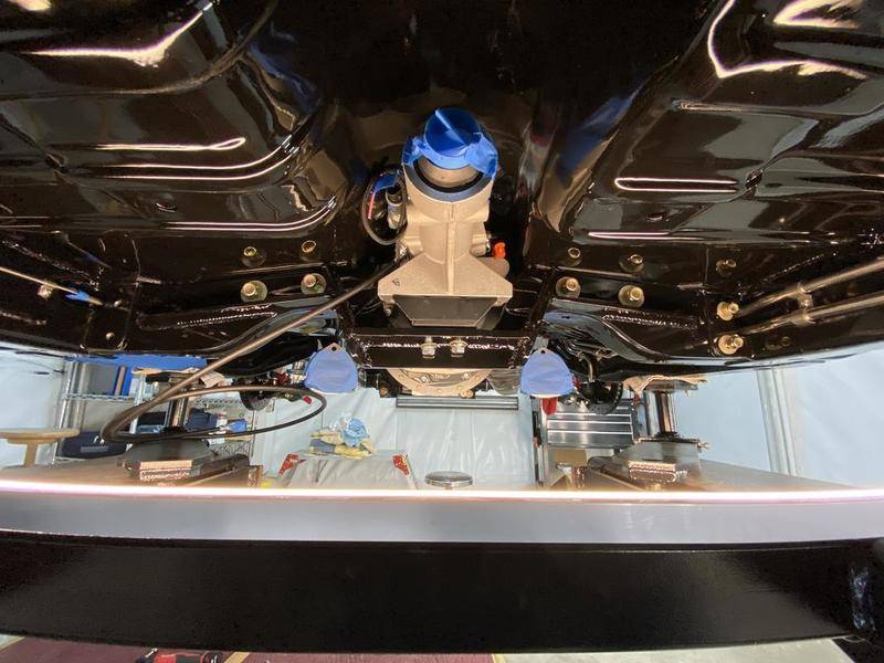

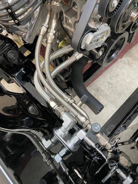

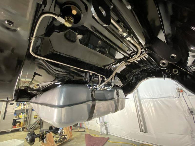

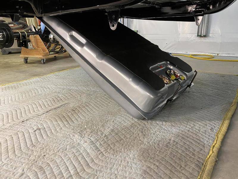

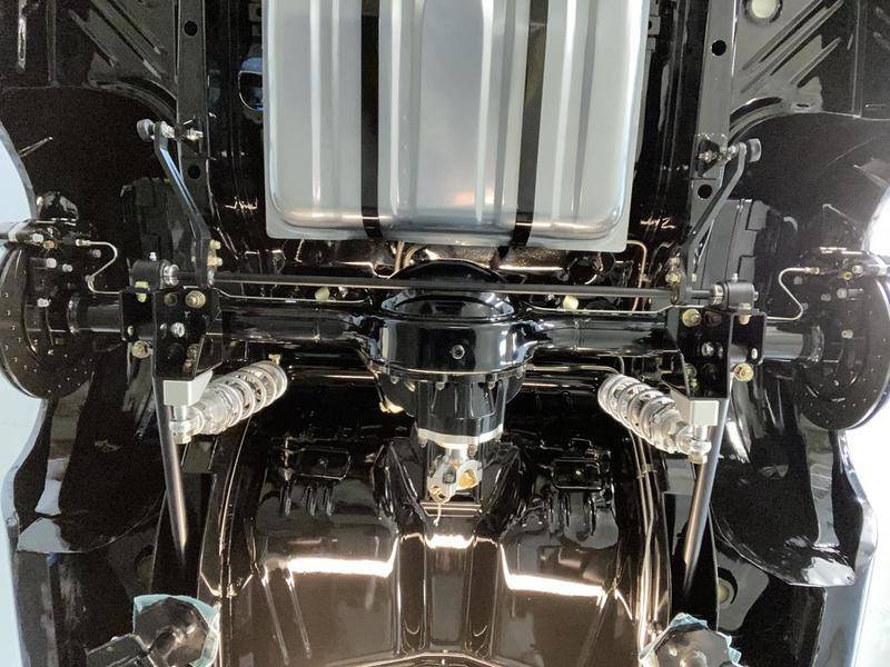

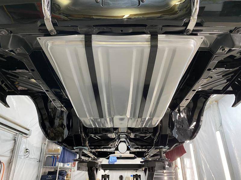

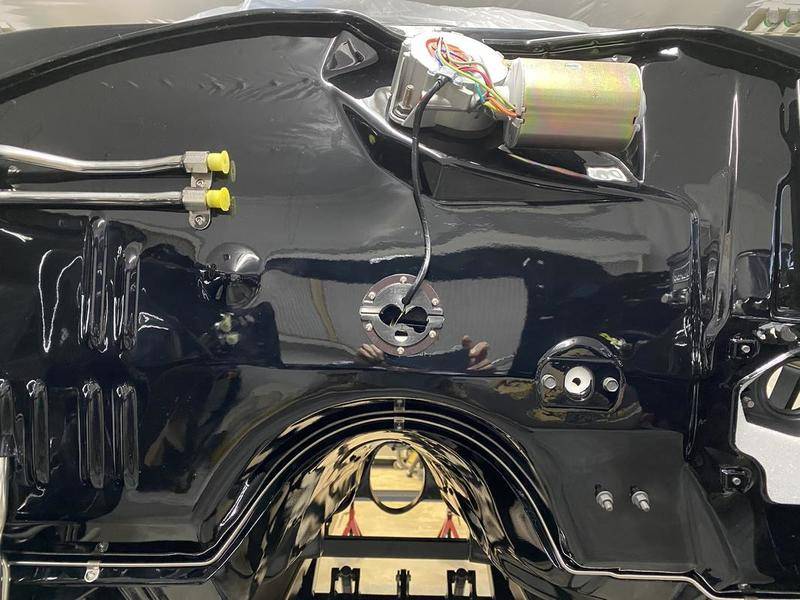

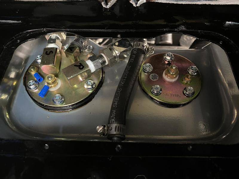

Fuel tank along with supply and return fuel lines are install!

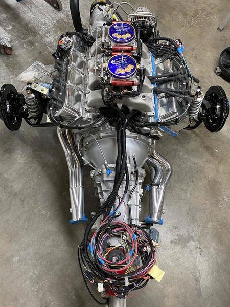

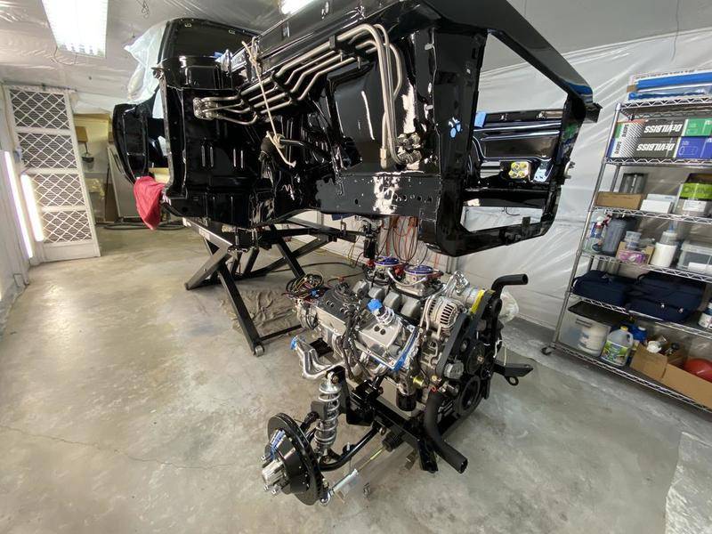

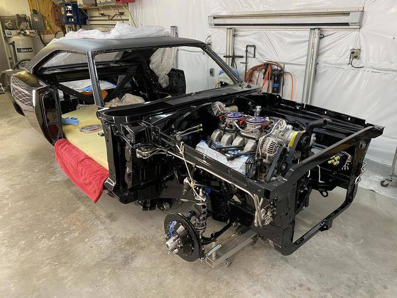

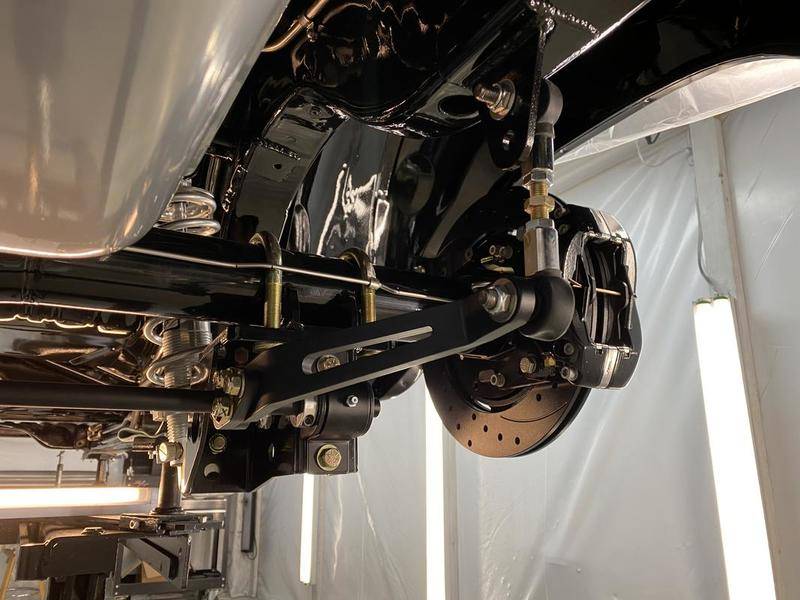

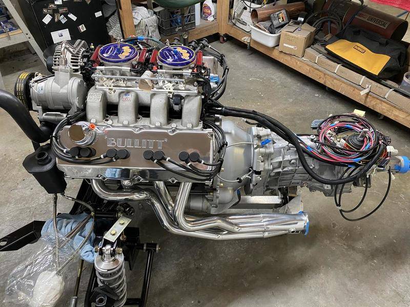

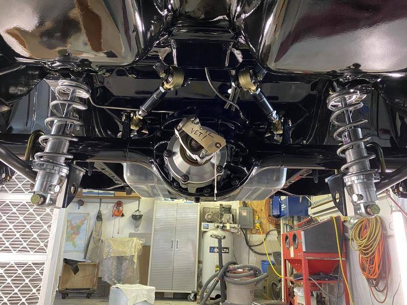

I also installed the rear. Shooting to put the engine transmission & front suspension in the car over the weekend.
Thanks
Pat
That's a thing of beauty!!! Excellent job

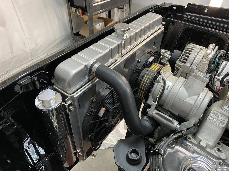

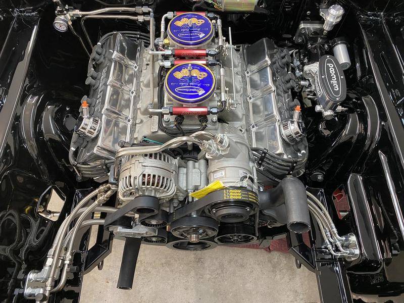

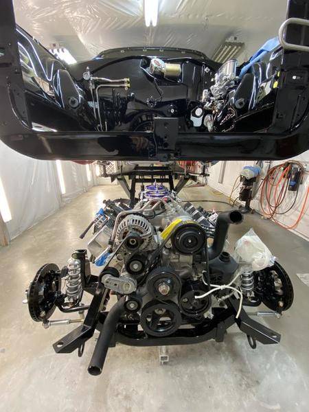

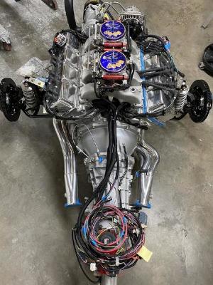

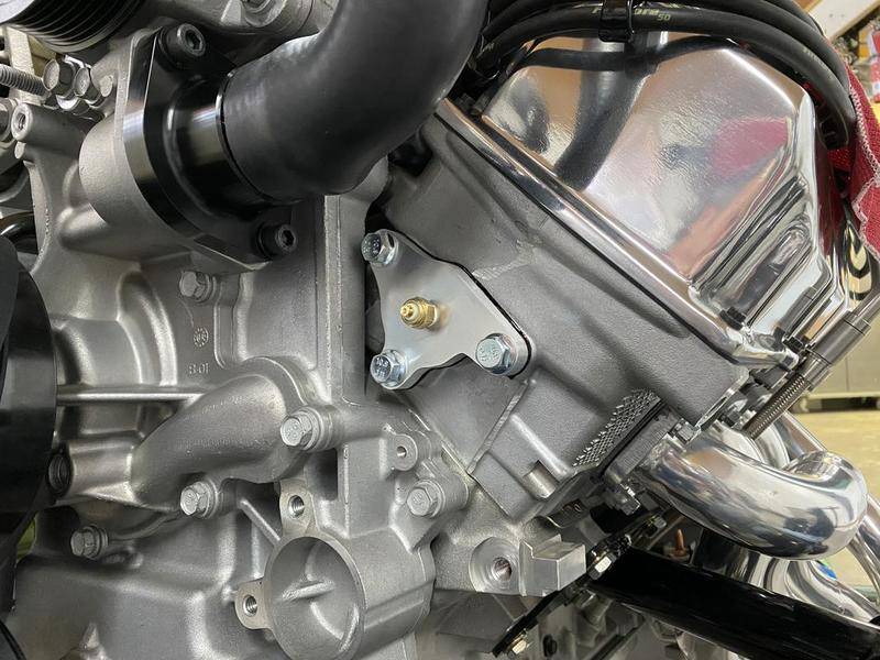

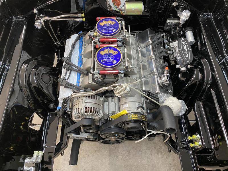

Only 1 spot for a temperature sender on this gen3 Hemi, and I need two, 1 for the fuel injection and 1 for the gauge. I had to remove a freeze plug and make a plate that I could drill for an additional temperature sender.

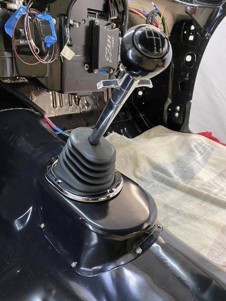

I also have all of the wiring set and ready to enter and pass through the firewall through a split grommet. This will allow all of the plug-in connectors to pass through a single 2 1/4” hole hidden just above the transmission.
Thanks
Pat

The thermostat housing can be drilled/tapped, weld a bung into the radiator tank but your idea should work just fine.
