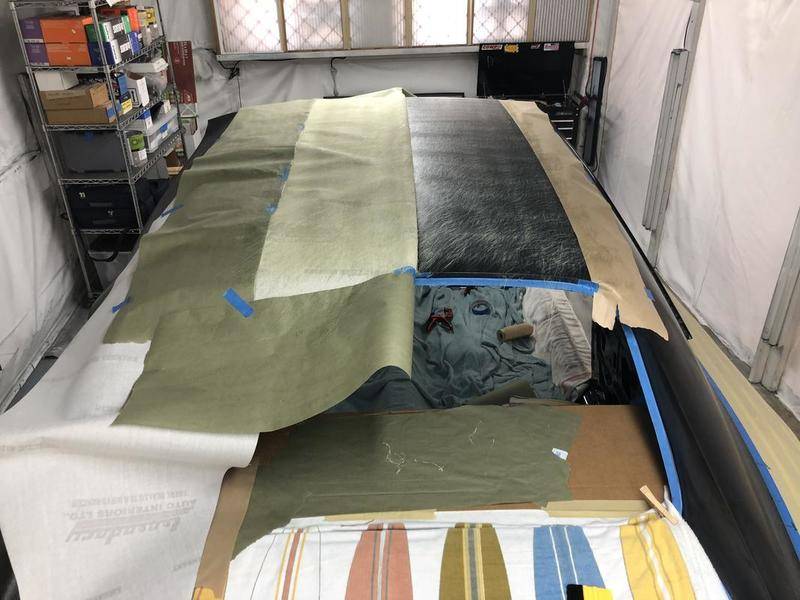

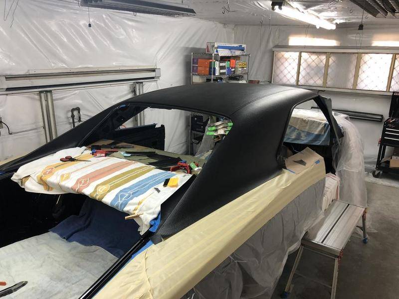

With the time it takes to install a vinyl roof, it makes you wonder how they did it so fast on a moving assembly line.

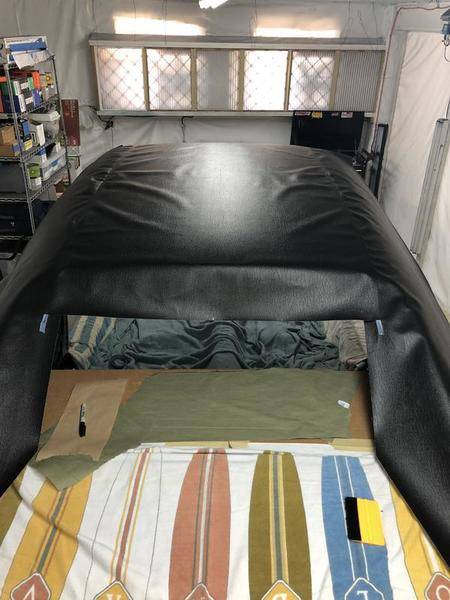

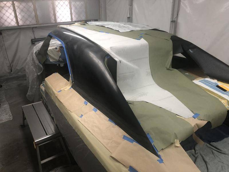

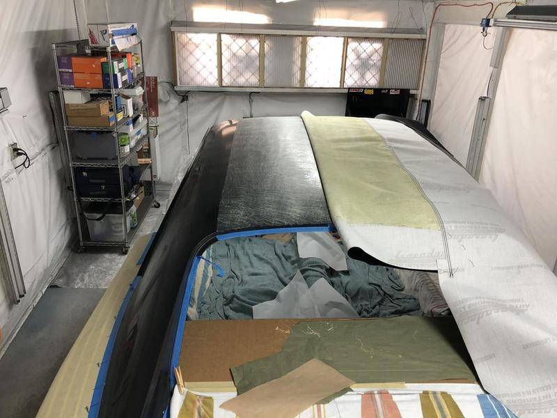

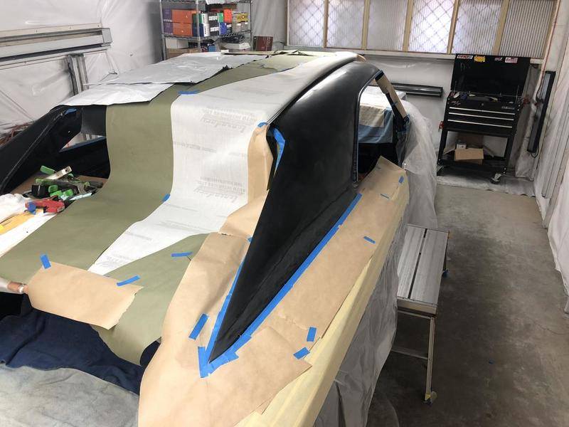

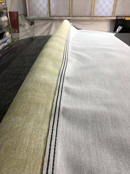

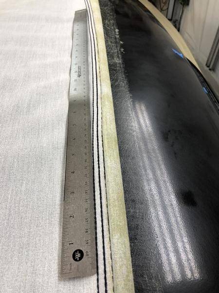

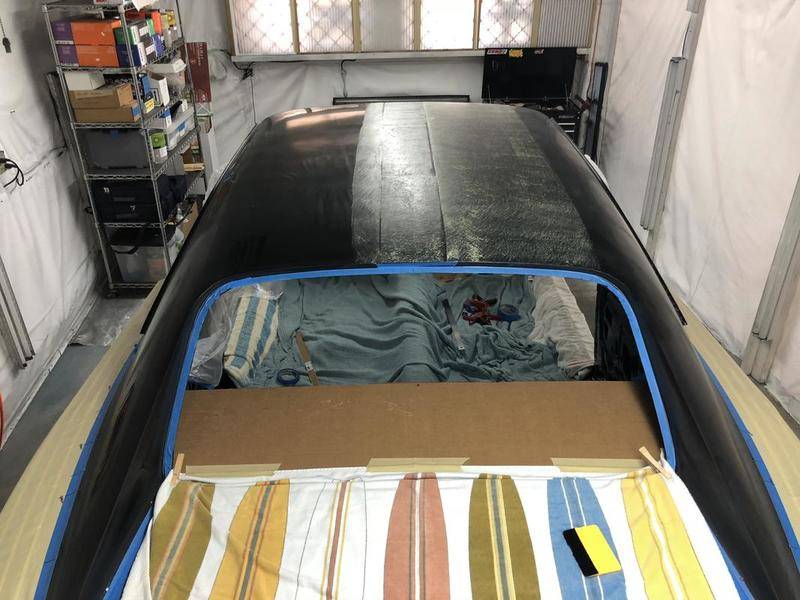

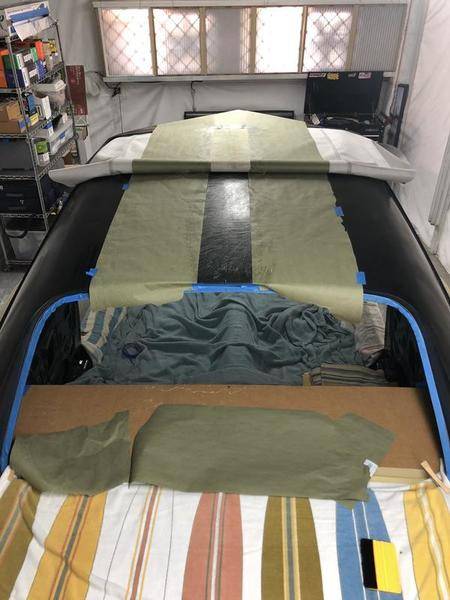

Had a setback on the vinyl top. There was a wrinkle on the driver side seam that I initially thought was from me over or under stretching the top when I glue that side down? But after investigating it a little closer it turned out the top was stitched crooked. I bought this top along with all of the interior components over 4 years ago from Legendary Auto Interior. I sent them pictures and a description of the problem and they quickly came back and said they would send me a new vinyl top. That’s first class customer service in my book! I was taught a long time ago by the guy I work for, don’t judge one by their mistakes but rather by their solutions!
Fortunately the top removed relatively easily and I was able to remove the contact cement by rubbing it with mineral spirits. I get to start over sometime next week when I receive the new top.

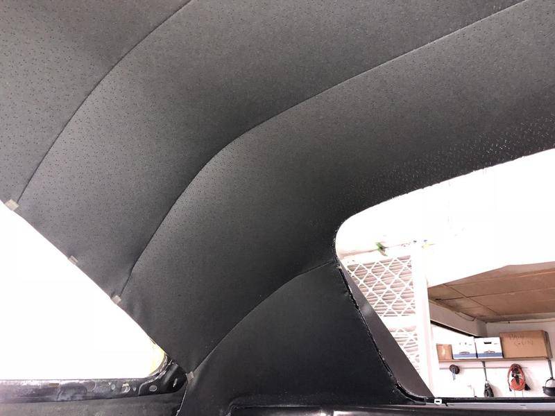

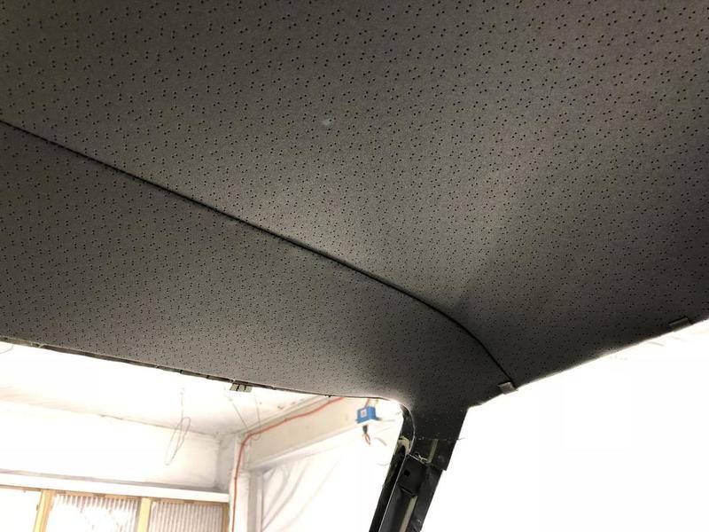

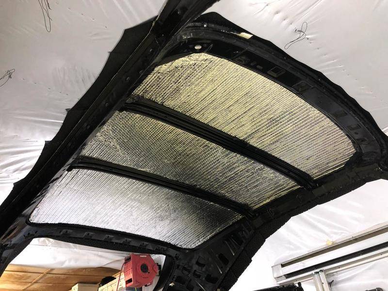

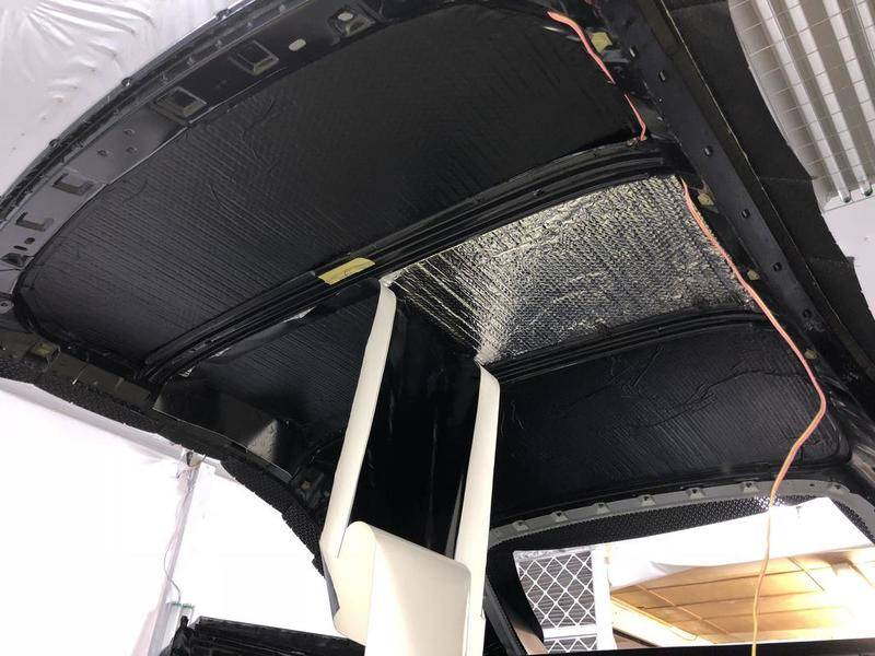

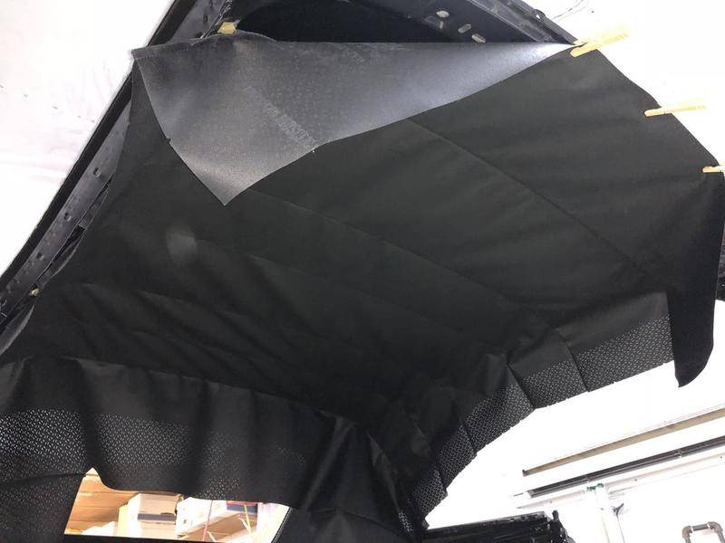

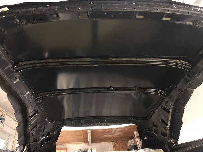

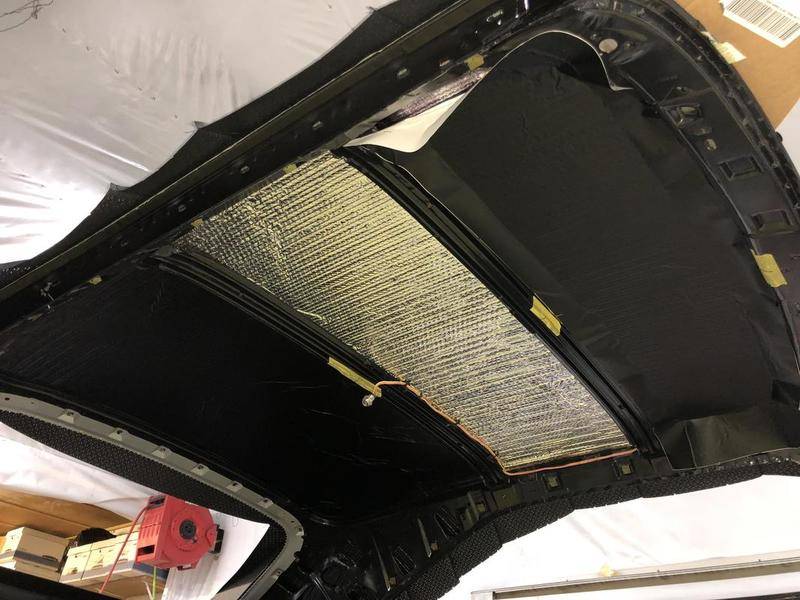

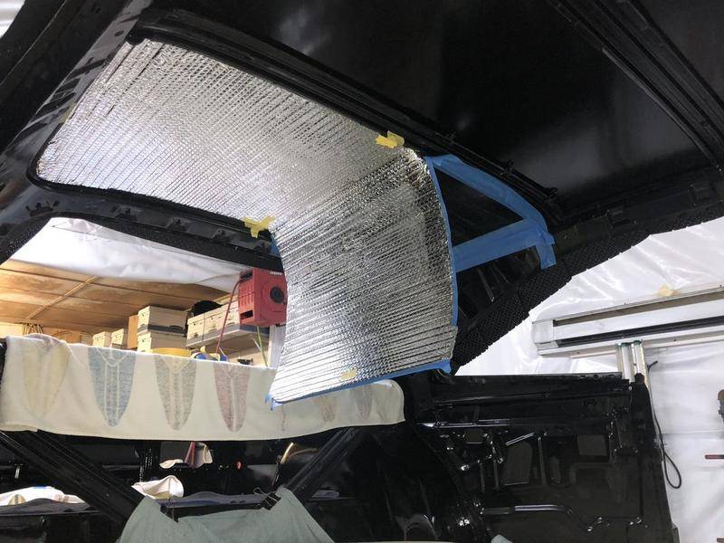

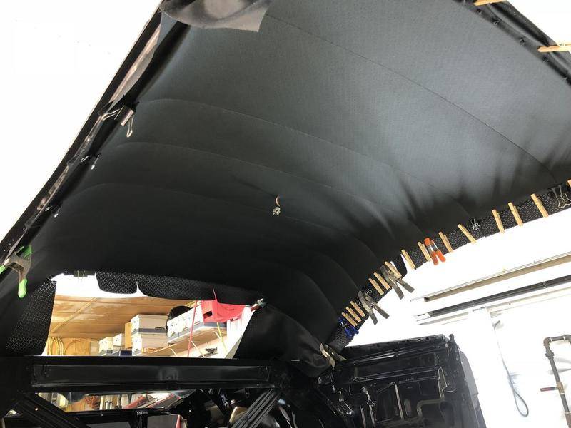

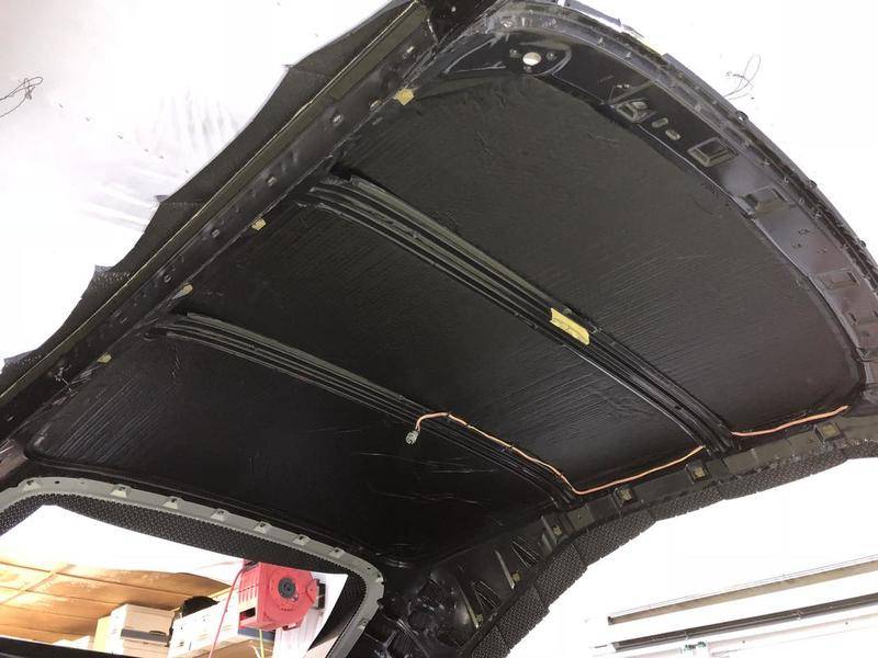

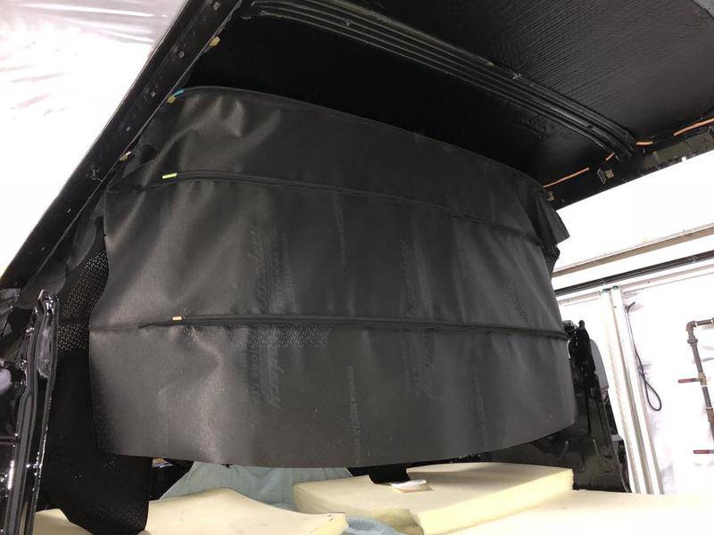

I used Matt black vinyl to cover the silver insulation (recommended by others) then started to install the new headliner. This is the fourth car I install the headliner on, and it seems to be getting a little easier ;-)
