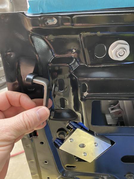

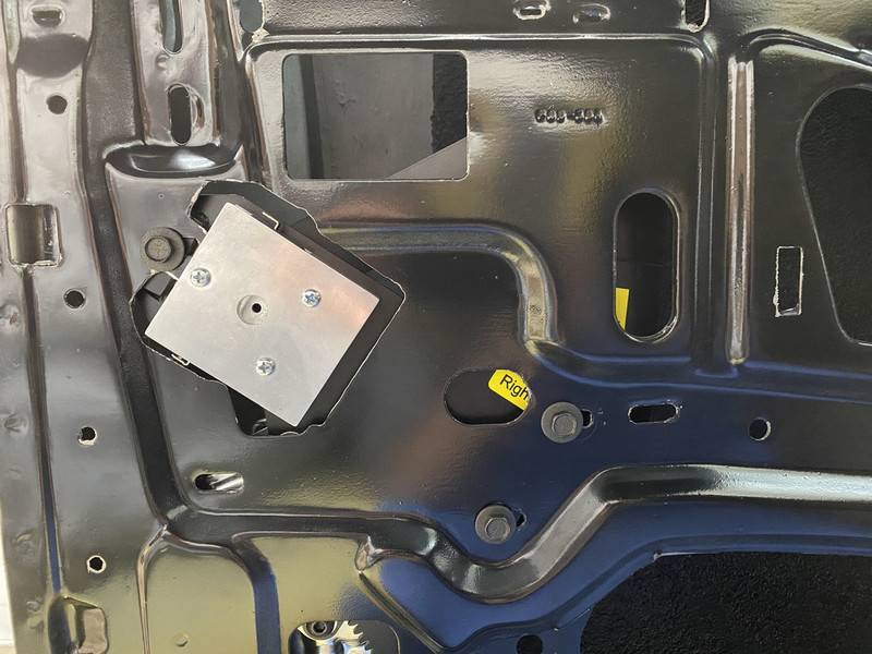

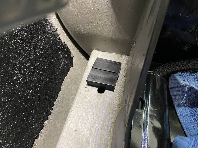

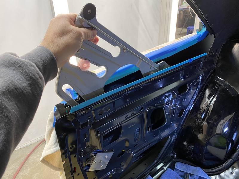

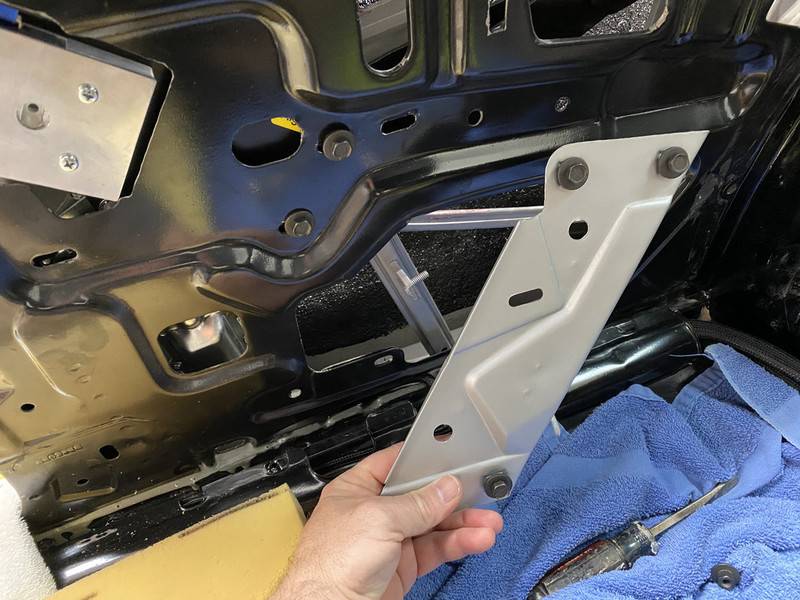

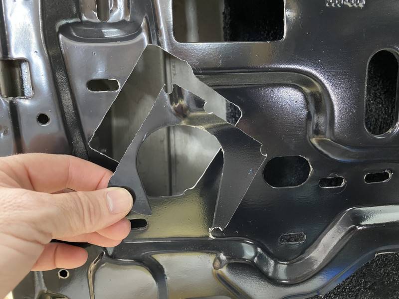

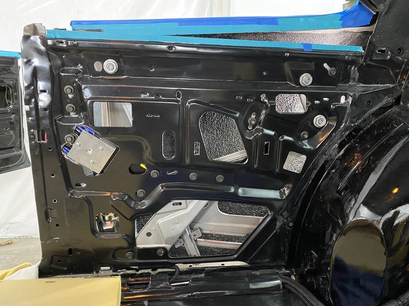

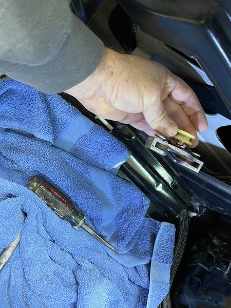

Installed the right side rear power regulator and like on the door I had to cut an opening to allow the crank handle switch.
This is a continuation of the first post, pictures are in order I installed the parts for the regulator. I missed taking a picture of sliding in the long track from the top that holds the two spring rollers.

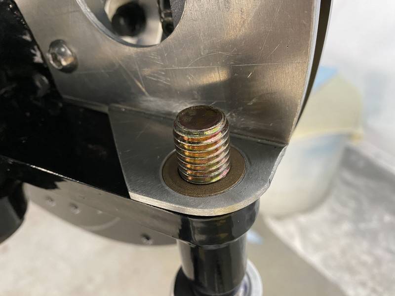

Pat, do you buy all of those bolts and fasteners, or are they restored/cleaned originals?
I use all the original hardware and fasteners. I cleaned and restored most of them as I removed them from the car 5 years ago.
Amazing! I've had very little luck on cleaning up those bolts and not losing the black phosphate (?) coating...yours look brand new.

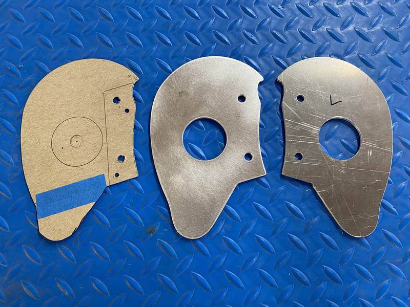

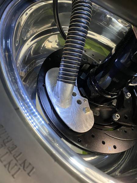

Now with the rear wheels on I could finish up the rear brake cooling ducts. I had made the air intakes and modified the Torque boxes before painting the bottom of the car 2+ years ago. But I did not have the rear installed at that time so I could fit the wheels to make the disk brake plates until this weekend.

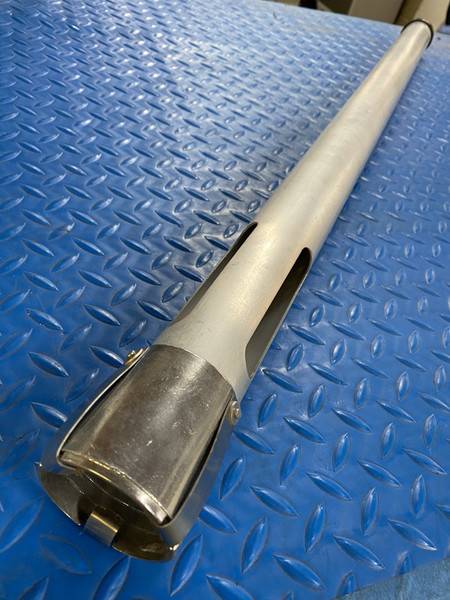

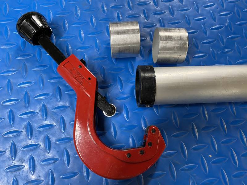

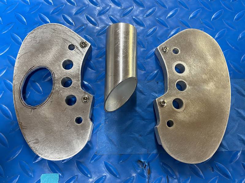

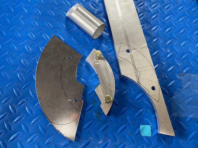

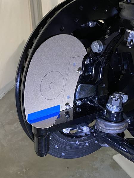

I fabricated the front caliper cooling vent this weekend. Had a hard time finding a piece of 2 inch OD aluminum tubing until I got into my son’s golf bag and found his golf ball picker-upper tube. Cut off about 3” and put the cap back on. He will never know that holds two less balls;-)

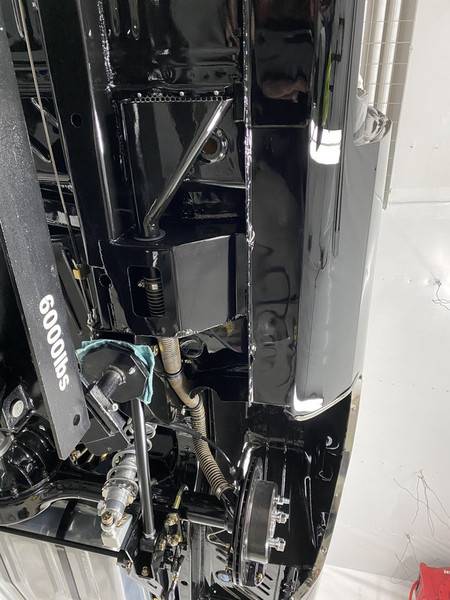

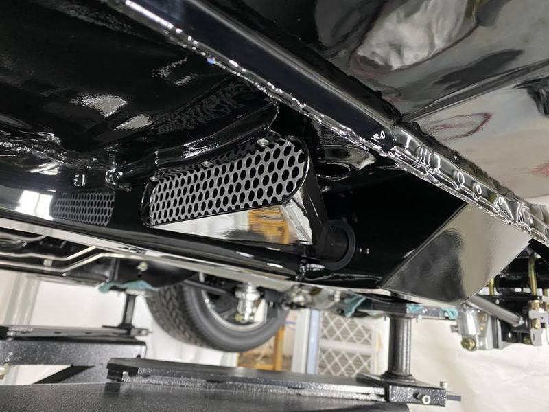

Rear brake coolers painted and installed. Still working on a few ideas for the air intake screen.
