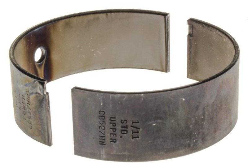

Assembling the lower end on my 440 and when I get to the rod bearings I discover 1 bearing has an oil hole. Where does it go? Rod side or cap side? I researched all afternoon. The only thing I could find is oil hole must point towards cam. WTF does that mean? It's 440 with LY rods, be gentle folks I feel like a dumbass.
Post a picture of the bearing? Seems odd that only one is like that. What brand bearings and part number.
CB-527HND Chrysler H series rod bearing STD
From 440 source, only 1/2 has an oil hole
Clevite 77
Look on the back of the bearing shell at the part number. If you see a "U" or "L" suffix, that represents upper & lower. If the rod has a groove in it and the cap does not, well then it goes in the rod. If both rod and cap have a groove in it, then it really doesn't matter, with the exception of the U/L explanation above. If I am not mistaken, the groove is usually in the cap though on OE rods.
As Pnora said, post a picture... Do they have anti-rotation lock tabs? I could be bearings designed to be pinned to prevent rotation..
When there was a hole to lube the cam it consisted of a semi circle on the edge of the bearing opposite the anti rotation notches
CB-527HND Google it looks like the hole is to the cap. Also looks like they are clearly marked upper and lower.
The tangs (tabs) you are referring to are for bearing shell location only. They do not prevent the bearing from spinning in the bore. Bearing "Crush" holds the bearing and prevents it from spinning.
Yes, that bearing with the "D" suffix is used when aftermarket rods have a dowel to hold the bearing in place and prevent it from spinning for racing applications, usually in aluminum rods I believe. It is not a hole for oiling. It has no use in your OE rod, and will not bother anything.
No groove at all just the cutouts for locking tangs
Yea, when you showed the pic, I knew which set you were talking about, and edited my post to refer to the dowel pin hole.

That is a dowel pin hole for use with aluminum doweled rods. It goes in the cap. It'll be fine in a steel non doweled rod.
