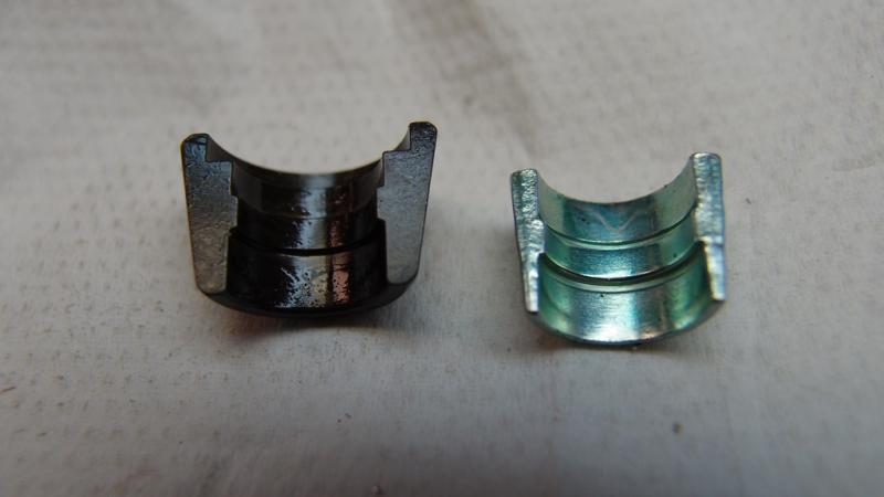

...I mentioned what the guy at MCH said because I'd been hearing online that the newer generation of Stealths came with Comp Cams hardware but then when you go on the 440Source website they still offer the Comp Cams hardware as an upgrade???
I recently bought Stealths and a sticker on the outside of the box says something like "These heads feature USA made spring locks by Compcams".
I chose anyway to upgrade to the 10 degree locks and corresponding retainers and there is a significant difference in the supplied locks versus the upgrade version. The supplied locks look really tiny compared to the upgrade version. I'm attaching a picture of them...I think you can figure out which is which...:grin: P2231889.jpg
