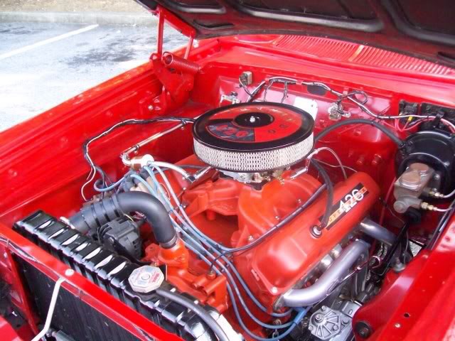

Here ya go, build a 440, put on any intake and heads you want, just spray em orange and install the 426 wedge stickers and be done. This one is courtesy of 383man, on of our members here.
