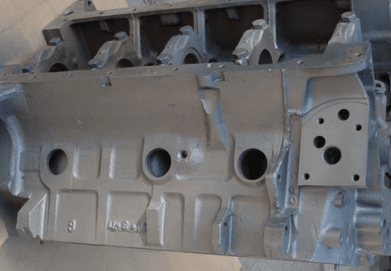

My RV 440 was a 75 block had 452 heads with a cast crank and LY rods. Not all RV engines had steel cranks. Pictures below show the extra coolant ports.Biggest differences that are found on motorhome 440 engines are a steel crank and six pack rods being used. Heads can also be different with more water passages. There is even a 452 head for RV's that have the small peanut type plug.
The engines built with the raised water pump are 361/413 engines and are very different up top above the short block.
These are what most refer to as "industrial" engines, and even they came with 3 different packages depending on the applicaton.

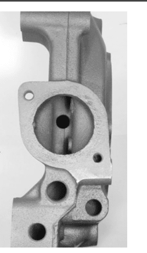

Some " Industrial/cold weather-truck" blocks 440-426-413 look like this..
Wow, that is quite abit of extra cooling ports! Your engine looks great. I am on the fence about painting it blue or orange.My RV 440 was a 75 block had 452 heads with a cast crank and LY rods. Not all RV engines had steel cranks. Pictures below show the extra coolant ports.

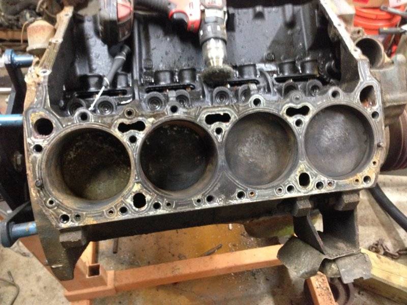

I used a 76 RV 440 in my coronet. 38k on it.The guy I got mine from had a video of it cranking over building 40+ psi of oil pressure. My intention is to change the pan, pull the valve covers, change the intake and carb. add headers, clean and paint it, and see if it will run ok for now.
