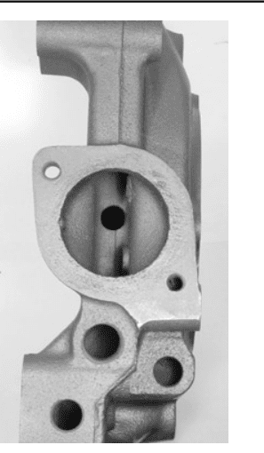

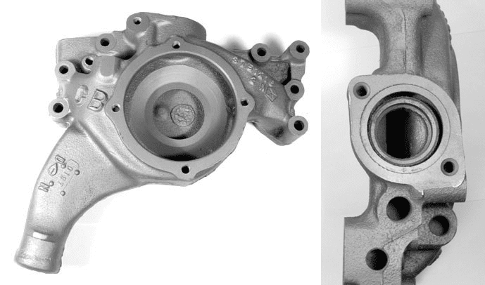

Another thing about that MH 440....the water pump looks like it empties out on the passenger side. These pumps have a huge sewer sized opening inside the casting for water flow compared to the car pumps which have a little pencil sized hole. So, if you can live with having difficulty getting a timing light on the marks because the WP outlet is blocking it then great cooling is the payoff. I have one on mine.

View attachment 1366983View attachment 1366984

In your first pix, Isn't that the suction inlet to the pump's impeller "eye" or how the impeller starts the coolant flow? The 2nd and 3rd pix are the thermostat bypass passage to allow for coolant recirculation when the
t-stat is closed; with the larger diameter for greater volume re-circulated for more even warm up......just my opinion of course...

Yes. The pictures are for ID purposes only....and to demonstrate the difference in coolant passage size inside the body.
