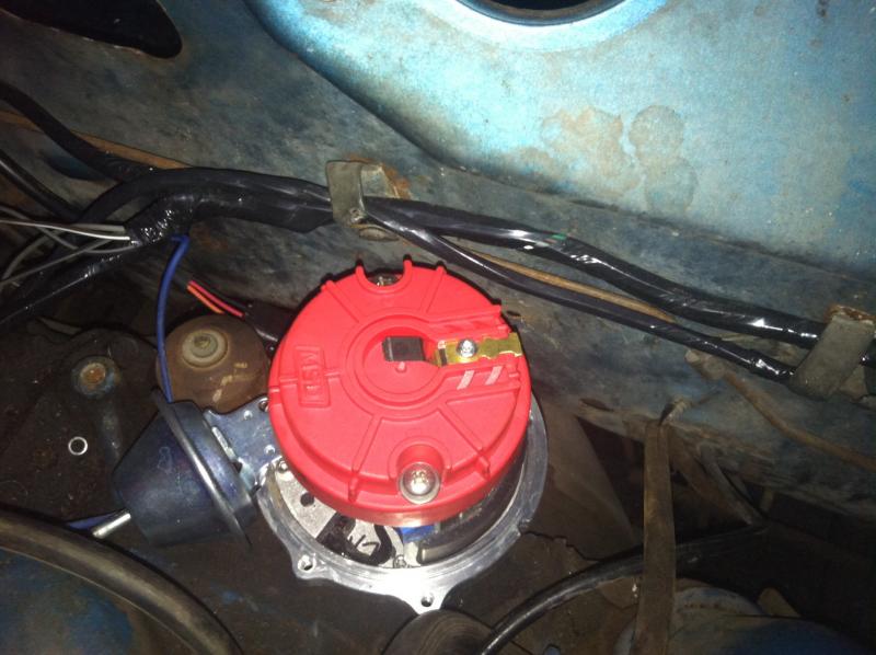

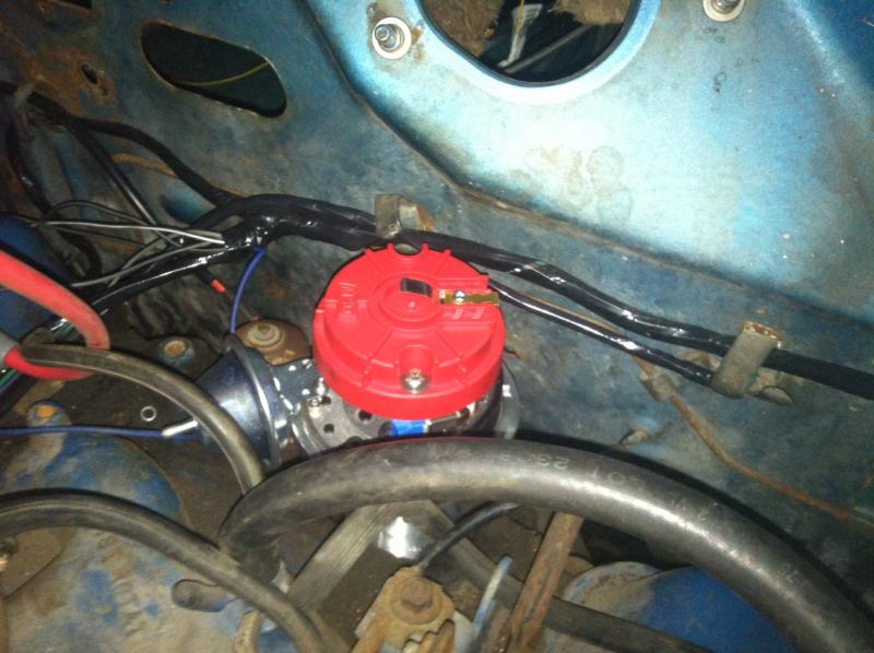

Any ideas on why this isn't pointing toward the number one cylinder at TDC. I have thought I was 180 out for the last 2 days now then I caught this. It's a 318 engine.

I don't think "pointing at #1 " is critical. What is critical is when #1 is at TDC, (on the compression stroke) you put number 1 wire where the rotor is pointing. Does it not run? Must be out a few teeth.
I believe you could just pull the distributor and re-install pointing at #1 if you really wanted to.
Pointing at #1 does not mean #1 cylinder. As above, it means #1 plug wire in the distributor cap. Pull #1 spark plug. Using a remote starter, tap the motor over a little at a time with your finger over the #1 plug hole in the head. When the compression tries to push your finger off the hole, stop. Look at your balancer. The timing mark should be approaching TDC on the timing tab. Tap the motor until the timing mark on the balancer is at or near 12* BTDC, then stop. Where ever the rotor is pointing is where you put the #1 plug wire on the cap. Adjust the distributor until the plug wire is directly over the rotor, then tighten the distributor hold down. Wire the cap clockwise (CW-small block), 1-8-4-3-6-5-7-2. If everything else is right, it will start.
This is the down and dirty way to get the motor started. You can finesse the location of the #1 wire later if you're a purist.
Good luck.
Ok, I will check tdc again when i get off and let you guys know how it goes from there.
Not much I can add to what Colorado said except he's right, do as he said and you should be in there.

I will add make sure you do as Colorado.. mentioned in bumping the motor over til you feel the pressure on 1, Balancers can slip and TDC mark can be off. So don't just go by that. Make sure you know by feel where TDC is and then check balancer mark making sure it is at zero.. Good luck
