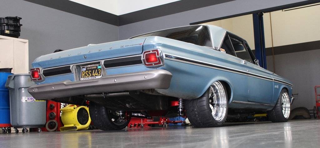

My 1965 Road Racing Belvedere II

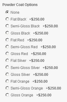

Did Moser powder coat the diff for you? When I talked to a Moser rep at an NHRA event, they said they don't do powder coating anymore. I ended up going with a Strange S60.

Thanks. I'm surprised someone told you that, they offer the powder coating in several colors. Red is a bit of a standout, but I kinda like the contrast and it's their signature color so I figured 'why not' on this one.

I have yet to take it to the track to see, but I can say this: the car handles phenominally well now. I took a turn with a 20 mph suggested speed at about 45 and it felt solid and tight. I didn't get the car completed in time for our last outing to Willow, but I'll find a track day soon and bring it up there.

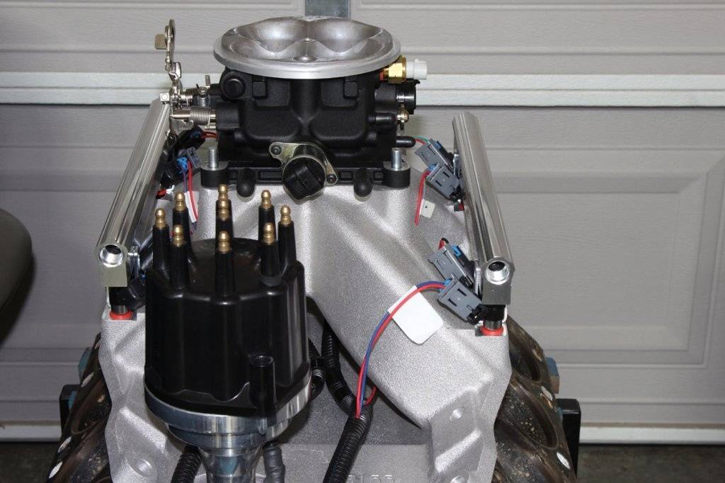

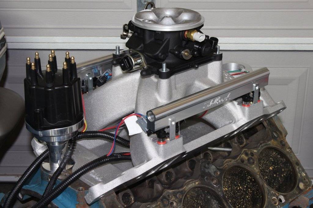

Now that the suspension is in the car and I've been able to put some miles on it and make some adjustments, that leaves one more modification that I need to make: I need more power, this ~325hp Poly isn't cutting it. I'm collecting parts and have my block at the machine shop, and have a borrowed block for mock up.
I'm going with a FAST XFI port fuel injection on a stroker Mopar small block, with Magnum heads and a Super Victor LA intake (we're drilling the heads for the LA) and will run a COMP cam and Scat rotating assy with custom JE Pistons. And there are some other goodies that I can't talk about right now. ;)

View attachment 421437 View attachment 421438
Kool Beans!
