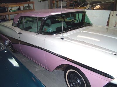

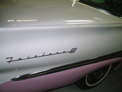

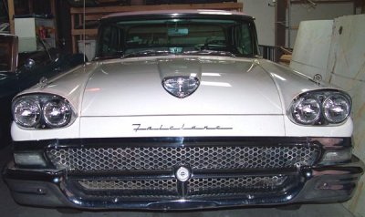

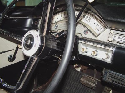

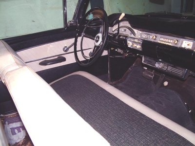

I got a little distracted this weekend when I found a near mint all original 1958 Ford Fairlane 500 Skyliner retractable sitting in a storage shed for the last 21 years. This car has the original break shoes on it! A true barn find that people dream about! I have been so excited. 100% garaged for its entire life, 66k miles, original mint condition interior, original powder pink and snow white paint that still looks good.
I spent the entire weekend with a mechanic buddy re-assembling the car and fixing all sorts of mechanical problems and yesterday, on day 3, I managed to drive it out of there just like she drove in 21 years ago. I gave her a bath when I got home. Its not a Mopar, but man what a stunning car.
Is that appropriate on a bbody forum? Anyway, here you go. I am still smiling.

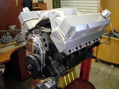

Here is a photo of the engine so far:
This is a '73 440 block stripped to the bone and rebuilt to be capable of about 400-450 hp depending on where I take it from here. Everything inside is top of the line. All the stock parts are gone. The only stock parts are the block, crank and main caps. It is a mild street build so I can drive it. I am sad to see it sitting, but so far it seems to be very patient.

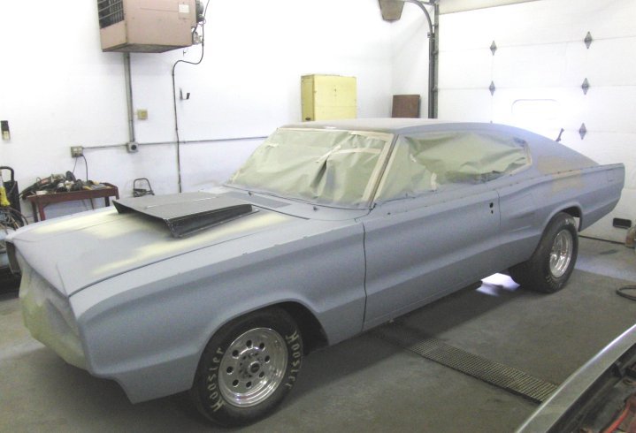

Keep up the good work. Here is my 67 with a few mods. Trim shaved, hood scoop slicks etc.

do you have a close up shot of the top of the door leading back? It looks like you shaved the trim lip and welded it shut. We are doing that real soon and it would be nice to see how it looks done.
