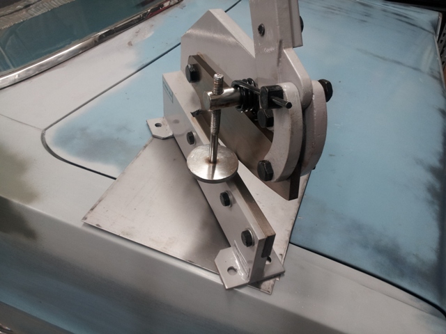

Picked up a new tool at the Charlotte Auto Fair . .
While attending the Auto Fair, I picked up this new tool to help me with my rebuilding . . .
So far, it seems to be a great help . . . 10" throat-less shear . . .

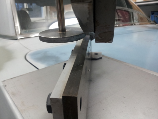

And a closeup of the blade . . .
Hope it helps . . .

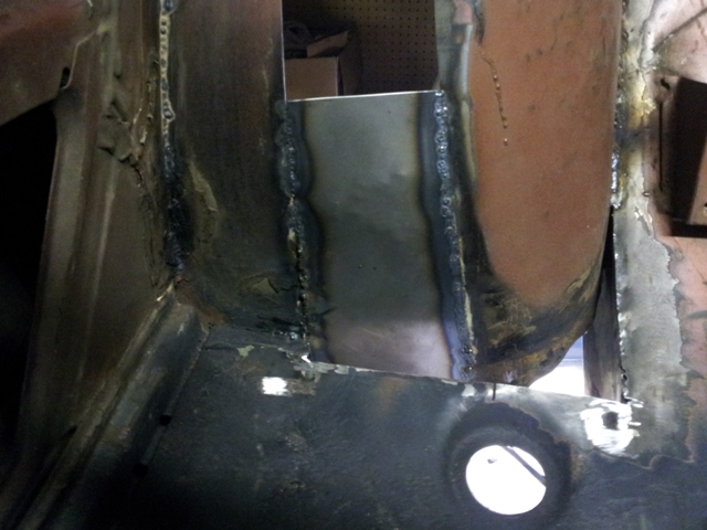

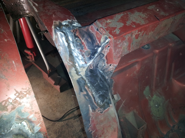

Spent most of the night, last night, working on the outside-inner fender . . . and some time tonight, working on setting up the inside-inner fender.
Wondering how much room, all this extra effort, is going to gain me for tire size.
The front of the mini-tub wheel well . . .
And the back of the wheel well . . .

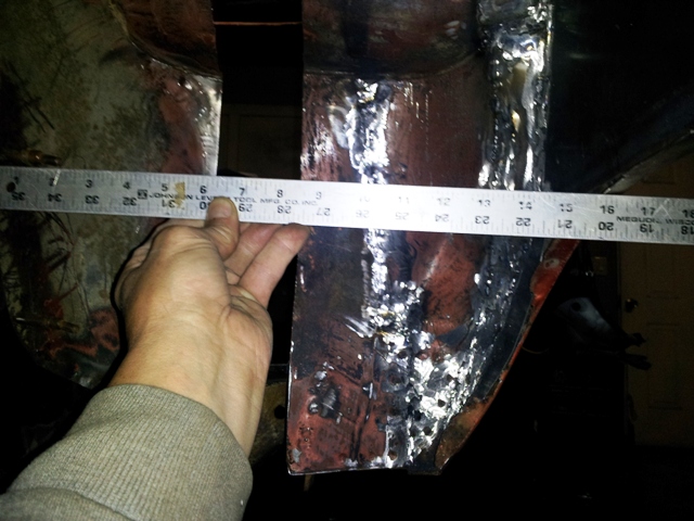

And a measurement - looks like a 15" wide tire might fit with no concerns ? ? ?

The wheel wells are looking great - what size rubber are you putting in there?
As far as the wire size, I started out using .030. When the kid started coming over he switched it over to .024 and used that for everything. I guess it is just a personal preference thing.
Hey H2E . . . not sure what I'm going to do yet, but I'm wanting to get the "deep dish" look, so I'm planning ahead . . .

Working on my obsession . . .

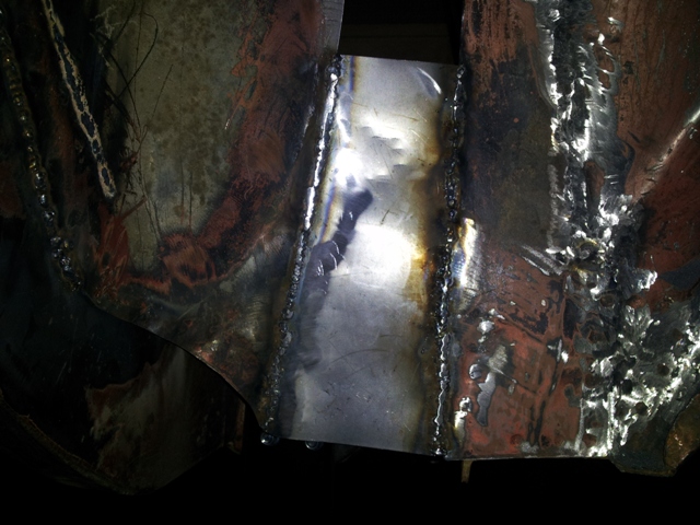

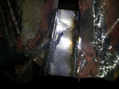

Got a chance to spend some more time in the shop tonight and get a chance to work with the .024 wire - had some good success with the welding tonight and made some progress on the reattachment on the inner wheel well.
got the top of the wheel well re-welded in place - and I'm pretty happy with the results . . .
Credit for the "obsession" goes to Propwash - who used that phrase in a PM communication that we had and I felt that is was OH SO FITTING . . .
Propwash and H2E - Thanks for your contribution and input on the different welding wire sizes - and with the welding that i did tonight gave me a little better understanding of what you meant - I can see how the smaller wire reacted differently then the thicker wire. But I'll need some more time with the .024 to see how it goes ( BTW - I've got a 10# spool loaded up so I'll get plenty of practice ).
The wheel wells are looking good and spacious khan! 15" is room for some serious tires haha gonna be one mean machine!
Thanks Speedy - don't know that I'll be going that big . . . but it's good to know that I "can" go that big if I so decide to ! ! ( smile ) . . .
Nice progress Kahn, glad to see you back in the tub.................that didn't come out right "sorry". I would love to see 15"s in there, the 10's I just got which are actually 11" on the outside look pretty big under there let alone 15". Question, are you planning on narrowing the axle to get that look? I like the .032-.035 myself but think the absolute most important thing is a good hood with the right lens where you can see clearly. If I could have afforded it I would have used a triangulated four link for the rear hmmmmmmmmmmm. Looking good
I think he is correct. To get that look you want with a deep wheel you will have to pull the wheel mounting flange inward a few inches.
Those welds look really good. I can see how much you've improved!

Yes KB67 . . . I do have plans on narrowing the rear end on the car to help me achieve my "deep dish" look . . .
Not sure what wheel diameter you plan on going w/...I'm planning on 18s...and the only 28"ish tire I can find is a 295/45 that's somewhat affordable. Also, not sure how much you plan on lowering yours, or the exact config of your inner wheelwell, but mine measured closer to 13 3/4" or so at the concaved portion of the quarter.
If I had it to do over again, I would've done a true minitub and not tried to conserve the stock sheetmetal/look since I've decided to hack up my trunk anyway.

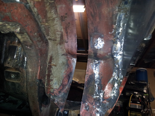

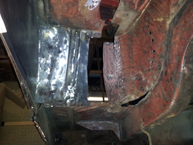

The beginning of filling in the gap for my mini tubs - from inside the wheel well . . .
And the view from inside the car . . .
Seems to be going pretty well so far . . . now to go put some medicine in my eye . . . Grrrrrrrrrrrr . . .
