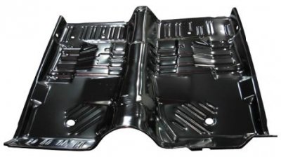

get the floor pans(halves) from amd,that's where i got mine.Don't try and patch one spot and keep another area you think is good.it is alot faster and less work to replace the left/right half,same with the rear floor pans.
so should i reuse my tunnel and get the 2 halfs..or just get the one peice with tunnel and all? my tunnels fine but could be more work ..i wasnt sure how to get one peice in its pretty big...u ever order from amd? hows there shipping..i read it 125 for truck freight

heres half pans..

Alot of members have gotten their parts from amd and they were happy with them.I got my pan halves from auto body specialties.I think if you order the floor pans in halves and the rear floor pans,they should be able to put everything in one box and maybe save you a little bit on shpg.If you do get the one pice floor,it IS a two man job to put it in.If you get the half pans, then you want to make sure you don't trim/cut too much off your tunnel.Which ever way you go,just make sure you have your car supported and level.Are you still thinking of the body shop to do the work or having your dad help you?
Give Jeff a call @ 521 Restorations. He's a great guy and gives some nice discounts to FBBO members. I think a full floor pan would be the best for your car.
