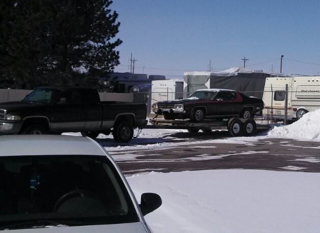

Brought her home to school in -20* weather

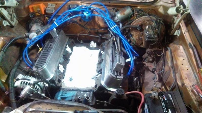

So far I've replaced/put on the ICM, Starter Relay, Distributor, a MSD Blaster Coil, Summit Performance plug wires, spark plugs, alternator, Valve Cover Gaskets, Intake Gasket, dropped the T-stat to 180*, went through the engine harness, fuel tank, sending unit, and installed new locks on the doors.
Also re-did the rear brakes...
Took her on her first "long" drive. She died on me on the way out to my buddy's house (air in fuel system) and then a second time on the way back to the dorms, where I live. The last time is how I found that the ammeter did in fact work and i wasn't even charging the battery. Ended up getting towed back the last mile. At least I found out I still had a problem (mostly because I got lazy and didn't double check stuff. I just want to drive her lol).

I'd do the 318 thing except putting it up on the trailer again revealed a few problems with the frame alignment. The passenger side is pushed up about .5" (car was hit on that side. Knew it when I bought, but at the time it didn't look like it bent the frame) It's a good thing I have a cousin that's in the auto body industry. Just to find the money to get the whole thing done in one shot body wise.
