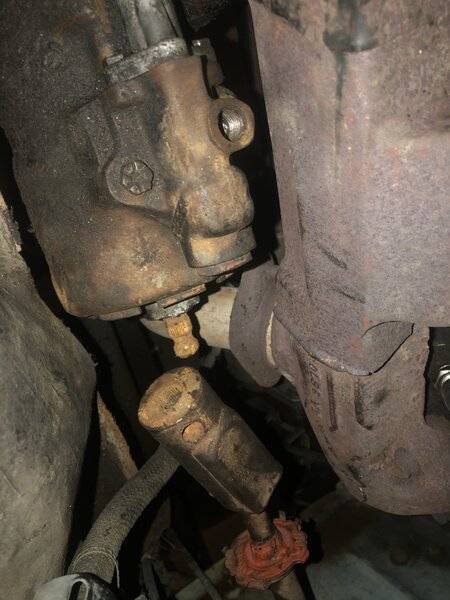

Well, the removal and replacement of the steering box has begun.
Here it is, with the lines removed, and the pin that holds the steering shaft to the coupler bashed out - this was simple.

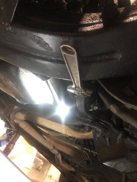

Next was the daunting task of removing the huge nut on the bottom of the pitman arm, which is very large and of course, I didn't have the right sized socket....one just too small, and one just too big of course.
Now humor me for a second, due to the excessive oil leaks under here, the pitman arm and the nut were saturated, so therefor pre-soaked in some form of lube, right??...so I thought I would just try an adjustable wrench...just for a laugh...
It broke free!! Would you believe it? I did put a bar on the end of the wrench but it didn't take much!
So then I had to remove the pitman arm from the splines of the steering box output shaft....same principle applied, its been oily for ages so...
A good couple of hits downwards...
It moved!! It actually started to free itself, as you can sort of see here...
But alas, that's as far as I got. It wouldn't budge any more, no matter how medievil I got with the hammer. So progress stopped after an hour, and I need to go rent a puller.
Watch this space.
Happy New Year Gary, thanks for the update. :thumbsup:
Glad to see you at it, giving the old iron hell.
Yep, definitely a puller - which some of the big box auto parts stores will let you borrow
free of charge, by the way.
If you haven't done so already, keep the steering perfectly centered to make things easier to go back together. I forget if the pitman arm is splined to only go on one way, but either way if you keep everything centered it will be easier to get it all back together straight. Before you put the remanufactured unit back in, turn it lock to lock and count the turns, then center that too before you put it in.
Good luck!
Hawk

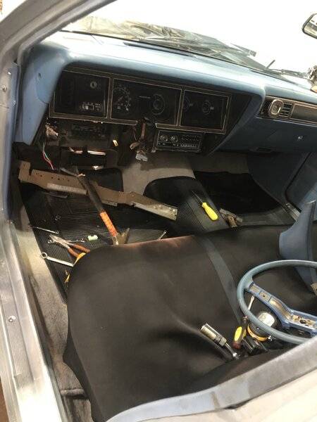

Next, a diabolical hour or so, pulling the steering column out of the engine compartment a little, which meant undoing all the bits and bobs under the dash. I particularly enjoyed the bit where my back ruptured due to excessive stretching into silly shapes to reach the bolts...
Because I had already removed the pin holding the coupler to the steering box, a little tug on the steering wheel, and the assembly should let go of the box, right? No, it was a bear. I had to use a pickle fork to separate the box and coupler...
But it let go eventually.

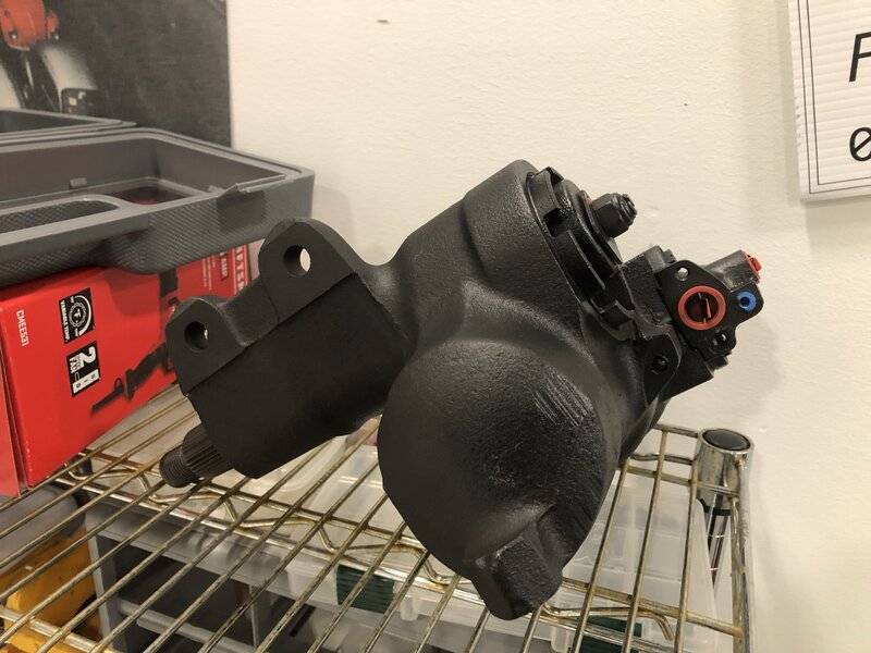

I had my jack under the car to "catch" the steering box as I moved it around from above. I should be so lucky...it would have been magic had the steering box fallen out the bottom of the car. Instead, much wriggling and swearing ensued, hitting the exhaust manifold, the mounting bracket, trying not to hit brake lines and spark plug wires...and then, like some metal baby born to a mechanical midwife, it came free in my hands!!!!

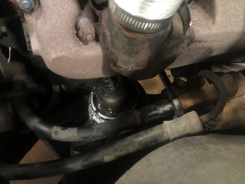

This valve assembly needed to be transferred from the old box to the new. I checked the inner seals and they were all very nice, so I went ahead and bolted it up...
And in went the new box - it went back in easier than the old one came out. No swearing, no injuries.
I'm going to replace the return line with a new piece of hose, but at this point I was very happy with how this had gone. Yes, it's not something I want to do again, by any means, but I figured it out with the help of you guys, so very pleased, I was.

I took the steering wheel off, to see if I could see more...and I'm not afraid to admit my stupidity, that while the wheel was off, I used a vice grip to turn the steering column which chewed up a few of the splines, and now the steering wheel won't go back on again - but I used a magnifying glass to see, and I know I can use a needle-file to rectify my silly mistake.
But still the column was super tight. I asked around. Some of you guys chimed in on my "steering box woes" thread on another part of this forum and I'm grateful for that. But no matter how much I hoped looking at it would fix the issue, I knew, the column had to come out.
Dang it.
Yeah, tell me about it.
To get the column out, was a complete 'mare. The shifter linkage was the worst culprit, and I had to come at it from many angles to get it to detach from the plate on the column. I actually had to destroy the grommet that holds it in. So now I am nervous I won't be able to find a replacement.
After generally being annoyed, the shifter coupling let go and the column came out, and I placed it on the bench.
I immediately turned the column, with my fingers.....buttery smooth and free.
WTF?????
