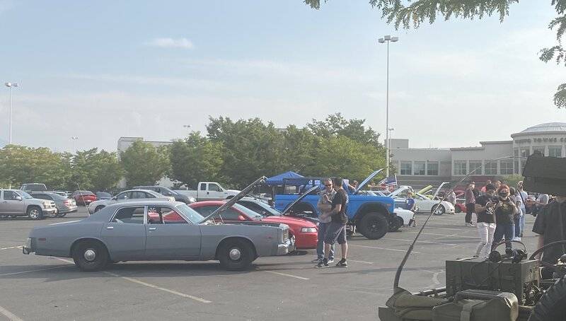

This weekend, as with all the weekends over the last three months, was brutally hot. I've never experienced Utah being this hot, in 9 years of living here. We braved a car show in the morning, which was hot but great. We then braved another that evening which made wifey almost pass out, so we sat her in the Mall to cool down then I took her home. Car ran great all day though.
Here I am talking to the only guy who knew what it was.
