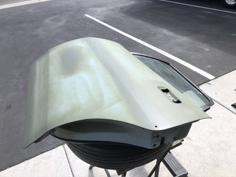

There is an annoying "parking lot ding" on the rear passenger door, too big to ignore. The six bolts on the bottom half of the B pillar there, unscrewed really easily and I was able to get the door off by myself no problem.
Then I got to work with the hammer and dolly. I've been watching a million videos and reading and listening and I applied all of what I learned to bring the dent out of the door, and I was incredibly pleased with myself. Whether I can do it again on the five million other dents on the car, remains to be seen.
The trim holes need to be welded up and filler applied - right on that body line damn it.

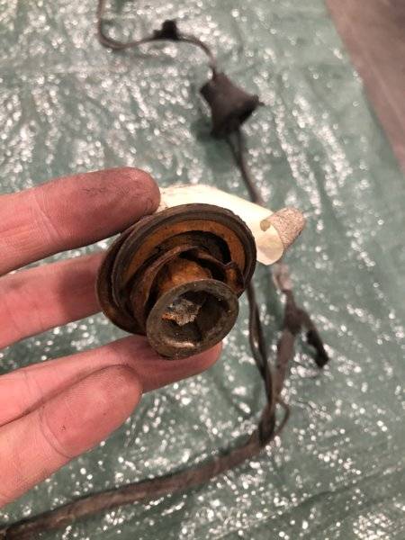

I stayed at the shop after hours this evening, to finish off that rear tail light wiring loom. I bought two bulb holders and a load of bulbs, but all the parts stores in my area were out of more of them, so I have to wait for four more bulb holders (arriving tomorrow).
These are the current ones...
And these are the two new ones I soldered in...
They turn 90 into the back of the lenses and fit perfectly.
I used 3M Electrical insulation tape and bound the entire loom, which now looks brand new (Weirdly, 95% of this little tail light loom sits unprotected between the bumper and the trunk lip, so the probability of it being wet/hot/filthy/all of the above, is high. I figured I would wrap the loom in new and good electrical tape to give it another good run at life).
