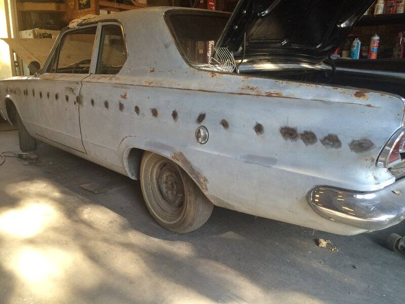

Great work. Without a welder, a lot of these tasks are almost impossible. I've bought and fixed up cars with multiple dent puller holes, trim holes, emblem holes...If I filled them all with Bondo, they'd eventually pop out.
THIS car had almost 70 holes to fill between outer body trim, dent puller and emblem holes including several in the engine bay.

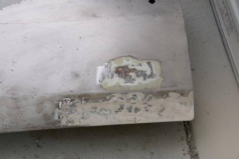

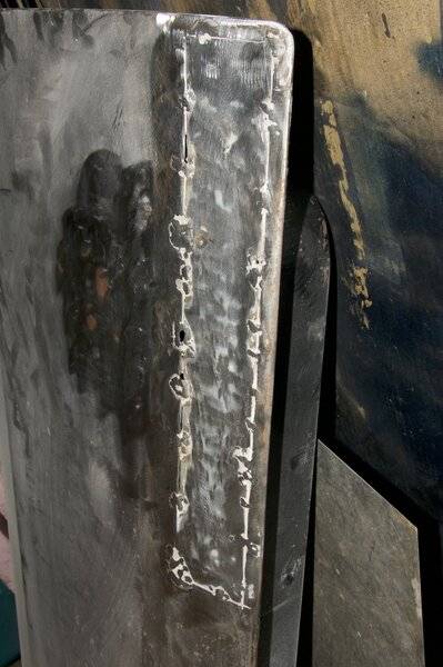

That looks like a great job! Welding sheet metal is something that a lot of people don't want to or can't do. I sanded bondo off of this door to find a really piss poor patch panel. I'm probably going to have to cut it out and redo the whole thing. The tacks are lousy and the backside of the patch are even worse.
Oooof ! That is ugly.
If you notice, they didn't even put a bead between the tacks...the fit up is terrible which is maybe why they didn't weld it but it's a lousy job and with a pile of bondo over it and paint, no one would know.

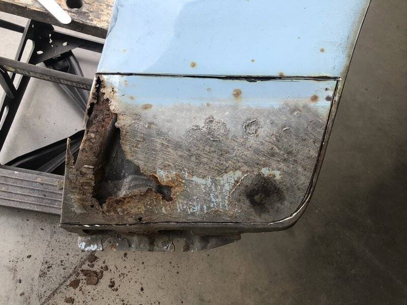

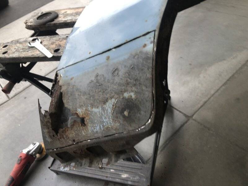

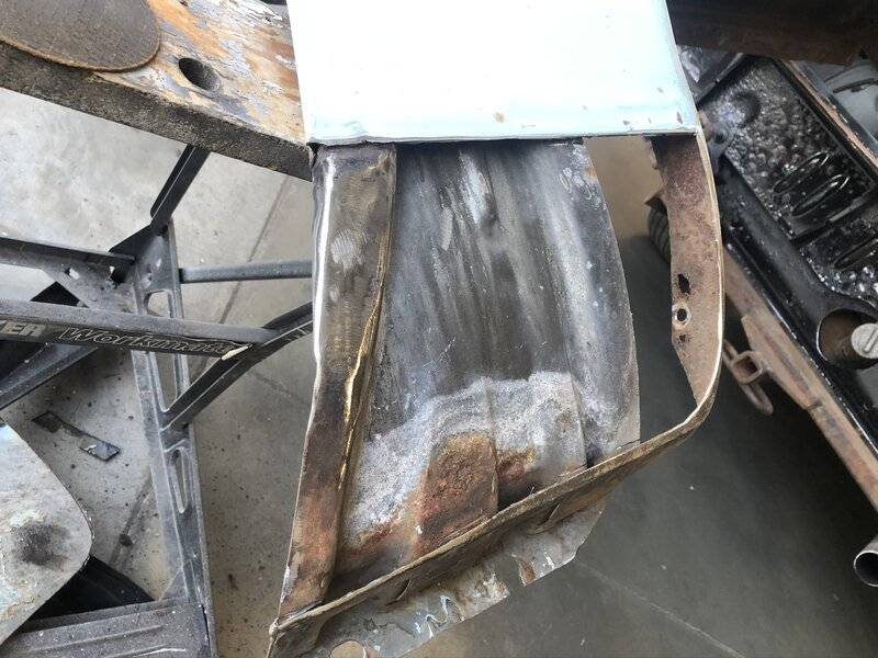

Today, Monday 18th May, I have been slammed with work. All day, non stop renderings and preparation, so that's good. I did, however, stay behind after hours this evening and just do "something" to this fender.
First, I cut the rusty lower trailing edge out..

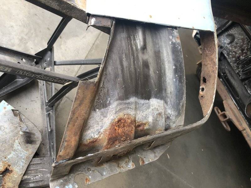

It was pretty rotten in there. The rear support had rusted away too, so I cut that out and made a new bit for it...
And welded it in.
It'll never be seen so I don't care too much about it not looking that good. That's all I have time for so I have to go. Maybe tomorrow evening I can get the big piece cut and welded in, that would be good. For now, adios! Have a good evening.
