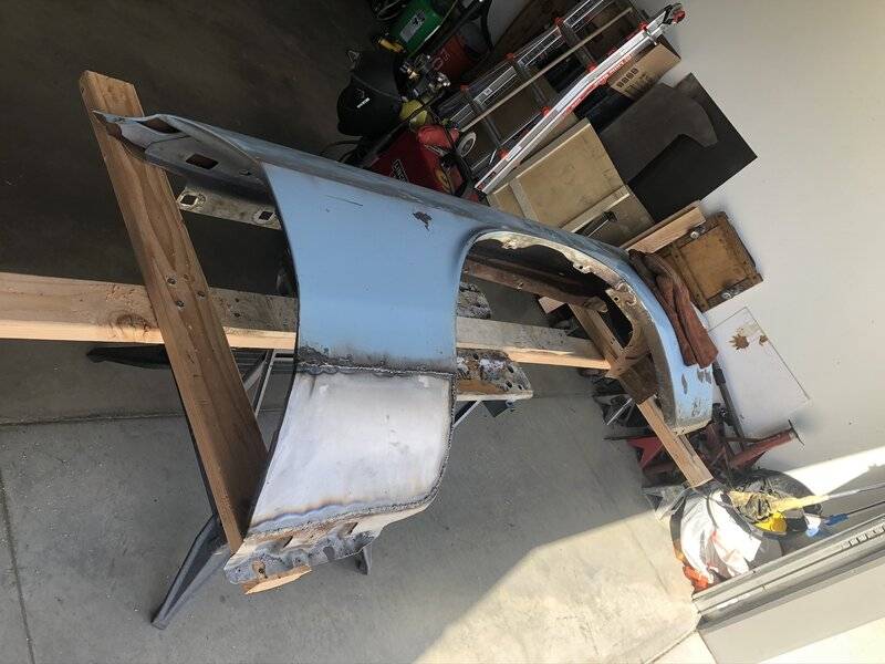

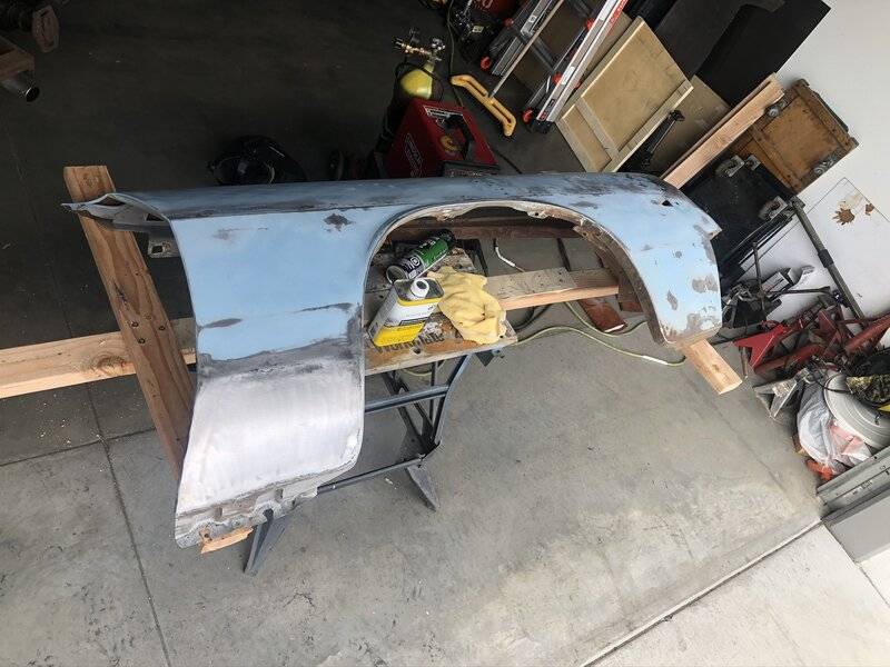

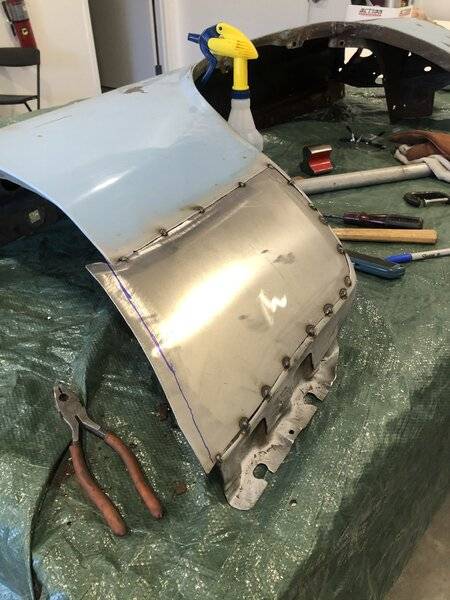

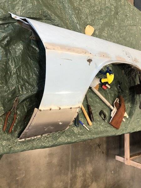

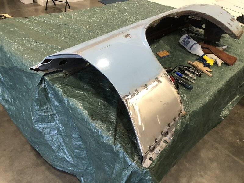

It's been dead this week. Very nerve racking actually. End of today, Tuesday 2nd June I did a bit more to that fender.
Went round and stitch welded the rest of the repair panel.
I'm actually very happy with the curve I achieved on this...
Spent a lot of time grinding her down to shape...
I had a couple of pin holes to fill with JB, and then I hit it with hi-zinc primer.
I spent some time with the hammer and dolly on the rest of the fender. I poured denatured alcohol over the fender and for about 30 seconds (before it evaporates) I get a nice glossy look so identifying my high and low spots are way easier. It's a bit of a waste of denatured to be fair but I'd be a donkey of the highest magnitude if I poured water on the fender after all this work :-D
Next will be filler. But the scale of the filler and prep work ahead of me definitely kicked in today. But as you guys say, every little helps.

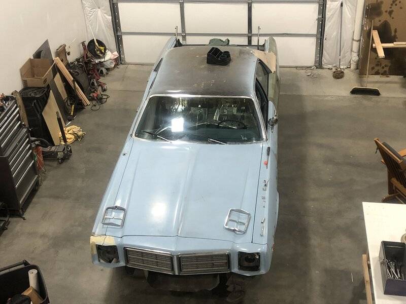

So the most important next stages of the car involve welding, cutting, grinding and painting....all of which I absolutely won't do when we have to sleep at the shop. So progress has been limited. I started to stick the nose cone back together and slowly bolt the car back together a bit.
Glue and clamps, for now. As a base for fiberglass work this will give me a great guide.

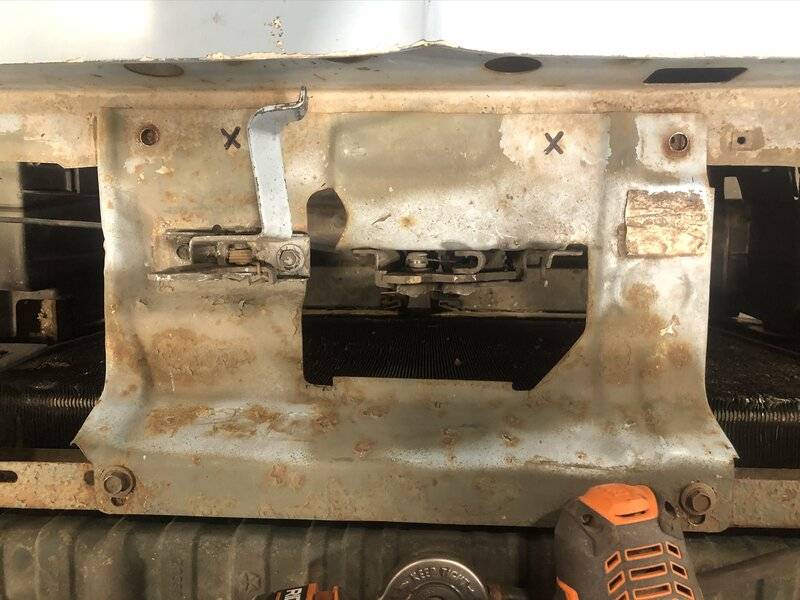

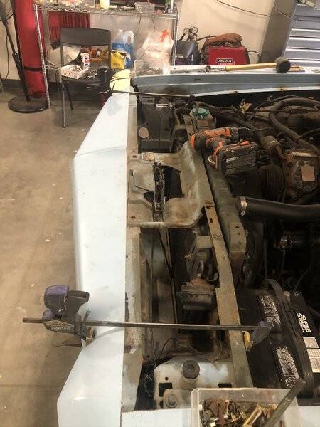

The nose section went back on but for the life of me I couldn't line it up close to both fenders. I clamped the whole thing tight using the radiator support to bring everything in line...
And X marks the spot where I drilled and bolted the nose section support to the hood latch area, which closed the gap.

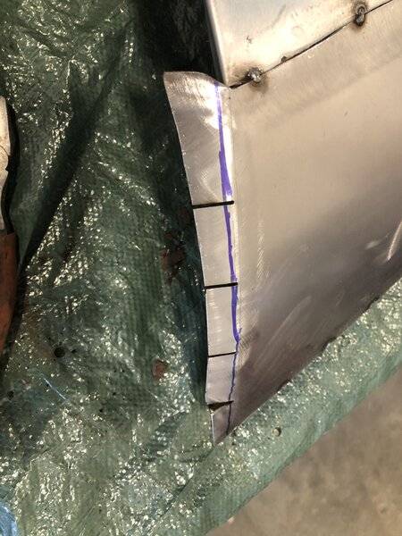

Hello guys. It's been a minute. Business has been pretty good, and I've not had time for the car. Today was Memorial Day (Monday) and after a busy day with the lady riding bikes and fixing up her yard, we went to the shop and did a little bit of this...

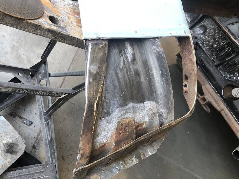

This rancid old fender from the other week...
Once the new bit was kinda in, I did the usual scribe, bend, notch, grind, pretend I know what I'm doing...
View attachment 955346 View attachment 955344 View attachment 955347
Still a lot of welding left on this patch panel but I was very pleased with the contour that I bent using my hands and a floor jack handle (rolled the metal over it with my weight on it to get the curve). I'm thinking this car will get some more love this week so watch this space.

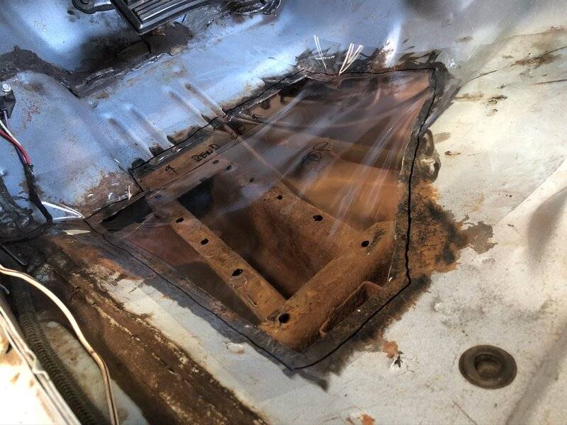

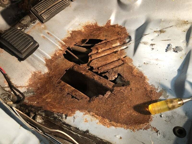

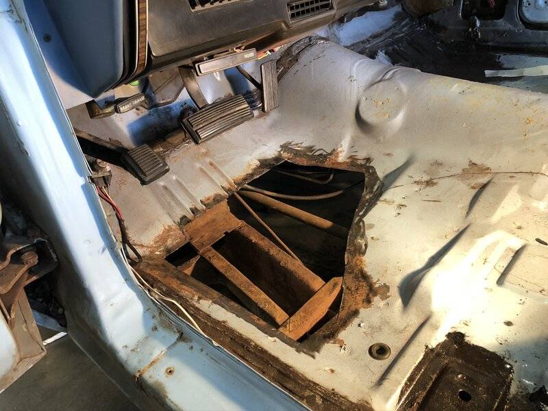

Today, Monday 29th June sees me with an hour spare. So I thought I would tackle the work that's holding me up with the interior, and it's this despicable hole in the drivers footwell...
You know what's next.... I tried to keep dust and crap and danger to a minimum by using my tin snips...
But they were about as much use as a chicken flavored flower pot. So I donned a mask and some eye wear and very carefully (there's the ebrake cables and the speedometer cable right there, not to mention the frame) cut it out as evenly as I could...

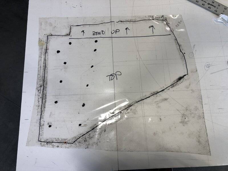

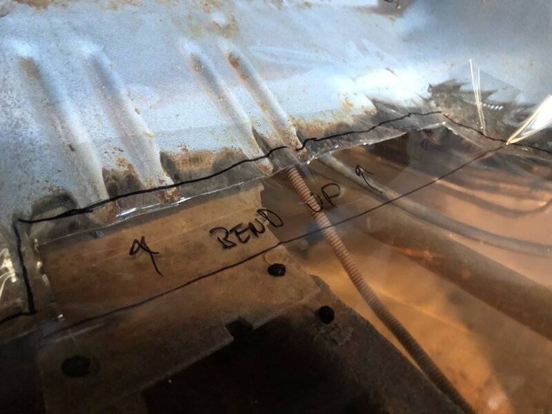

Next, I used one of my hacks to make a template for the piece to be welded in. This time, I used some cheap-*** clear laminate I have. You can just about see it in this pic below, I gently covered the hole without stretching it...
Then I was able to draw around the hole, oversized, and mark where I want to plug weld this sucker.
...and also mark roughly where the bend needs to start.
I carefully peeled it away and here on the table top you can see how effective this hack is for making templates.
