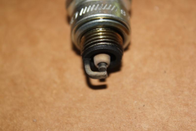

I've been trying to read as much as possible... pulled all my plugs last night for a baseline reading... of course these plugs have been in for a while, but according to this article, it looks like I have too much timing going on....
http://www.4secondsflat.com/Spark_plug_reading.html
This is a representative pic of what most of the plugs look like.
